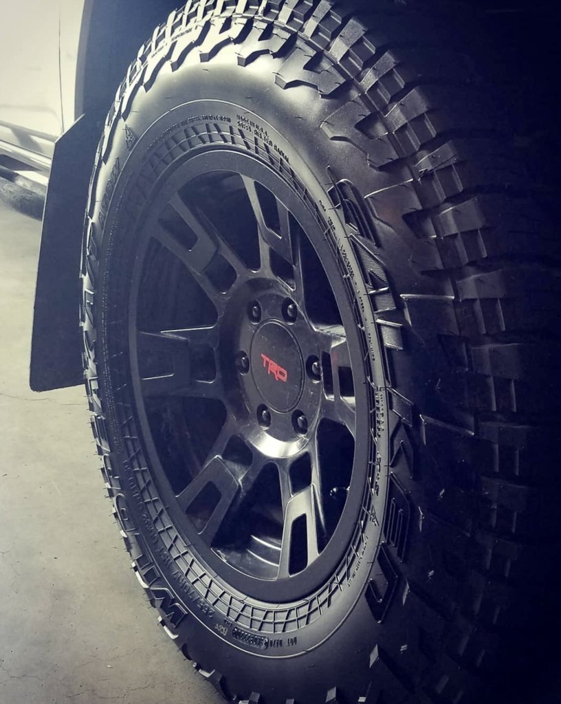

    These fit (matte black, matte grey, gloss grey or bronze versions)
    PTR20-35110-BK (black)
    https://www.tacomaworld.com/threads/17-trd-pro-sema-wheels.366951/
    The other versions you're thinking of, the Tacoma's hub diameter is too large for the oem versions. There's aftermarket versions that do fit. AGP makes some...
    https://agpwheels.com/products/17x8-agp-pro-black
