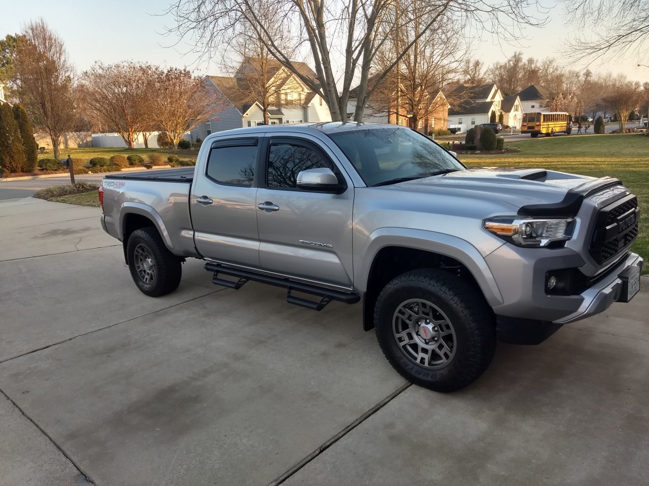

    Bilsteins 5100s on the top setting, 4runner Gray TRD Pro Sema wheels, 285/70/17 Toyo AT3s, Sumo Bump stops, TRD exhaust, ECGS Clamshell bushing, 1/4 shim for the lean and one inch rear block, OEM Pro grill and garnish OEM TRD Skid plate, TRD CAI, Demon Brackets, Rigid Industries Pro fog lights, OEM Trail Rails sidebars, Diode Dynamics LED SL1 high and low beam lights, OEM Roof racks, Clazzio leather heated seats, Remote Start, TRD Pro shift knob, tinted windows, Rockford Fosgate 4 channel amp for the headunit and sub and amp combo, OEM Puddle lights, OEM tailgate lock, OEM bed mat, LED interior lights, OEM blackout kit for letters, JLT catch can, upgraded 27F toyota True Start battery, Vleds led tail light kit with Pro tail lights, OEM Rave4 side mirrors with convex spotters,just to name a few mods.
    Same setup as you. 265/70/17 Toyo open country at2 SL tires on TRD pro Sema wheels. Bilstein shocks set on 4th perch and a one inch block. Don't mix the shocks, the 5100s on my stock coils and alignment is perfect. No rubbing anywhere. The ride is awesome. Trust me you will love it.IMG_20190208_074039293_HDR.jpg

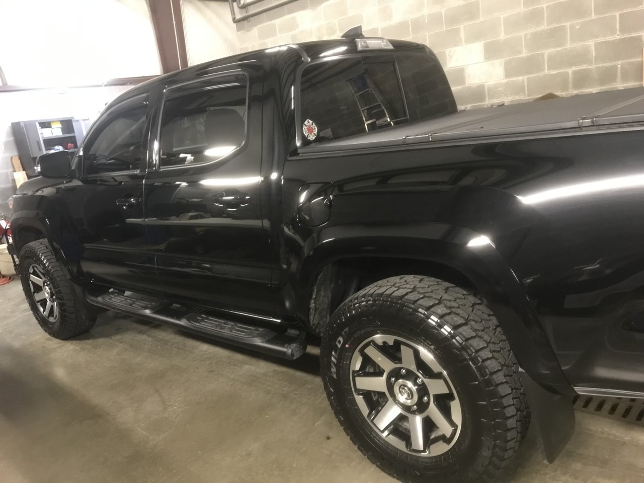

    I don’t know the difference in specs between the SEMA’s and the T4R off road premium wheels that I have. I also added spidertrax spacers which I think put me at a total of -6 offset. On factory suspension I rub. I heated and flattened the flaps and rub occasionally when reversing at 3/4 lock. I’m lifting real soon and alignment so hopefully I’ll be totally rub free but then.
    My wheels:
