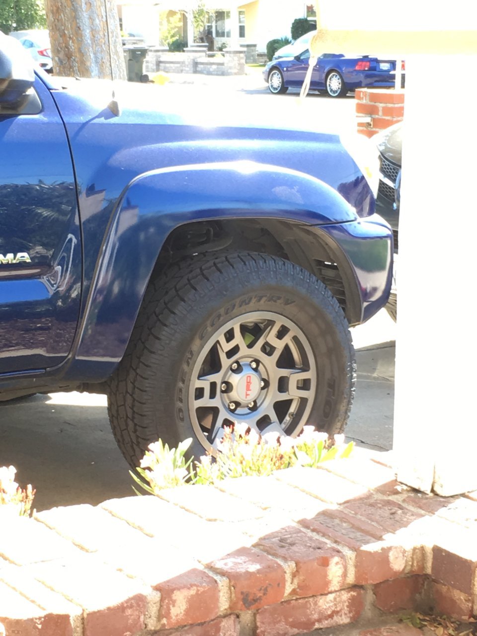

    Everyone relax. Remove all mud guards (front and back) and you’ll be fine. All stock here with new 265/70-17 open country’s.
    Sorry for the crappy picture. Didn’t want to get my arse up!
    TD90S and Lt. Dangle like this.

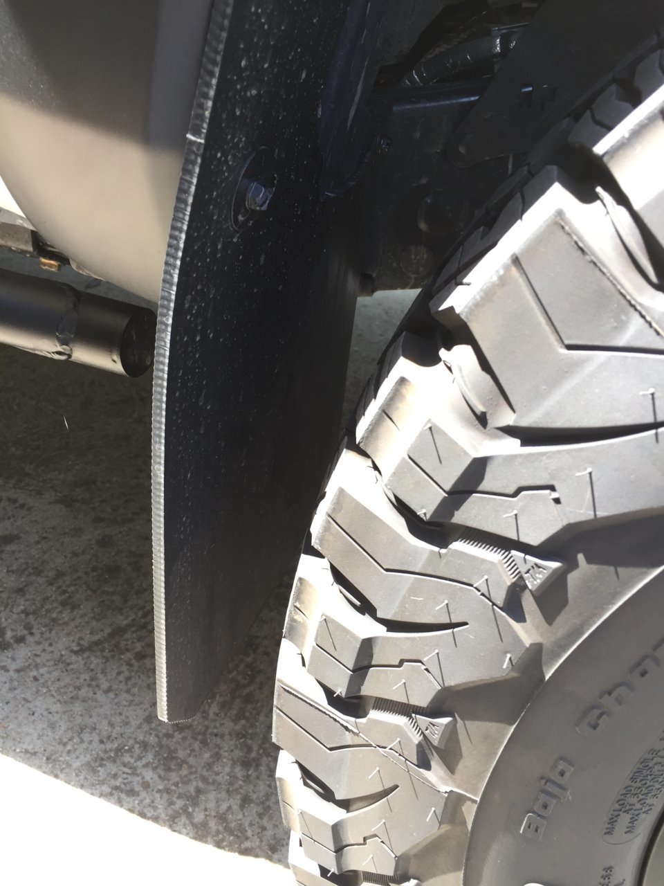

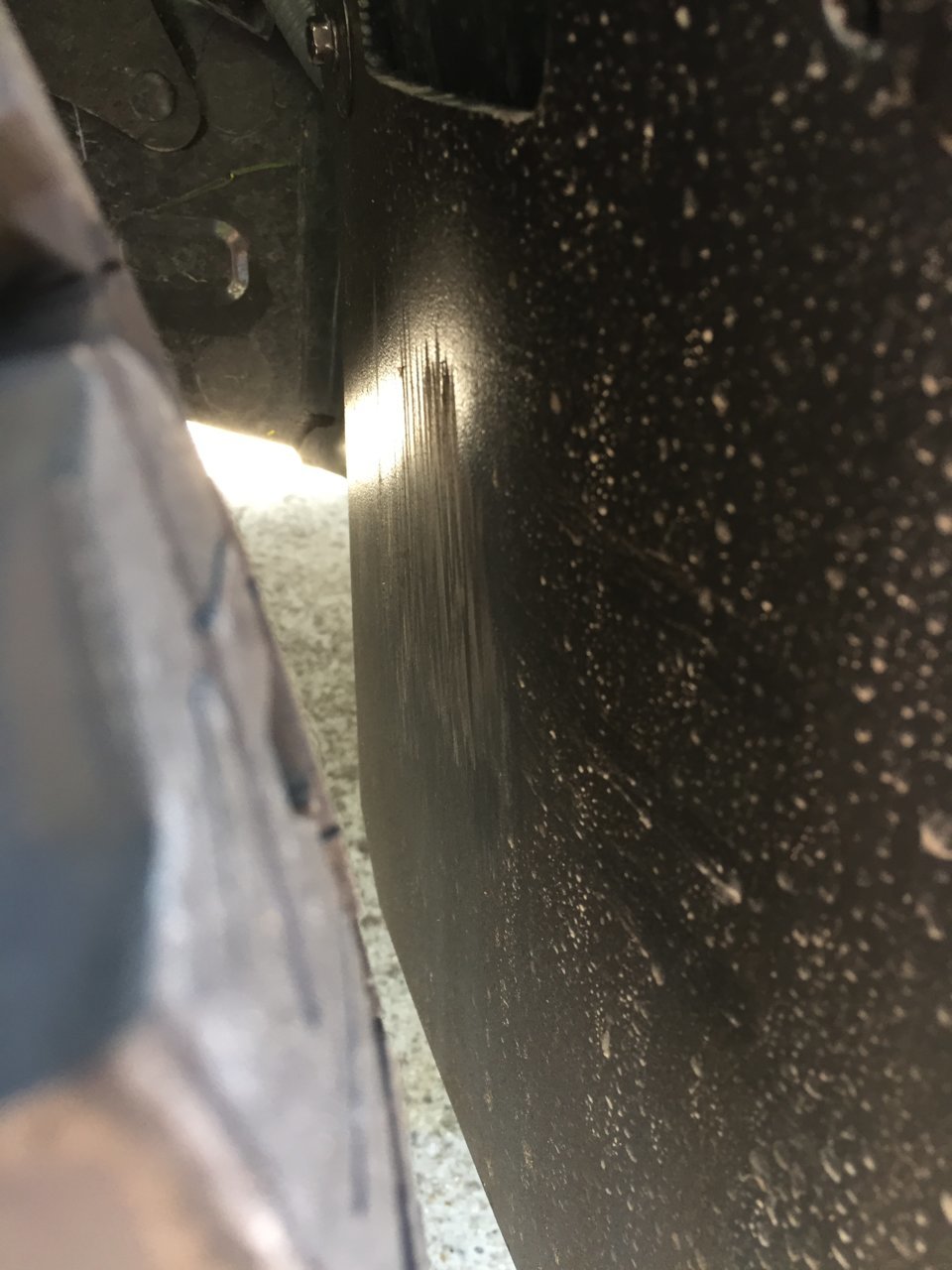

    It's the flaps. I just lifted my truck 2-2.5" (Bilstein 6112...) then added a slightly larger tire than you have 275/70/17 KO2's on SEMAs. No rubbing at that point. Then, I installed Rekgen flaps and now I have rubbing.
    These flaps have a very flat profile in the fender (I've been wondering myself if a more contoured flap might have more clearance in the fender) so I may live with it because the rubbing is almost not noticeable. Passengers never know. This could actually be due to the fact that the flaps are so smooth/flat so there is no edge for tread block to catch on. No card in the spokes sound.
    Here's a before flap and after flap rubbing pics.
