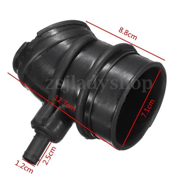

    Another idea: Has any one used the elbow right off throttle body for the older 4Runner 3.4v6?
    http://www.ebay.com/itm/Air-Cleaner...b4ee3a4&pid=100005&rk=4&rkt=6&sd=121769561435 $17.00

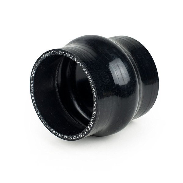

    Combined with a 3inch pipe and a hump coupler at factory airbox.
    https://www.amazon.com/Squirrelly-S...2309&sr=1-9&keywords=3+inch+hump+hose+coupler
    $10.00

    I am still selling it. OEM, from the dealership and still wrapped in plastic.
    However, my part number is different from the one you're looking at on ebay. It's the 17882-62020. The only difference from what I can tell is the output size of the hole for the vacuum hose that comes in on the side. Requires a larger nipple insert.
