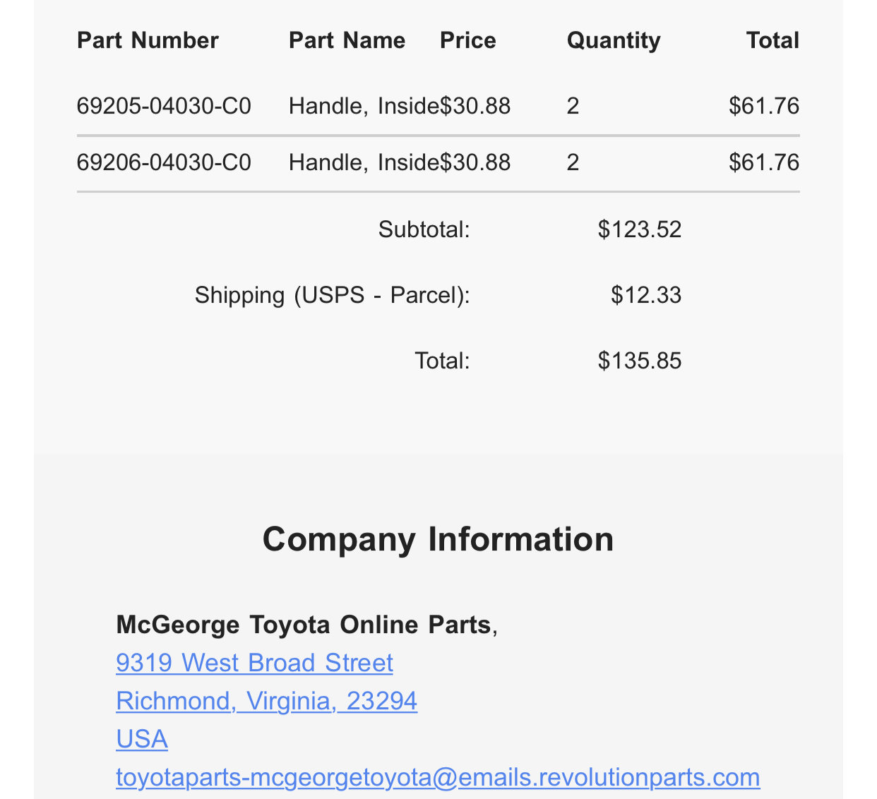

    Curious about how difficult the swap is as well. How much are they from the dealer?

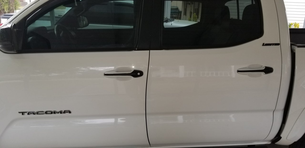

    I dipped mine.

    He's talking about the internal one. Inside the cab.

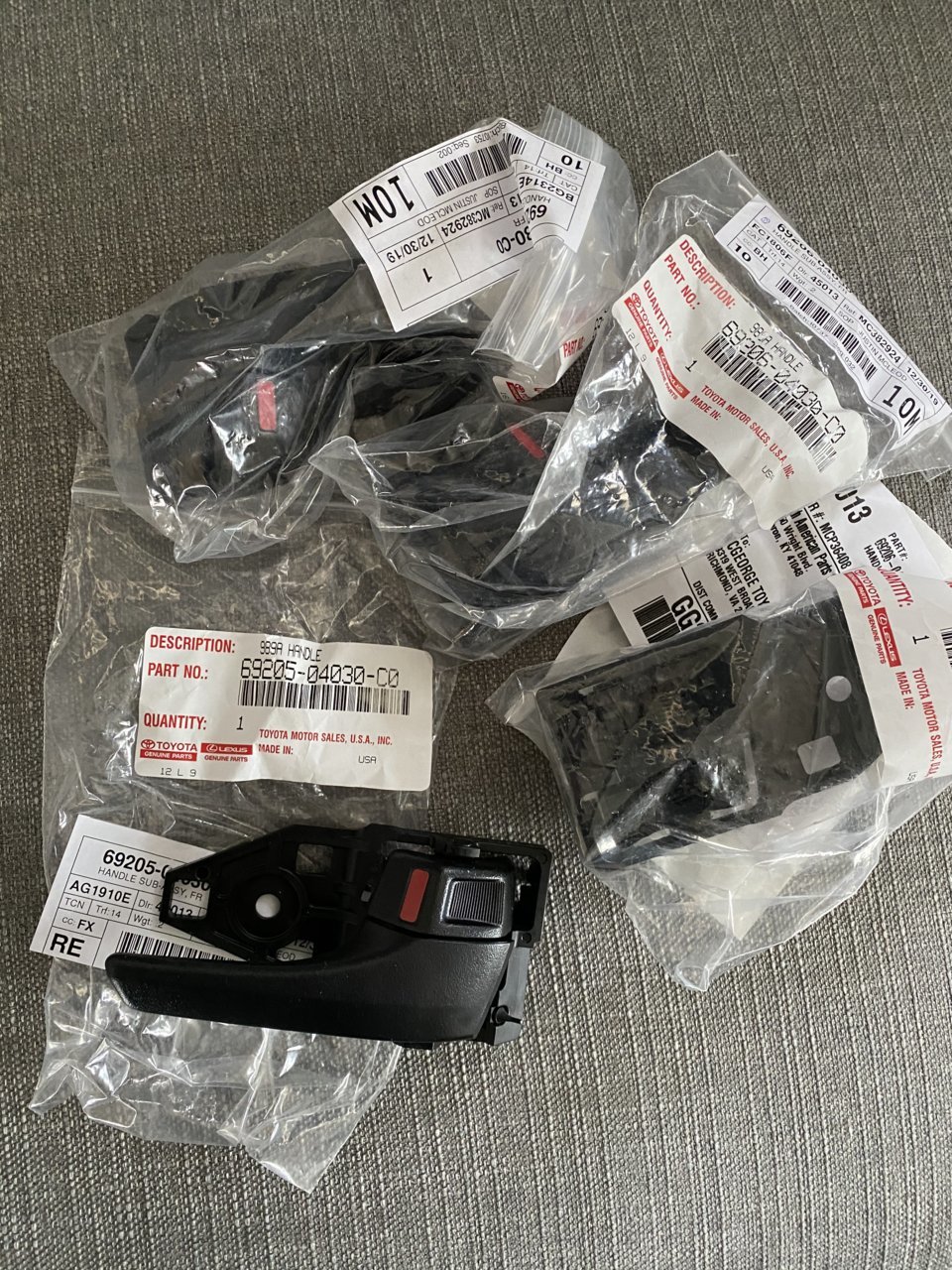

    Yes. The install is super simple. Follow MESO’s install guide for the puddle pods up to step 1-I and then reinstall the door panels.
    I got mine from McGeorge Toyota’s online parts site. Here are the part numbers and price I got them for. Keep in mind part prices fluctuate often, but McGeorge had the lowest cost I could find stateside from a dealership.

    Yep they are super easy. Just pull the door panels off, disconnect the two cables, and the old handles pop out. Pop the new one in, reconnect to cables, and reinstall door panels. I also bought mine on Amazon for $16 and some change apiece.

    I pulled the trigger on some eBay ones just now. $30 each as I'm in Canada (~$23 USD shipped). Dealer was closer to $50 (can't remember exactly). Hopefully I can get a few bucks back for the chrome ones, to lower the overall cost of this mod. The wife won't be happy that I spent $100+ on door handles. lol
