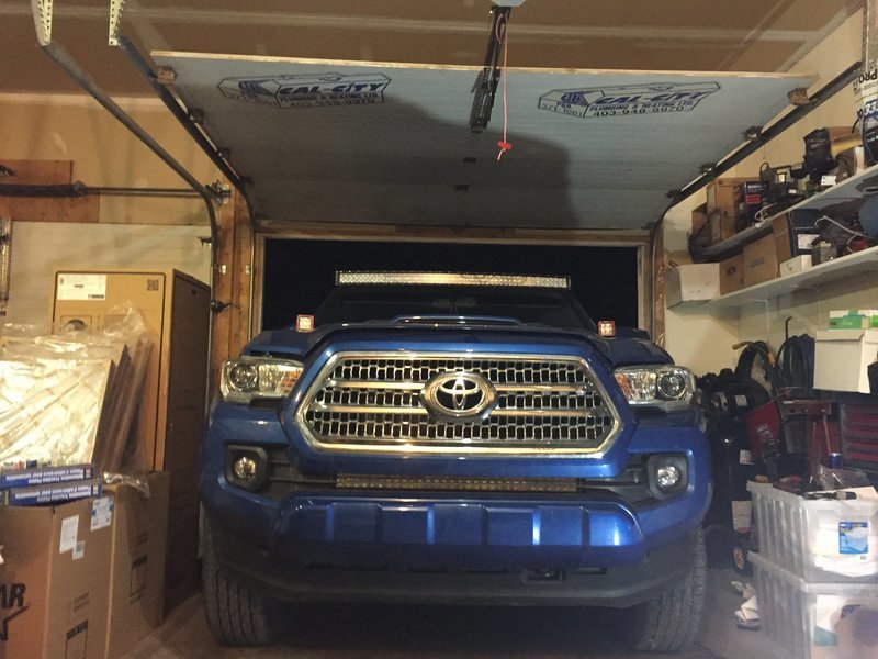

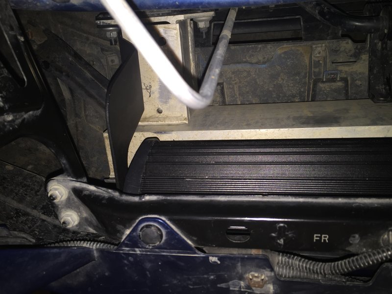

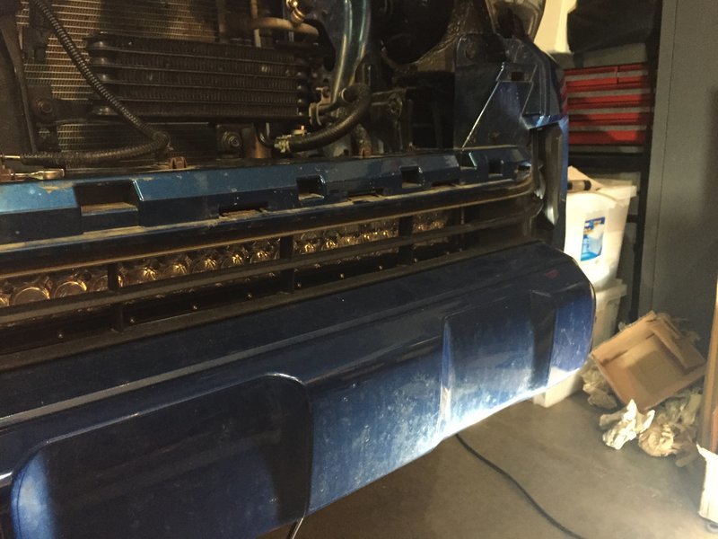

    Heres some pics of my install, not the greatest... But pics none the less!
    SilverII and Pnwoutdoors like this.

    I also found it alot easier to slide the bar into the drivers side instead of the passenger like the instructions suggest. Didnt have to unbolt/move the transmission cooler either.

    what mount did you use? also can you show some pics of your wire harness and how you ran it?

    I used the rago fabrication bracket, which is the same as the cali raised. With the hidden lightbar behind lower grill valence. I can show wireing pics later.

    Nice, I also ordered the Rago. I think it was like 60 bucks, about half of the cali ones and others that I have seen. They look like pretty good quality from your pics. mine are in the mail

    They are the same bracket, rago makes them for cali raised... And cali raised are 55$ for the bracket, havnt had any issues. Found that the bar was alittle diffucult to keep steady so i placed some rubber between the bar and bracket on each side. Had no issues after that. Ill see if i can get some good pics.
