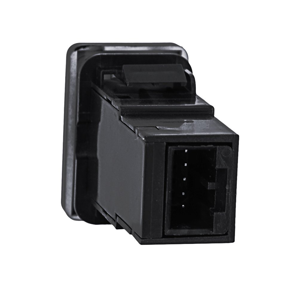

    I have another switch I would like to use because this one will not fit the center buttons on the 3rd gen...just the buttons to the left of the steering wheel and I have no open slots. Does the back of your premium harness switch look like this one? This is a picture of the switch I have...its the smaller pushbutton style so if its the same pin config I should be able to use your harness and my smaller switch with no cutting. Once the premium harness is available of course. :)

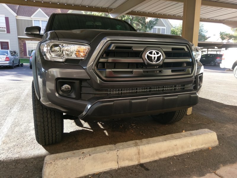

    Just installed
    @CaliRaisedLed single row 31" bar mounted stealth like

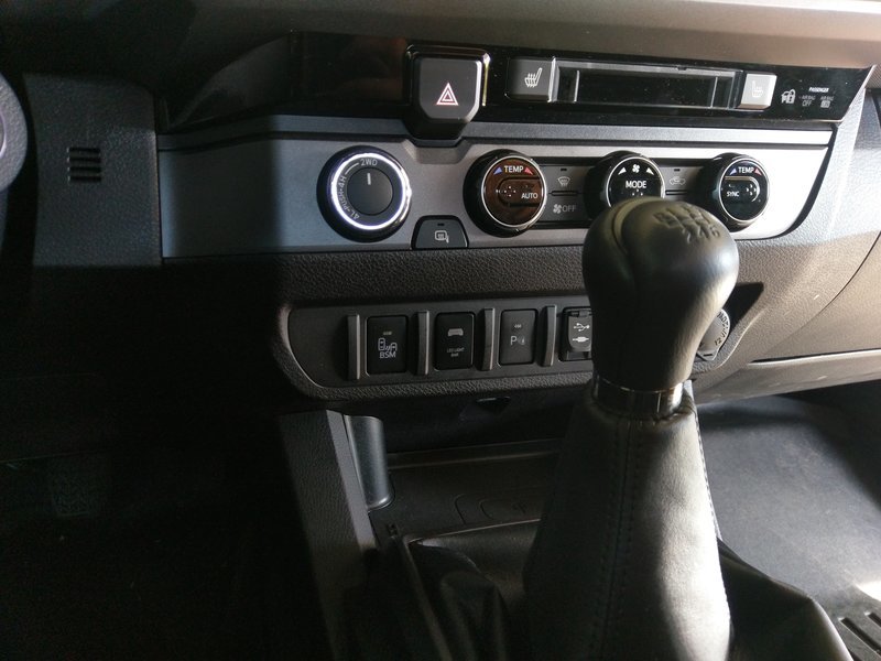

    IMAG0126.jpg Installed Kodiak eclipse bar and swapped out the switch. The switch only comes on when pushed to turn on the led bar...I didn't want to mess with splicing the switch into factory wiring or adding fuses.

    Where did you get the piece to cover that cubby hole where your switches are? Also, did you have to drill out a hole in the back of the cubby for the wires to go through?
    Did you have to dremel out the holes or were there blanks already there?

    Nope my center console had 1 blank. Popped out the blank popped in the mictuning switch..super easy.
