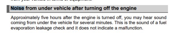

    Has anyone ever encountered this? Went in the garage to add windshield washer to my wife's car and I heard a buzzing sound from under the box. It went on for a few minutes then stopped. Not sure how long it had been doing this. Was in the garage an hour earlier and never heard this sound. The taco in the fuel pump recall.

    It does it almost every night. It’s part of the EVaP charcoal canister being regenerated. My Camry does it as well. It’s on a timer and I think runs four hours after the car is parked.
    totally normal.

    Thanks for the replies, actually it was about 4 1/2 hours after I parked it. Never heard that sound before.

    If you want to know the gritty details on what's going on, this is a fun read.
