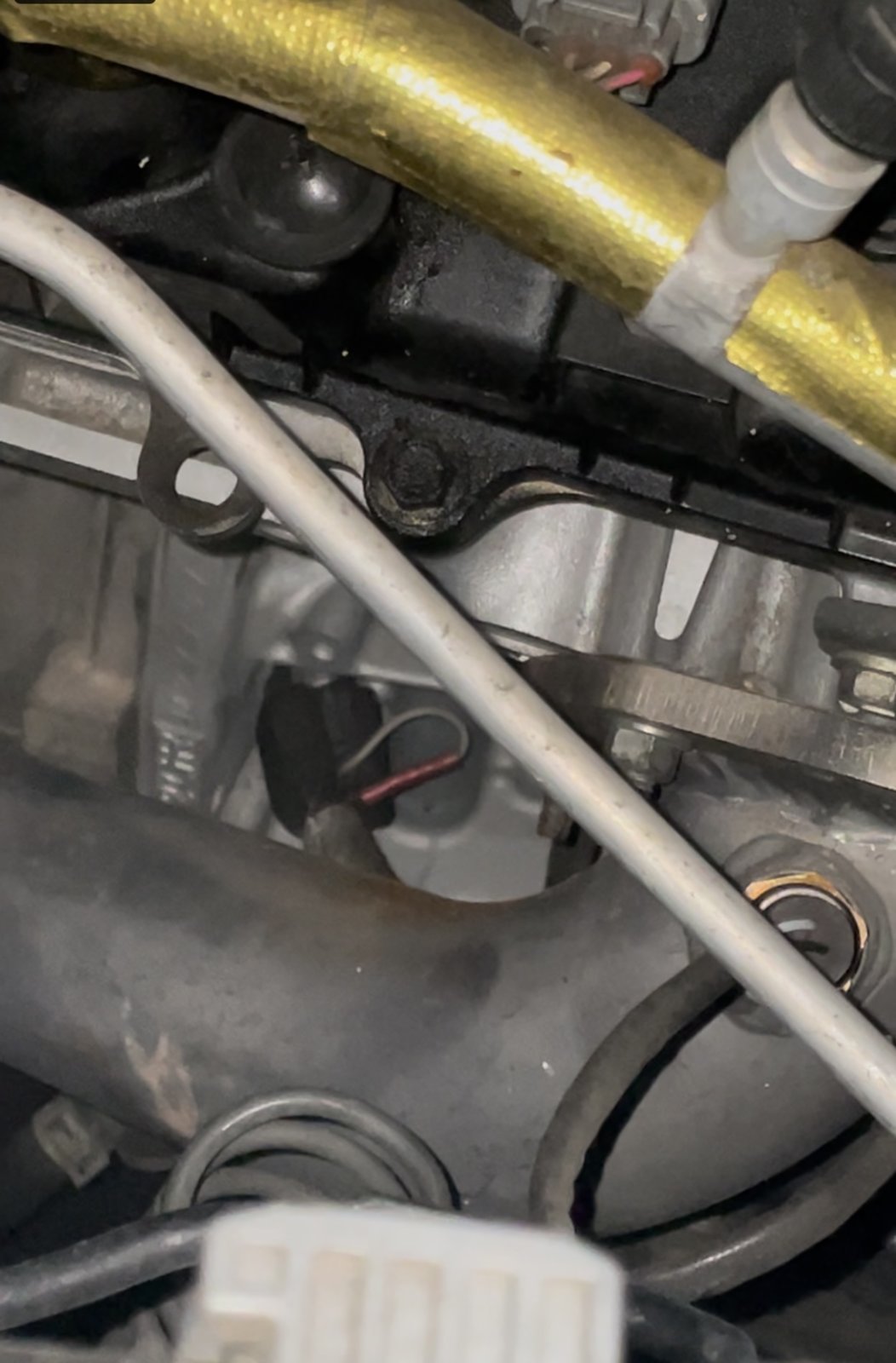

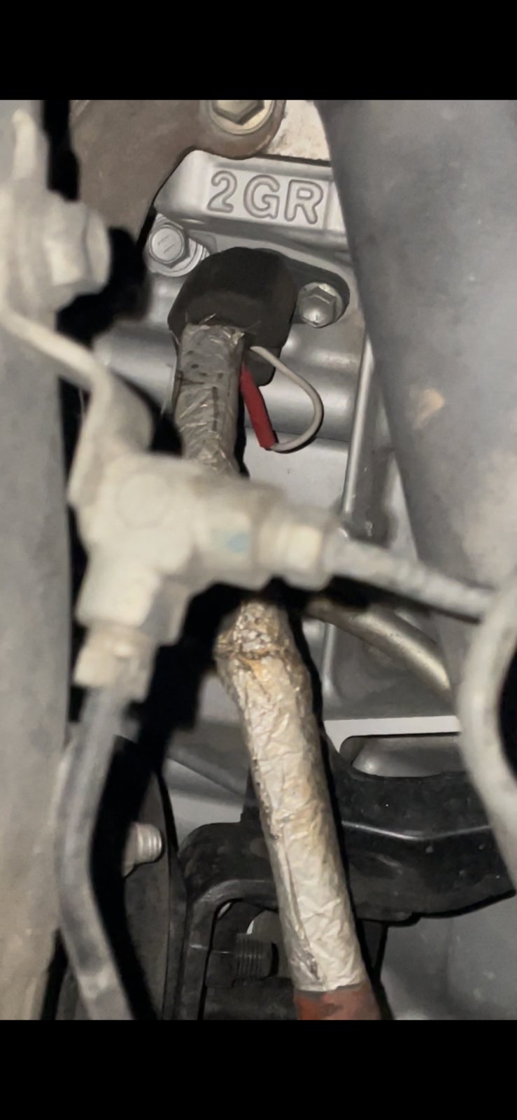

    Can anyone ID this sensor? I noticed it today and am wondering if it’s been spliced. Passenger side engine bay on the lower block next the the “2GR” stamp behind the cat. Shown from above and through the passenger fender well with the dust flap removed. IMG_0670.png

    Knock sensor #1

    does yours have that wire sticking out?

    This is not a knock sensor

    I would go check but it’s raining today, maybe someone else can look.

    it’s in the same spot as the knock sensor, and looks like the knock sensor…. :anonymous:

    2gr-fks knock sensors are in the cylinder block valley.

    That is Crankshaft position sensor. Looks like the plug was repaired. Leave it alone If no codes
