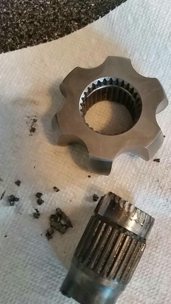

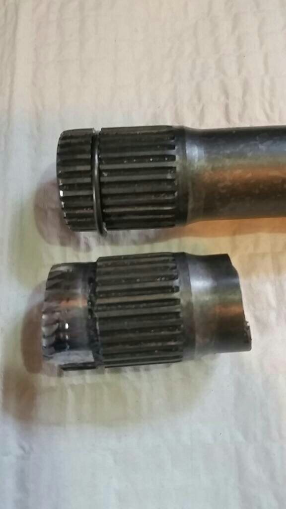

    That's not what's going to possibly cause the damage, your forcing the retaining clip further through the splines.
    Here's a visual. Path of least resistance...f063cd69635ced13fe81c3127d26ad67_9678a2f9d909a44dbf3752fe046adc7edefcca00.jpg

    That's why i go back and forth to break the c clip, my splines looked nothing like that they looked brand new

    Only one of my axles that looked like that. Was a brand new cv, took almost 100 tons to get it out, shot out like a rocket. Clip stayed in the channel.
