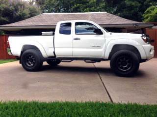

    Opinions ..... I'm pulling the trigger on a Kings coil-over and Total Chaos UCA up-grade to my gen2 Access cab Tacoma. She has a spacer lift so I'm just upgrading the lift components. Any ideas opinions on sequencing, I realize I'll do one side at a time, I've searched this forum, others and watched all the YouTube vids (over and over). I have mechanical experience and tools so my confidence is high :). I've just not done this particular task
    Thoughts :confused:
    iPhone photo is somewhat out of perspective :rolleyes:

    I did one side at a time. Uca first then the coil over. No problem. Just keep your phone handy for reference.

    The coils will be easy, the UCas are kind of a pain in the ass. 1 side at a time is fine if you are by yourself. Don't mix up driver's and passenger's side UCAs

    Yep.. I'll cut the top bolts on the UCA and replace with new.
