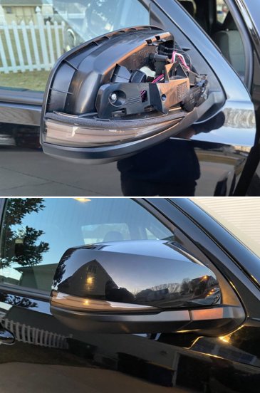

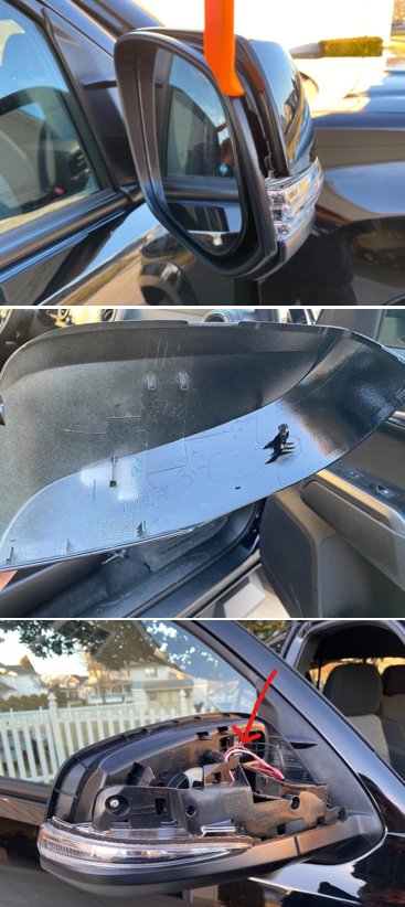

    I had my adventure with discretely removing the plastic cover off the side mirror.
    Arrow shows where the polarity plugs are connected--check operation before putting it all back together.
    I got the smoked sequentials.
