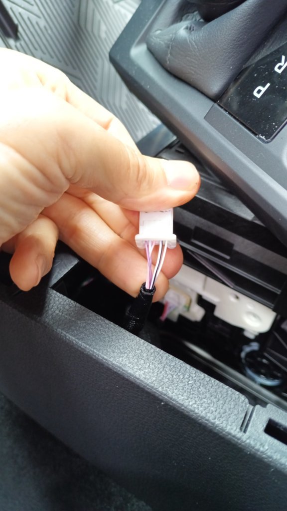

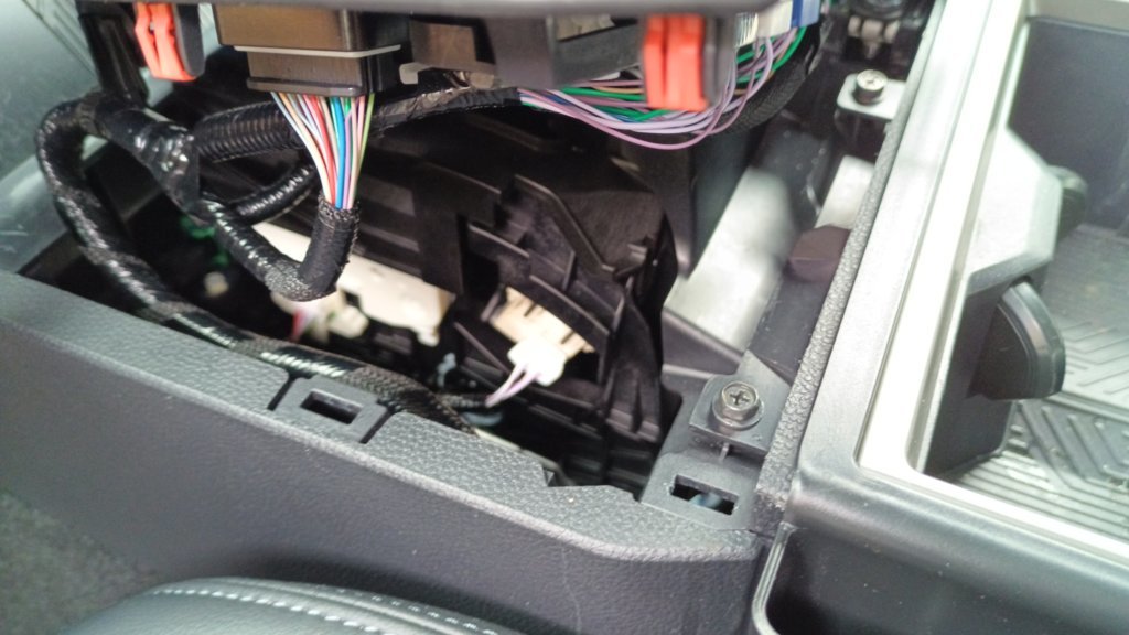

    The sport mode bump-shift (sequential shifter) is backwards. Should be a forward bump under braking is a down-shift and pull under acceleration should be up-shift.
    The fix is simple. Swap the pink and purple wires on connector J50. Takes about 10-minutes. This is on iForce Max hybrid.

    in the sport pocket the shifter moves forward and backward and sequentially moves thru the gears. in a sequential mode, a forward bump should be a down-shift and a pull should be up-shift.

    many mfgs use different configurations and do not try to conform to the bump-shift sequential gearbox operation of forward-down shift and pull-upshift.
    if you like it the way it is then your fix is to do nothing.
    i'm just providing a simple 10-minute method to change the bump-shift operation if desired.

    What is the procedure for lifting the plastic plate that has the indicator and shift boot?
    Does it just pry up?
    TIA

    there are four clips that hold the shifter console in place. just grab it and work it free from the clips. no tools required.

    it doesn't matter whether it holds the gear or not. the mod referenced above changes the direction of the shift lever bump for the up-shift or down-shift.
