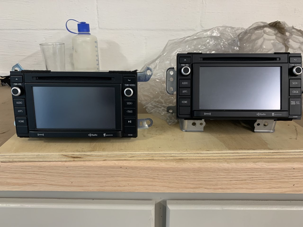

    has anyone used a sequoia entune premium in their truck? it’s the exact size of the basic/plus head unit but has the actual gps maps/card.
    it also would save from having to buy a 260 dollar trim panel.
    the plugs on the back look identical.
    i know all around it’s better to just go with an aftermarket, but i may have a deal popping up on one. Curious if it’s been done.

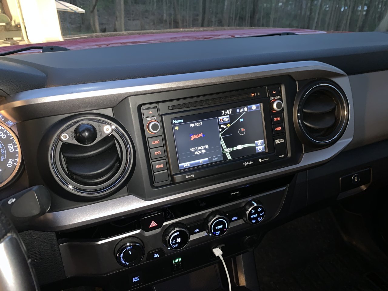

    A02C5F74-91E4-4013-A91F-01137F2016DB.jpg 29155AA7-5E56-4F61-AA8C-27CEF9DFB926.jpg so i ended up getting the headunit- switched over the xm unit and brackets...plugged in and fired up. i had to change some settings (like bluetooth kept popping up “sequoia”.
    having a real gps map and not having to change out my trim was nice.
    are their better ways to do it, yup. i wanted to keep mine as original as possible.

    Are the buttons red? Super cool idea

    yup, everything else works just like it should, even have turn by turn nav on the MID

    so after a lot of testing, i’m going back to my entune plus and sending the sequoia unit back. there is something programes different in it that won’t allow it to communicate speed/mileage/distance.
    nav worked awesome.
    so in short- if you find one cheap- it works...minus the eco button.
