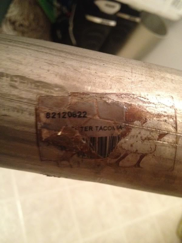

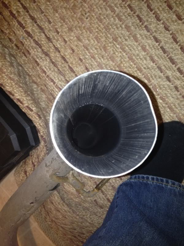

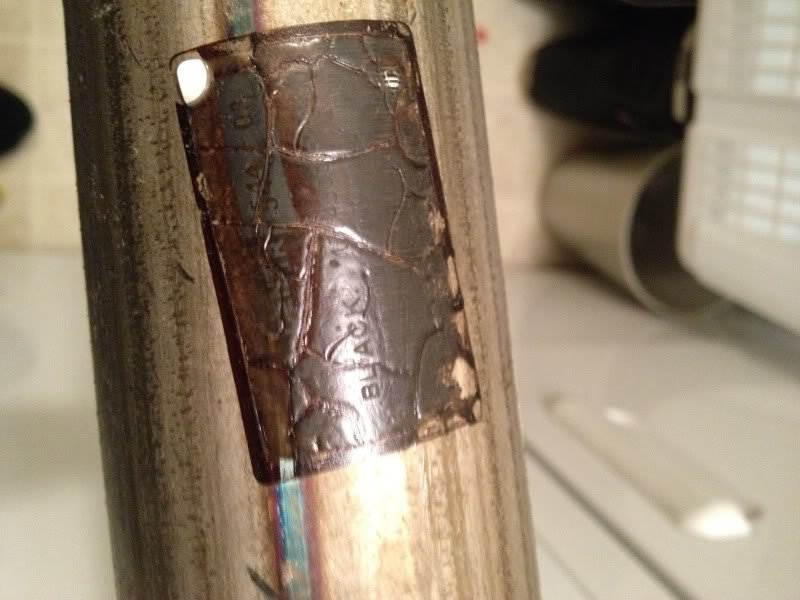

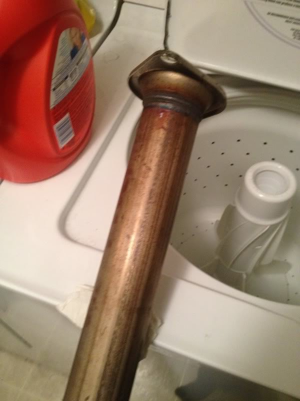

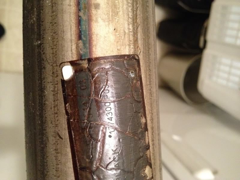

    So I bought a new 2013 tacoma, picked it up thursday. I got them to add a trd exhaust and got it done today. When I went to pick it up the old exhaust wasnt in my truck box like I asked, so they took it back and put the exhaust in the back.
    I examined it and notice the muffler was a little bent and the exhaust is in poorer condition than I thought my "new" exhaust would be. I started checking the stickers and they look pretty old but I did notice one says "black"
    My question is did they give me a used exhaust instead of my new exhaust back? How can I tell?
    Here are pics.
    My thoughts; should the stamps be that worn already, the damage to muffle tip could be during removal or storing, not a big deal.

    Not sure why it says black, but a sticker on an exhaust is going to melt and bubble in seconds I imagine. The color of the steel would probably change quick also.
    Some people go as far as to wipe all fingerprints off of a stainless exhaust before they start the vehicle because the heat reacts with oils on our skin that transfered onto the steel and it discolors with heat.
    I see zero issues on resale of ur at ck exhaust if that's what ur worried about. Most ppl go back to stock if they are selling their truck, or they grow tired of their aftermarket products xhausts tone. Neither case would worry for 1 second I imagine about a small dent or a discover

    Also 409 stainless can discolor without ever having the engine run iirc.

    That looks like its pretty new. I don't see any carbon build up

    I only see normal discoloring nearest the y pipe which would get toasty quite fast due to the secondary or after cats (whatever u choose to call those two that are integrated into the y pipe).

    couple of minutes of engine running and they start to discolor, I was always amazed at how fast new racing headers took to discolor from heat..
    looks pretty normal....

    You can fix that dent by taking a piece of smaller diameter tubing that fits inside loosely, inserting it, and then angling it to press against the bent spot. :thumbsup:
    Also save your stock exhaust just in case you ever want to go back. I did. ;)

    Some dealerships have a parts stock of "new-old" parts. These are parts removed from a new vehicle due to a request for a change prior to delivery. They can't be sold as new, but a lot of dealerships retain these parts that are not asked to be given to the customer to use in case of emergencies. For example, you bring in your truck for service and the driver accidentally backs your truck too close to the wall, and damages your exhaust tips. Rather than replace that with a brand new, expensive exhaust, they install the "new-old" part. It is essentially new, but is not "out of the box" new. Don't misunderstand, when we did this before, we would let the customer know they were getting a new-old part. Essentially zero miles on the exhaust.
