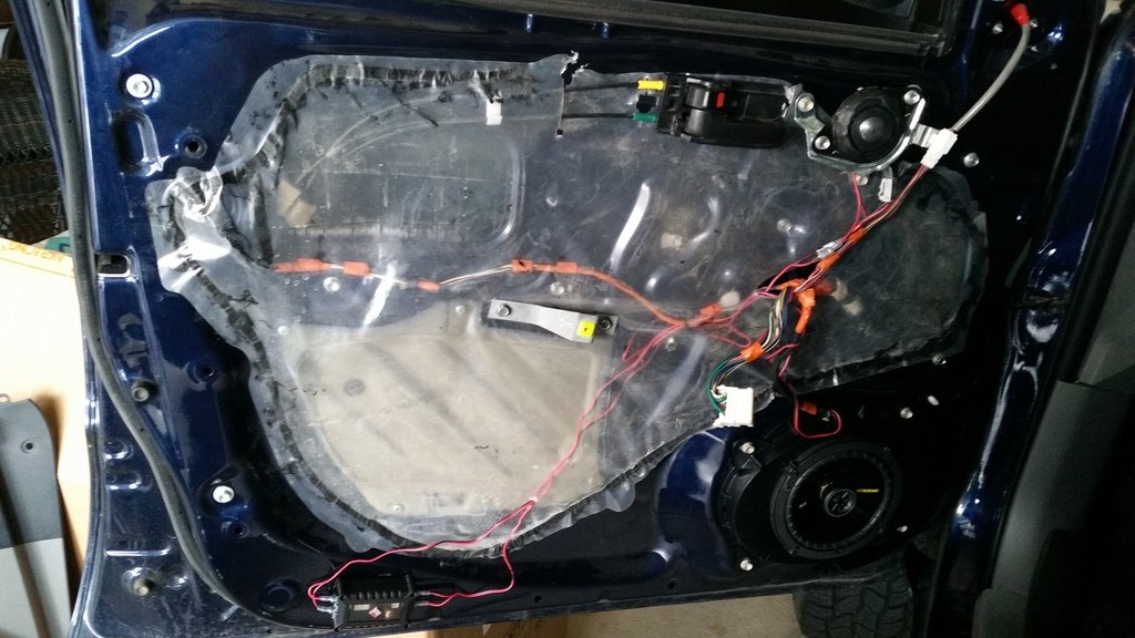

    Here is a pic to help you visualize what I have setup. Output from the amplifier comes from the stock wiring. The right side of the crossover is the input side while the left side of it is the output.

    Shit. I have been shooting for several years. Both ear pro in and out (accidentally). Maybe it could be that. I just expected a lot more voice and definitely more clarity out of the singular tweeters themselves honestly. Would it be possible that driving that many speakers is actually overloading the two channels on the amp? Everything is hooked up in parallel, as I have never liked series wiring for stereo or lighting applications. The crossovers are tuned to the tweeters as they came together as a set. I actually dialed them down -2 db as per the instructions stated that our particular combination runs best on -2 db from the woofer if the woofer is running close to the kick panels. Maybe I could operate the rear door speakers with the subwoofer instead, seeing as in stock form the rear speakers operate in parallel to the subwoofer anyways, on a prior JBL setup.
