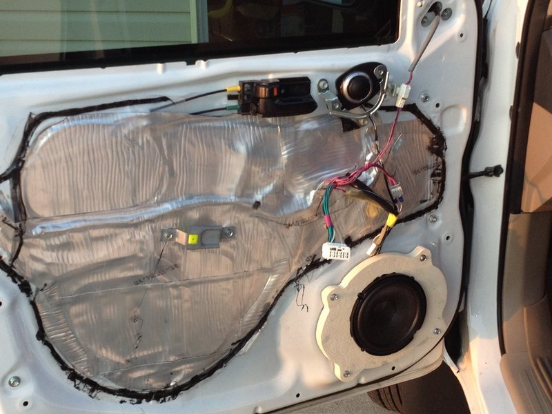

    Goddamn xfinity!!! My service is spotty at best. You mentioned staging, I call it imaging. That why I posted those pics then my service crapped out. image.jpg

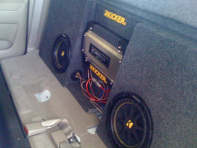

    Finally, 6 1/2in in the lower door, (mid range) tweeters in factory location, both driven with a "high powered" Pioneer head unit. Box behind rear seat, two 8inch Kickers driven with a inexpensive Cadence amp, bridged at 2 ohm stable. Nothing in the rear doors. All crossover points are controlled by the head unit.

    No, it doesn't. I compiled this layout for the front seats. Again ********* pointed me in this direction. I dropped some coaxials in the rear doors (a few different pairs) totally destroyed the imaging, or staging in your words. Plus, fuck whoever is in the back seats (rarely anyone).
