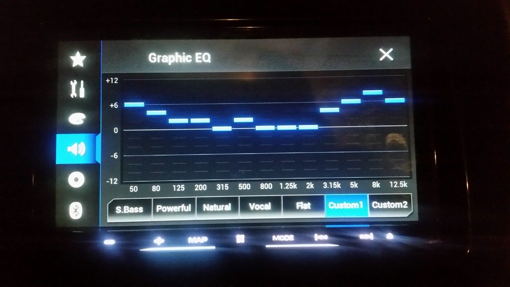

    The eq and crossovers on the headunit would be nice to look at. I couldn't find it on their site.
    This ^^^ Perhaps I may have misunderstood your overall setup @12TRDTacoma. Maybe a rough wiring schematic of how you have things currently wired will paint a cleaner picture.

    Wiring setup guys:
    Front channels all wired in parallel to front channels, total of 6 speakers, 2 channels.
    LF: 1 coaxial door speaker wired in parallel to a crossover which powers 1 tweeter.
    RF: 1 coaxial door speaker wired in parallel to a crossover which powers 1 tweeter.
    LR: 1 woofer wired in parallel to LF speaker at the amplifier
    RR: 1 woofer wired in parallel to RF speaker at the amplifier
    Sub: DVC stock subwoofer wired in parallel. Total of 4 connections 2 powers, 2 grounds. 1 channel handles each channel of the voice coils independently. Total of 2 channels.
    4 channel amplifier.

    Well, not necessarily blow my windows out. I am just looking for the ability for my speakers to be able to play highs and voice clearly through almost all volumes without distorting or sounding muddy. I understand speakers or the amp itself has it's power limitstions. Like I said. I stand in MUCH better shape than I did with the stock JBL amp. You have no idea how much the OE amp made the music I currently play clip. All kinds of clipping all day long!
    I listen to a lot of rock, metal, and progressive. For what it is worth. So a quality guitar sound is key here. Plus a clear frontman voice.

    The specs on this headunit states it has a crossover network with HPF/LPF. Would like to see that if you have it. For starters select Flat to even out the eq. 200 Hz to 2 kHz on that spectrum looks to be your vocal range adjustment. 80 and 125 Hz on that spectrum should affect your mid-bass and 50 Hz should affect your sub stage. 3.15 kHz and up would be what your tweeters would be trying to reproduce.
    Depending on your volume offset (or whatever pioneer calls it) I would cut 8 kHz and 12.5 kHz and 80 Hz and 125 Hz first to see how much your vocals "rise" and go from there. This is just a baseline I would start with and again without an RTA it's really going to be trial and error on your part.
    It's hard to get used to cutting frequencies versus boosting to get the sound you like but in the long run it keeps the high volume levels under control and cleaner.

    Concordia
    12 TRD Sport DCLB 4x4 Supercharged
    Boosted
    I agree with the baseline and adjust as needed IF needed part. I actually was going to say that earlier myself.
    As far as cutting the frequencies. How much should I cut them down to? -1 -2 etc..?
    Could you possibly MS paint or somehow show me your ideal EQ scheme so I can basically match it and see how it sounds from there?

    Again, I agree with you on peoples tastes being different. But any baseline is better than none. When I first started playing with eq no one was willing to help me citing "personal preference". I personally use a reverse boost method when tuning my eq's. His settings are way off according to your taste and according to my taste I wouldn't be boosting 50 Hz that much...but the least we can do is help him get to a more traditional baseline.
    My paint skills are horrible...my sketchup is better. Either way this is how I would start your baseline and cut the vocal frequencies from there. 8 kHz and 12.5 kHz will affect that "tick tick tick" or hi-hat type sound "chi chi chiiiii" or however it sounds. 3.15 kHz and 5 kHz will affect some vocals but that can go either way. 125 Hz can go either way so it's better to start it lower.
    I personally cut everything and raise it as close to 0 as possible to get the sound I like. I also do this at close to full listening volume so I have to find an open field somewhere to do this. I also personally try not to go above 0 if I can help it. The below picture just tries to isolate most of the vocal frequencies you can adjust.
