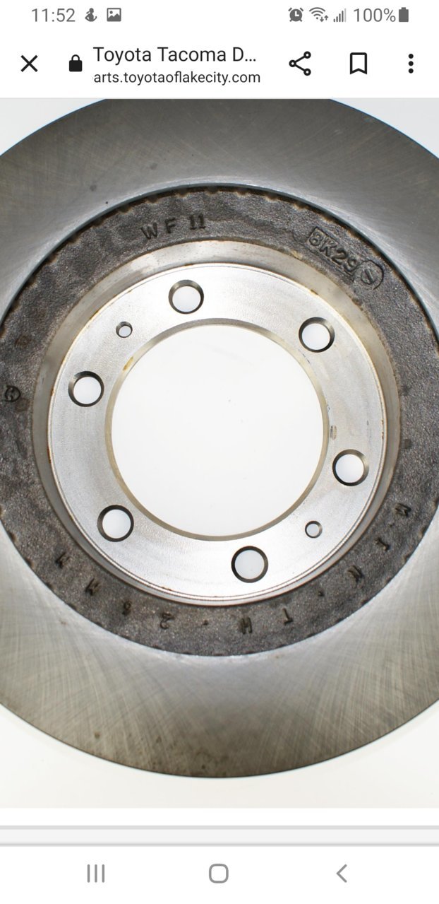

    Well as it turns out, and to my disgust, the stock Tacoma rotors are garbage and now that this truck is in the mountains of CO it is quite evident. So it looks like I'll be ordering some Power Stop rotors and pads for it. I talked to the dealer about the problem and they said they'd be happy to diagnose it and the cost only $145 per hour, but, they said, it probably wouldn't take an hour,, LMAO yeah! you already know what is wrong!

    Power stop , trq and many other rotors, on Amazon especially, are made in China..

    Every aftermarket rotor you can buy for the Tacoma is made in China....the OE rotors are very likely cast at Waupaca Foundry here in the states...Looks for a "WF" casting mark on the rotor somewhere to confirm.
    <--20 years in the aftermarket brake business
