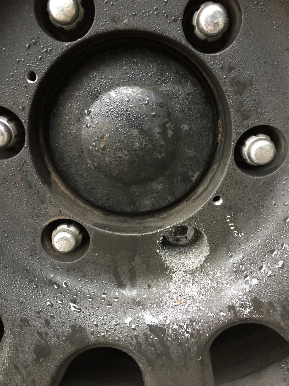

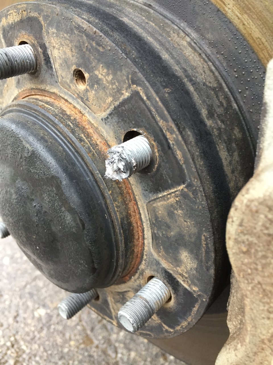

    Get an impact socket red hot and hammer it on the broken lug and give it a few minutes to heat transfer, then try to loosen it.

    Too bad a metal disintigrator wont work. If possible, heat the broken aluminum (transfer is best and let it heat sink) and using a big screwdriver and huge heavy hammer, start to give it some blows and hope for the best. Leverage with downward blows is best and make sure the screwdriver is catching or digging into the aluminum.

    Drill a small hole in center of lug. Then keep stepping up sizes untill its the size of the lug and enough material is gone and rip the wheel off.
    It takes a long time but cheaper than paying someone
    And whatever you do go slow, dont break drill bits inside rhe lug

    Not sure how your center caps go on. Mine though have a flange that goes completely around the inside of the rim; sandwiched between the hub and the rim. Mine are impossible to get off undamaged without removing the rim. Just a word of caution.
