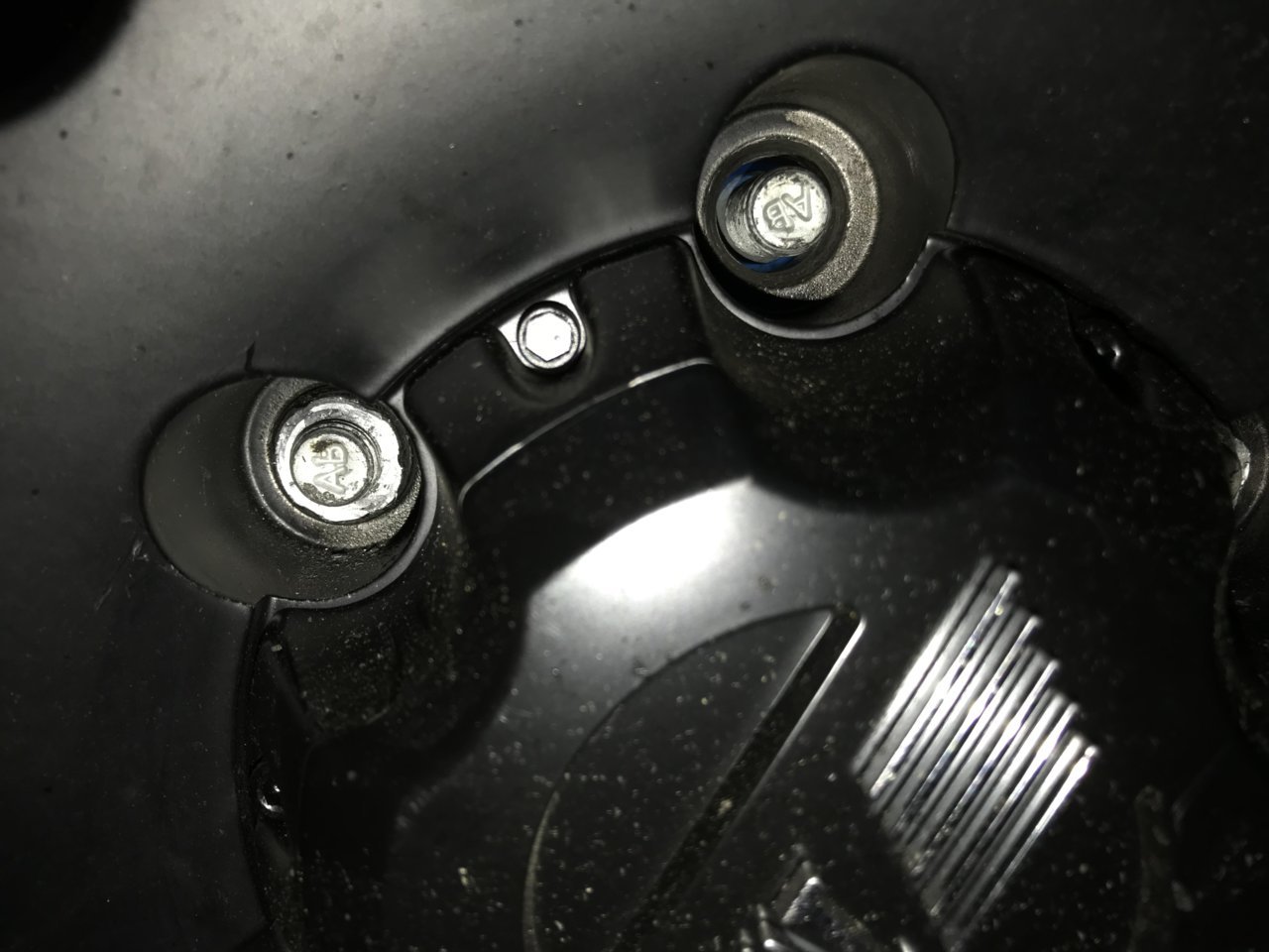

    So the lug nuts are an alloy and the studs steel, right?
    My guess is they were crossed threaded going on and the studs cut new threads in the nuts. And the impact over tighted them as well.
    Id certainly try removing the rest by hand, so you can feel if there is a bind. If so, tighten it back just a little then come off again. Repeat till removed; youll likely be 'cutting' threads backwards.
    On the broken ones, is there a shoulder left you can get a socket on?
    If not, a 1/4" wide hardened chisel driven on the edge of the remaining nut material may well cause it to split, allowing you to get it off
    Good luck!

    @johntoyota Can we get a picture of the remaining lug nuts/studs?

    This is a comparison of the one that came off to one of the ones that didn’t.
    I think the drilling the stud out method is going to be my route. I got two of them hollowed out pretty good but it got dark and I want to get new bits tomorrow to finish with.
    I am drilling into the studs on the spacers, not the truck studs. So I don’t care about them. The whole point was to take them off anyway.
    Yes I learned my lesson. No more impact putting them on even though I’ve done it for 20+ years. This was a new impact though. But battery, not pneumatic, so I didn’t think this would happen.

    Drilling is gonna take forever man.
    Honestly I would try the socket and a hammer approach.
