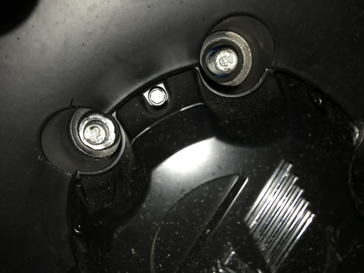

    Dremel it away.
    Need pics also so people can give better suggestion.

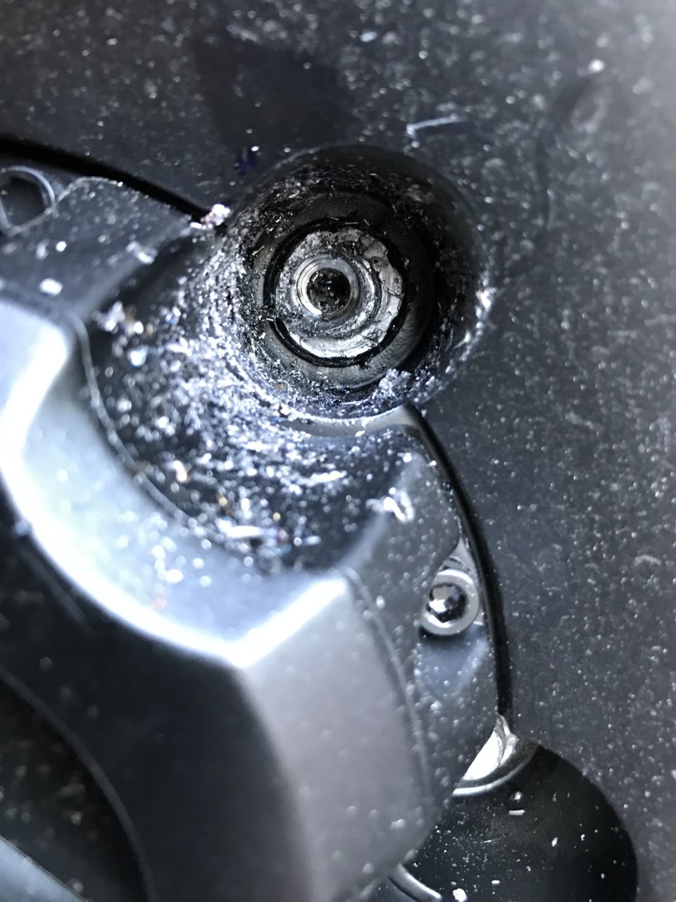

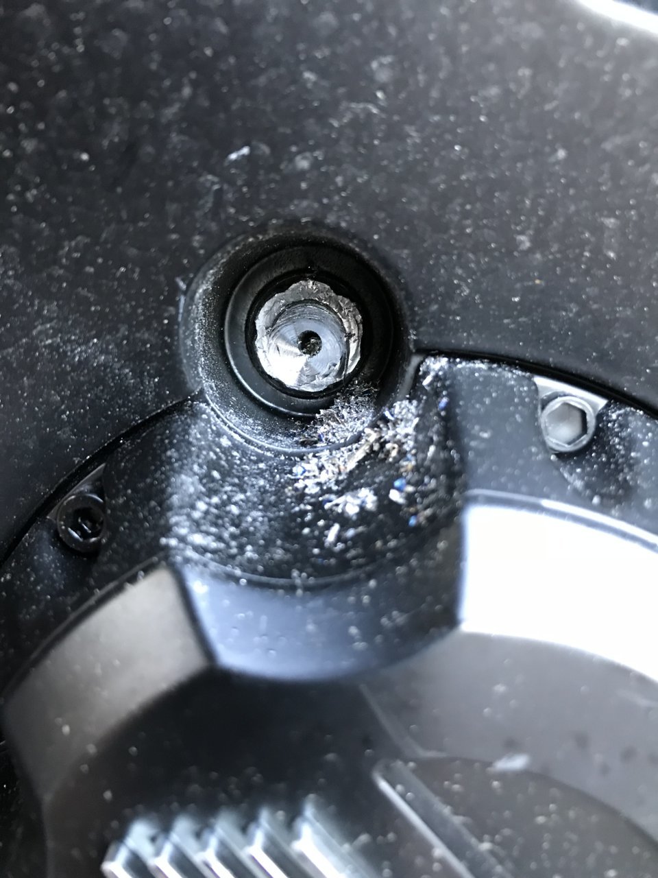

    The two were as far as I got last night with the bits I had. Was going pretty well considering old bits.
    The other is a pic of the one that came out vs. one that sheared.
