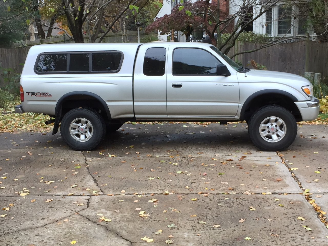

    Thanks for the measurements, really helped with my decision. Got my 881's installed, 5100 on bottom setting. Gained a little over 3/4 inch, over the stock springs on the middle setting. I've got about 3/4in. of rake front to back, with my 1.5 aal.
