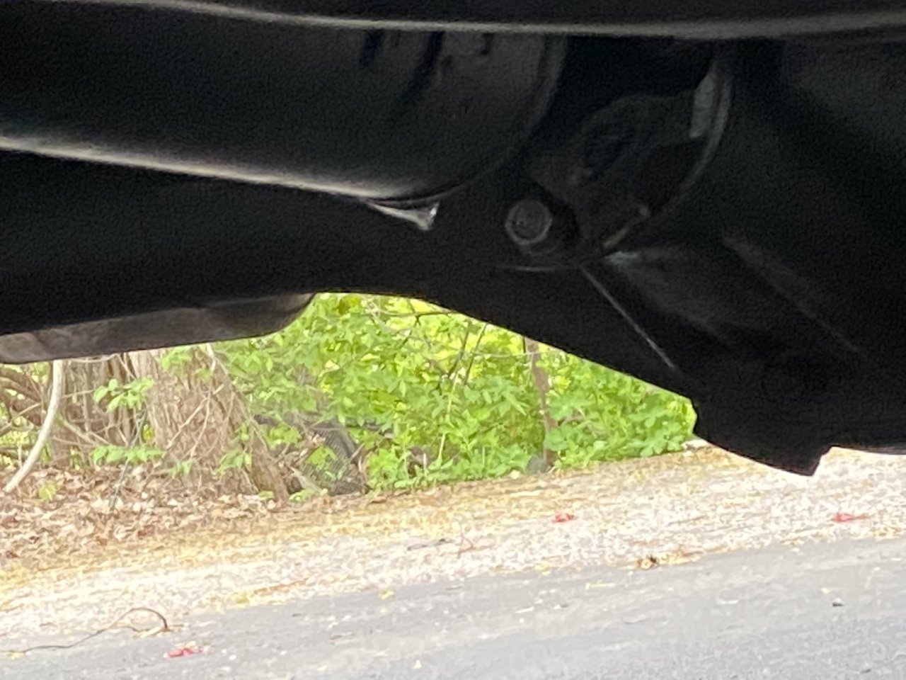

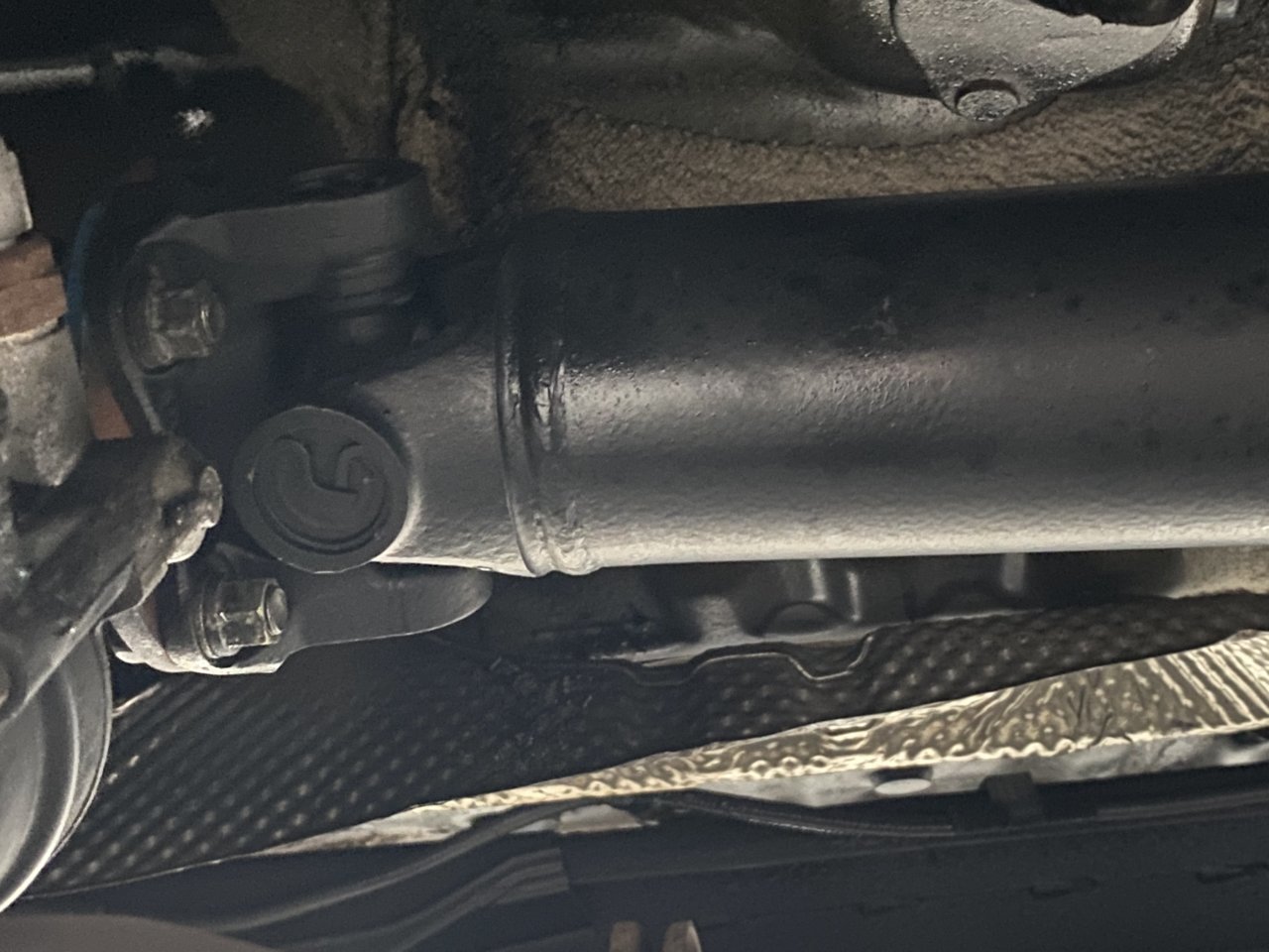

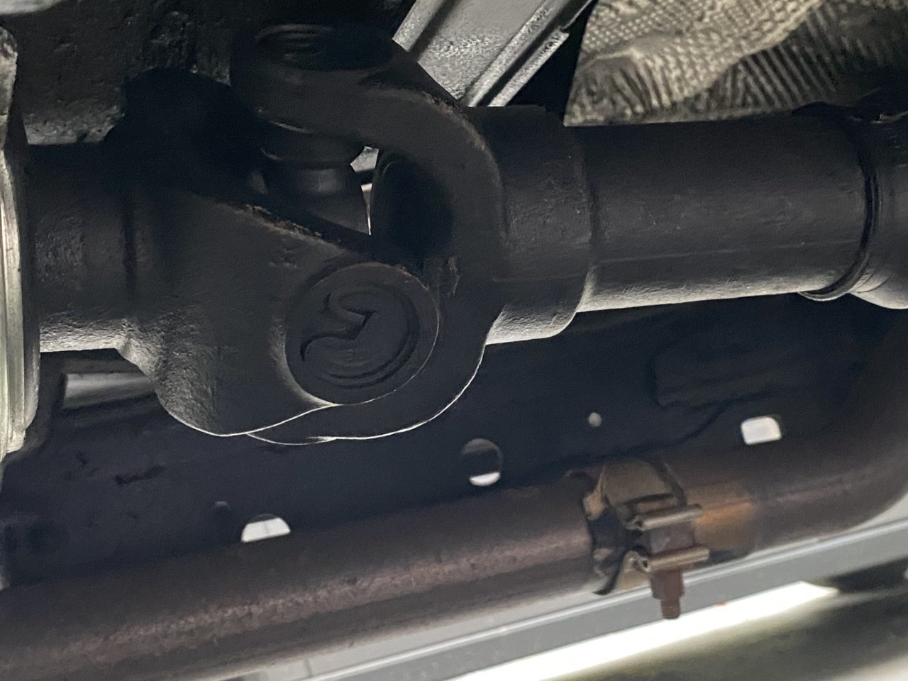

    I’ll try that all u joints face the same direction and how fast can one go in just front drive?A9D106A0-F414-4E55-ADC2-79B031AD1417.jpg3585E393-52A3-4B1A-BB29-3B9AF41475AF.jpg 33F0118A-DC41-423F-8AD0-125FB4C05219.jpg

    You can go well Over the speed limit safely. For a quick test it won’t hurt anything. Just avoid burnouts
