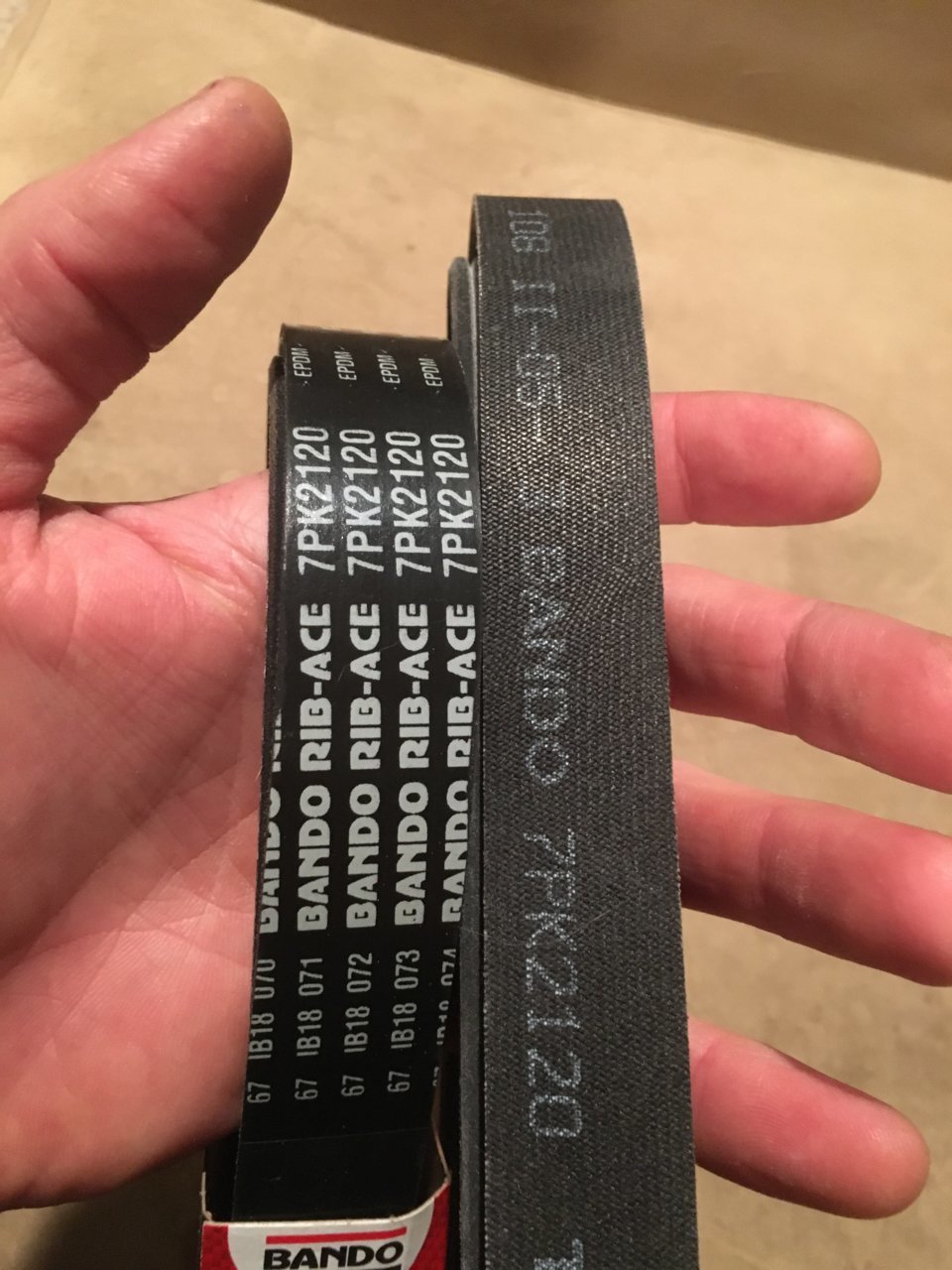

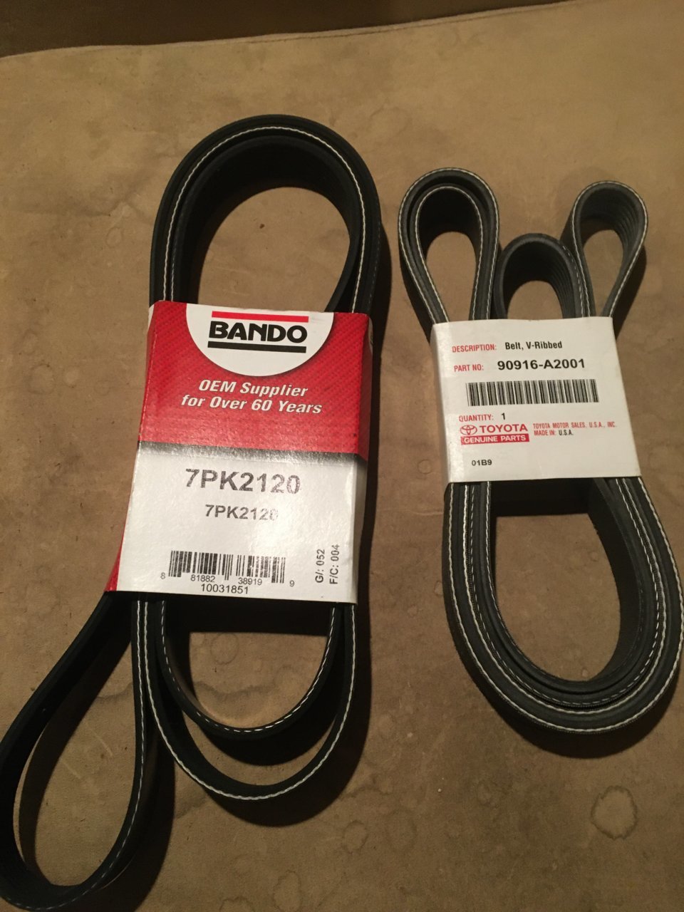

    Did you change any idler/other pulleys or just change the belt?
    Gates is normally pretty good, but for a serpentine belt, I’d get OEM Toyota. Bando makes it for Toyota, but after comparing them side by side, the Toyota branded one is better.
