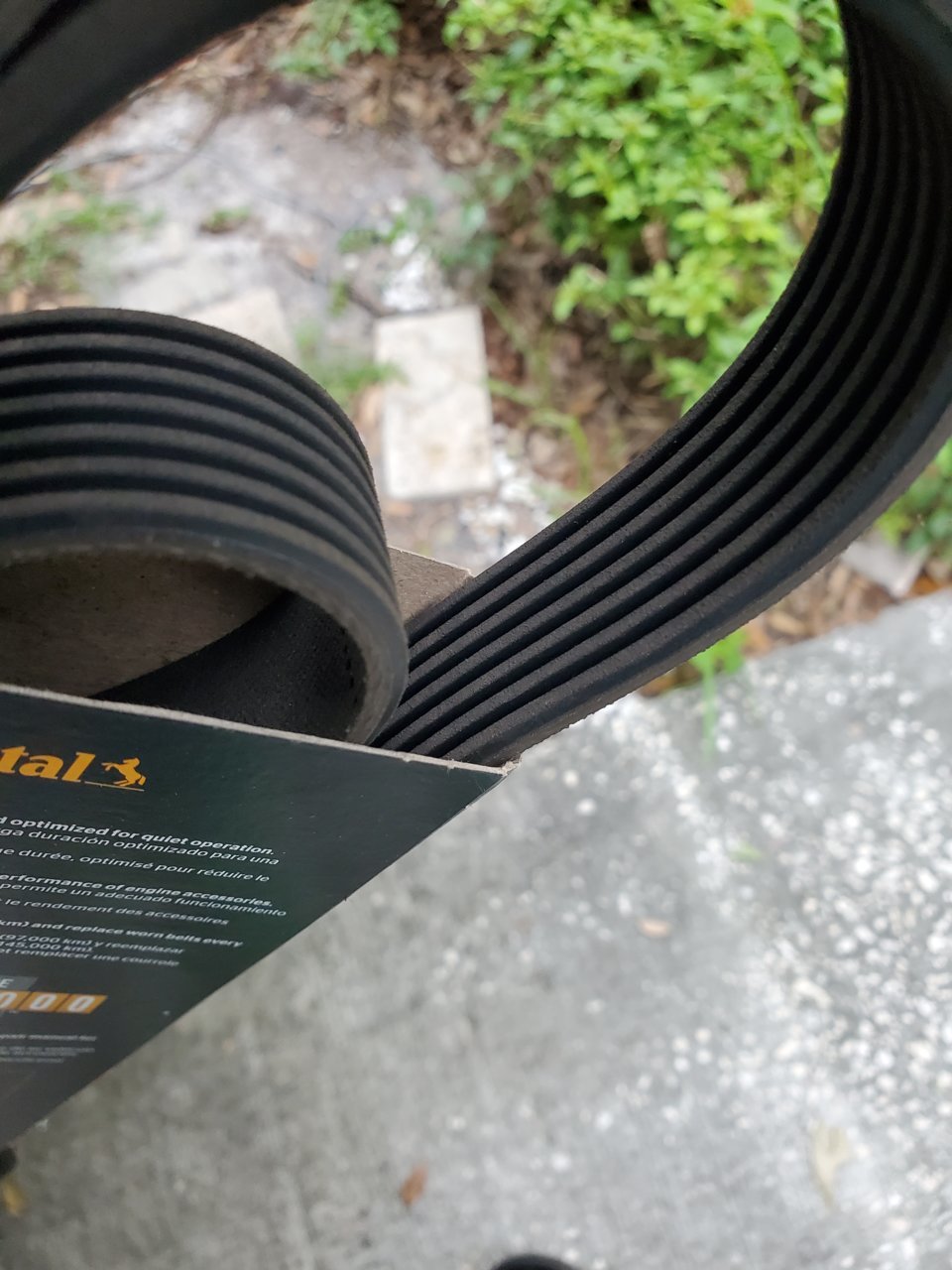

    Makes me wonder if you have a bad bearing in the tensioner or a guide. Looks like part of the belt melted into the belt grooves.

    It only had 21,000 miles on it. I’m happy to change it out earlier than recommended but it’s not like I was rocking a belt with 80,000 miles on it :rofl:
    Same here, had it off about a month ago and it looked solid. Maybe @Spacecoast is right, I’m wondering if I should be looking at pulleys and bearings now.

    I know when the dealer did my timing belt replacement after every 90k miles on my gen1 tundra 4.7, they replaced the water pump, serpentine belt, and tensioner as a kit.

    OE Toyota belts are generally very tough across all models. I am curious if these failures are 'normal' statistics within the production numbers or something else. Mine looks new at 50K miles but I don't off road or drive through deep water, etc.

    Yeah I should probably look into that, it’s been on my list but it sounds like I should bump it up a few spots.

    My original at 100-110K still looked okay but it was September so I figured better to just do it before I have to versus choose to, because I don't want to work on the truck outside in winter here.

    I did mine today, at 97,000 miles. Still had plenty of life life left.
