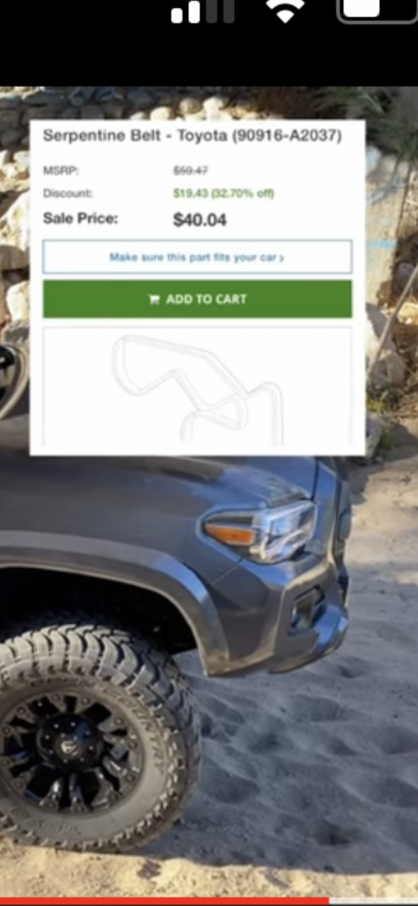

  7. Apr 28, 2022 at 5:08 PM
    nightcrawler
    nightcrawler Well-Known Member
    Apr 8, 2009
    #15733
    368
    ‘17pro
    Recently watched this video and they mention updated belt from Toyota 1C84E22C-A889-4B4B-83AB-FB8A6F894A9D.jpg
