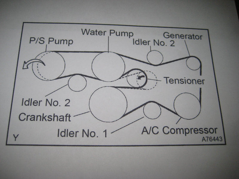

    I assure you it hasn’t been running on the wrong side. I look at that diagram and make sure I get it right every time I put a belt on
