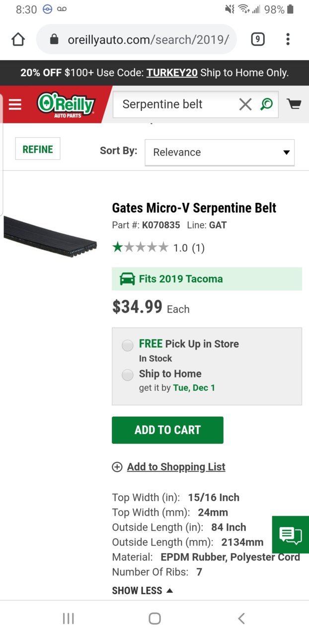

    My 2019 TRD offroad was squeaking real bad as well at 18k miles! I replaced with a Gates belt and it went by to normal. Idk if I should be worried or not about the premature failure.

    That's what I'm thinking. Is it normal for the upper idler pulley on driver side to wobble a bit? I seen other forums that said it's normal can anyone confirm?

    Normal. Completely.
    Never had a vehicle that had an idler pully that appeared stationary while rotating.

    True ... If the pulley were wobbling side-to-side ... Like a bearing going bad... you've got a prob.
    Keep in mind there is a difference between an 'idler' pulley and a 'tensioner' pulley. The tensioner pulley is spring-loaded to keep the belt tight and you will see some 'bounce' to it. But just an up-n-down thing.
    I will say though that back in the day, I bought a new Dodge van ... 95' .... And after about 10k miles it started squealing.. I could have taken it back to the Dodge dealer and wasted all day.. But I just bought the best Gates belt there was at the time and replaced it myself. 100K miles later, it's still going good.
