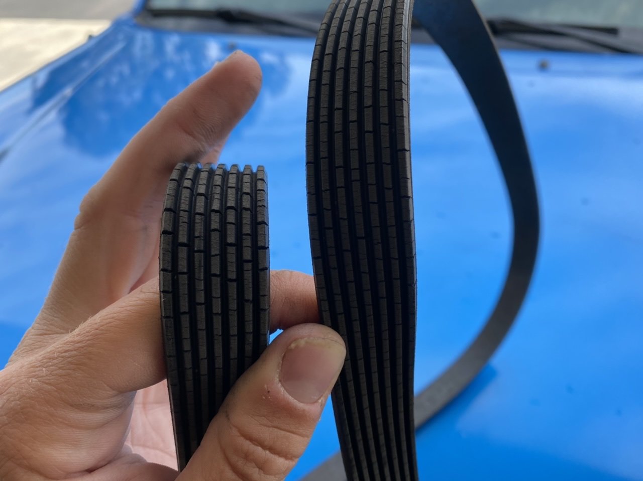

    Just replaced mine. A little more than 125,000 miles, belt would squeak a little on start up on cold/wet days.
    holy cow is it easy. I was a little worried that I’d mess something up but it literally takes 10 minutes. Just be sure to have a diagram handy for putting the new one on.
    Old belt, cracks don’t look to bad? What do y’all think?
    belt off
    allen wrench to pin back the tensioner
  7. May 7, 2022 at 4:39 PM
    #47
    burrito782
    burrito782 Shit Throwing Ape
    Aug 23, 2014
    #136771
    940
    08 TRD Off Road
    Seen worse, but you did right by replacing it. Think I replaced mine somewhere around 150~160k as preventative maintenance.
    On a separate note, in that 2nd and 3rd pic looks like a build up of oil/sludge.

    Yeah it’s power steering fluid… it’s on my list lol.

    Here is mine at 187,450 miles. Replaced it with a $20 Bando belt from eBay yesterday.
    It took about an 30 mins, and wasn’t that hard without pinning the tensioner back.
    Changes since the job:
    A little less enthusiastic startup. Probably from the friction of the new belt. It still sounds fine, but it used to rev higher, so the old belt probably slipped.
    Quieter idle.
    New tick sound from behind the glovebox. It’s reproducible when decelerating from 10 mph and with the foot on the brake in D. AC on/off is the same. The RPMs at a stop sign were dipping below 500 and it felt like it was going to stall, so I put it in N and revved it.

    Damn! Thanks for posting the pic. Way more cracked

    Update. The engine is as normal again. No more low RPM idle or ticking. Motor is quiet and everything feels great.
