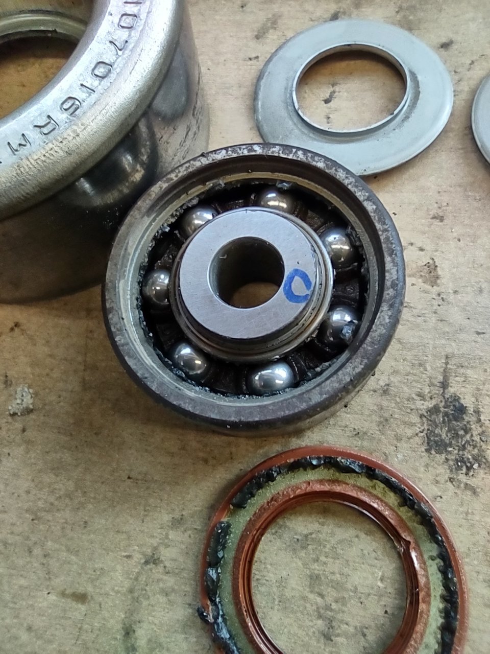

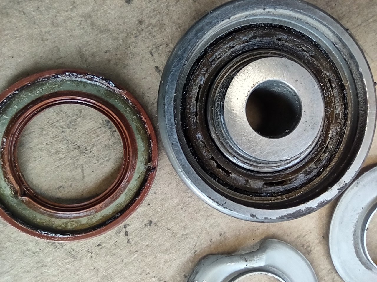

    Here is the failing bearing after I pressed it off the pulley.
    There are two metal shields, two rubber shields, and a single row of balls with a plastic retainer. There is not a lot of grease and a bit of super tiny metal pieces. The bearing is notchy, dry feeling, and makes noise.
    You can buy the new "deflection bearing" by itself;

    Was there a number on the bearing?

    Tried the eBay link for the bearing but it came up not found. My SR5 is 3 months old with 3986 miles. Been to the dealer and they used the note in the manual stating that wobble is normal to say mine is normal. I asked about the squeaking/screeching at startup and because they couldn’t replicate it ( no shit dumbasses the truck is warm) they said there was no issue.
    Ive been all over eBay and literally found hundreds of bearings. If you have the time can you repost which bearing you used. Thanks.

    You can't buy a Toyota OEM bearing, you have to buy the pulley.
