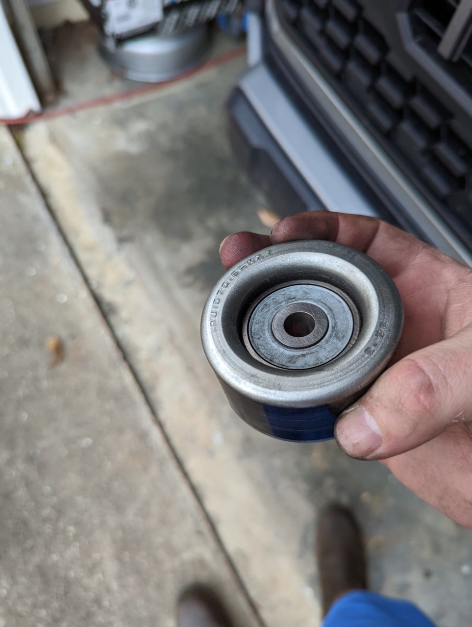

    My squeal got worse today and the gates replacement came in the mail. roller felt fine in my hand and rolled smoothly but the squeal is gone so this was the culprit.

    Belt squeak came back after 10 miles. guessing its the belt now. Thats atleast my next course of action. Hard to believe 44k miles is as much as you get for quite operation out of the belt.

    mine starts squeaking at 2k rpm i dont mind throwing a belt on it and then checking the idlers while im there

    so far its not making any noises anymore. Im just going to have the belt on hand for when it starts squeaking again. i did go on some dirt roads weeks before the squeaking started so maybe the belt had more dirt in the grooves and caused it to slip a little.
