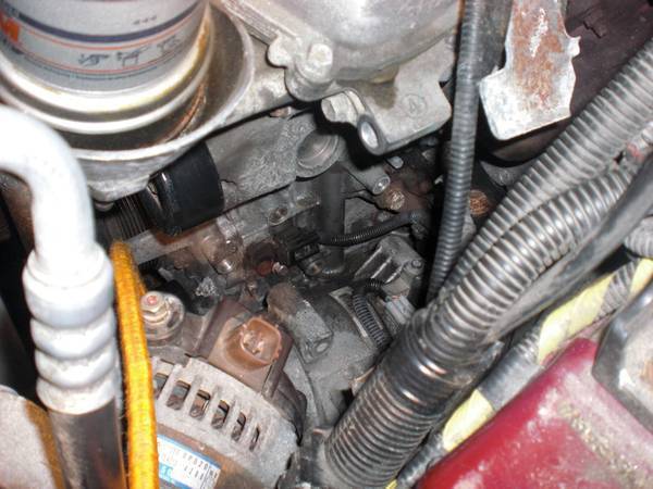

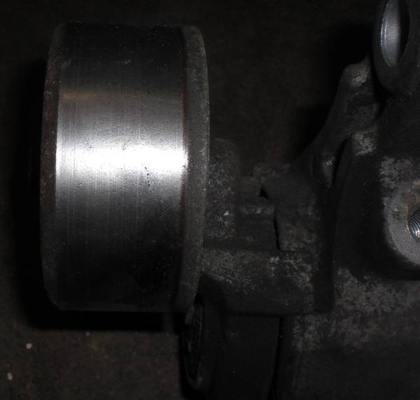

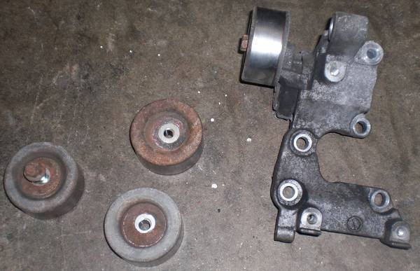

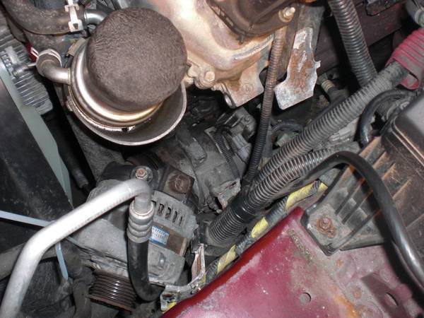

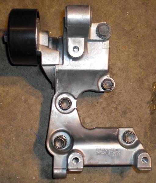

    [​IMG][​IMG][/url[​IMG][/url[​IMG][​IMG]
    Here are some pics of the new tensioner the old tensioner & idler pulleys and also the spot you have to work with to move the alternator & compressor. The new idlers were already on the truck so I did not take a picture of those but you can see on in the engine bay shot.

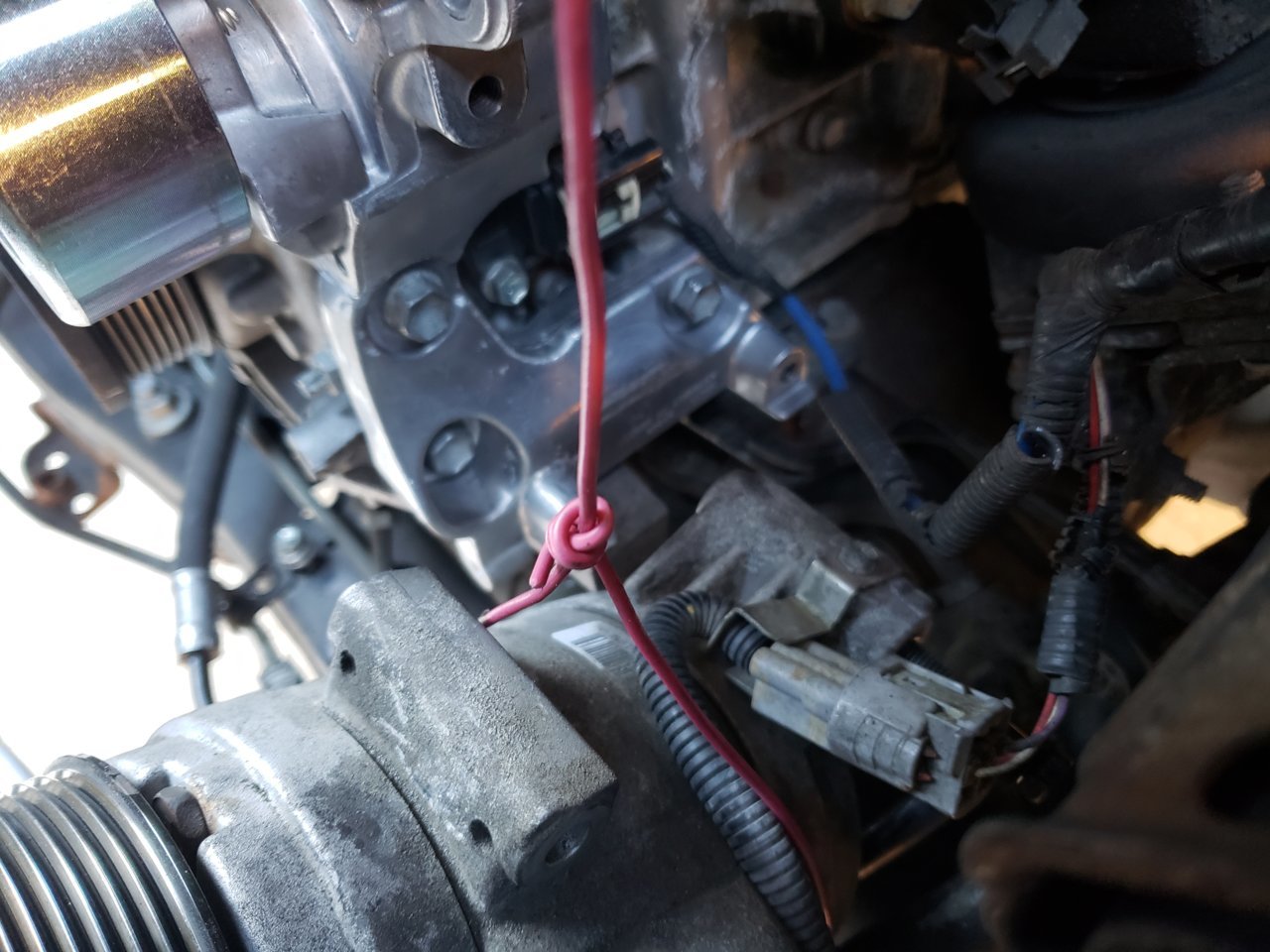

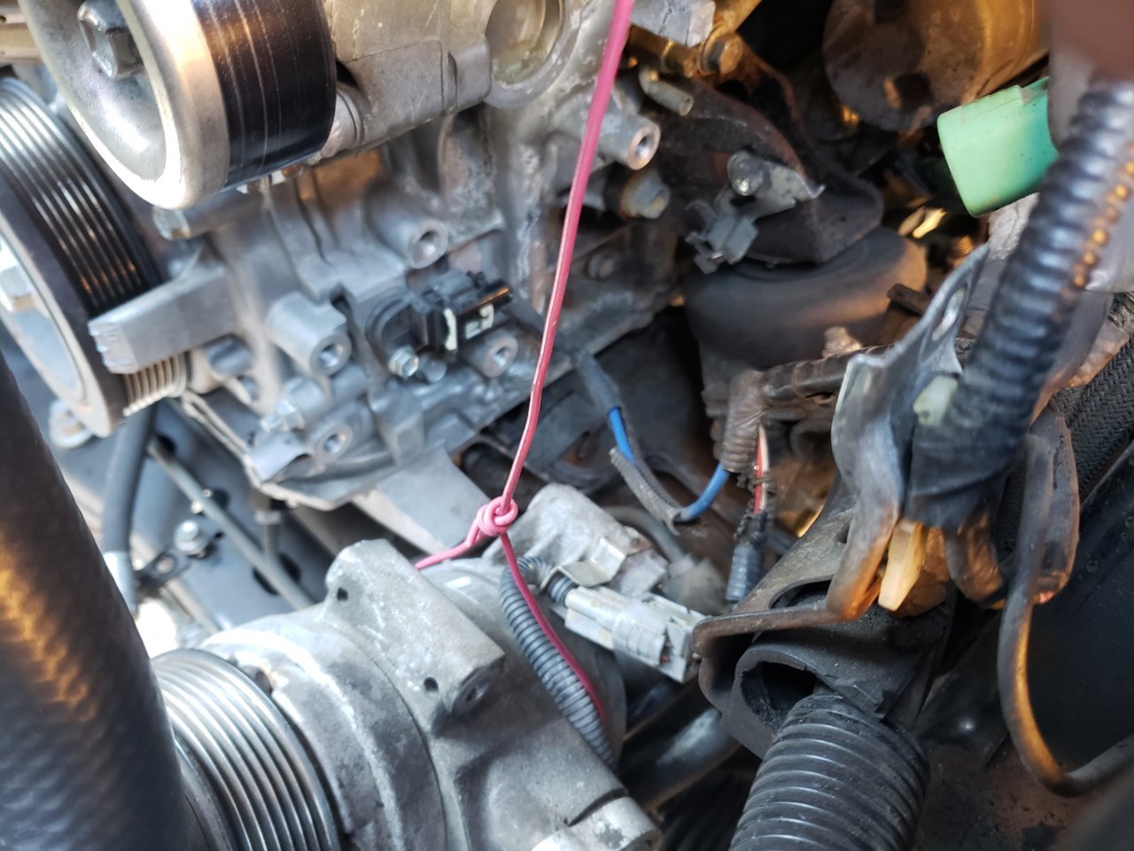

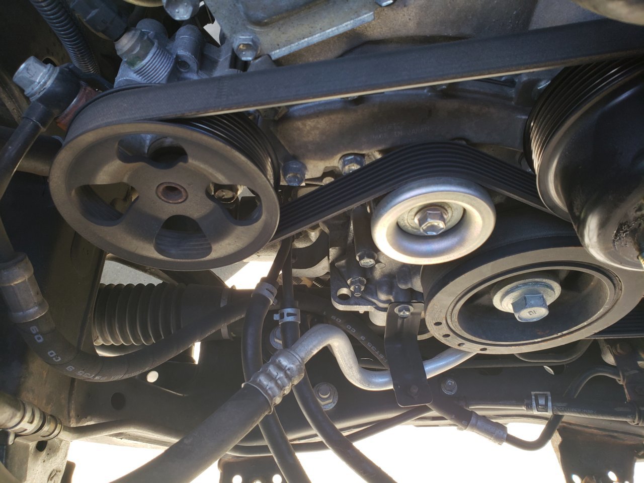

    My tensioner was making a chatter noise on my 2013 Tacoma.
    1. Remove fan shroud and fan
    2. Disconnect battery
    3. Use 1/4 drill bit to remove tension on serpentine belt
    4. Remove alternator ( note 2 screws hold wire harness clamp on outside of alternator)
    5. Disconnect air condenser (4 bolts two top two bottom hold in place with wire and disconnect wires)
    6. Remove four bolts holding tensioner to block
    7. Attach new tensioner ( 27ft lbf 36 Nm )
    8. You might want to replace #2 and #1 idlers
    #2 29 ft lbf20181226_134738.jpg and #1 40 lbf
