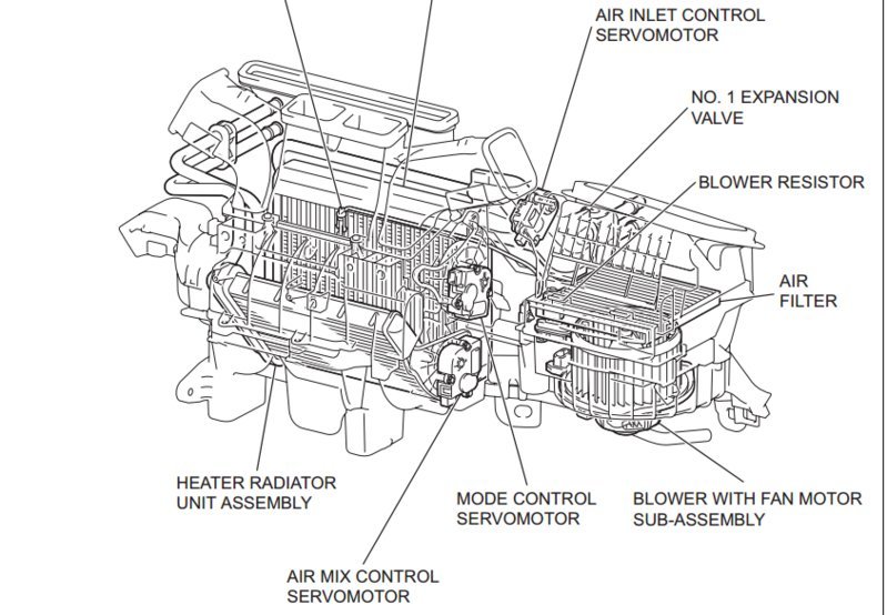

    Brand new tacoma owner here. I bought an 08 tacoma...where are the servo motors for the outlet?? any pics? 08 tacoma air will not switch to different positions. only defrost position

    You can thank @Jimmyh
    I borrowed his picture.

    Mode control servo in image above.

    Where does this pic come from? Def not from chilton

    It’s probably the OEM diagram.

    It is from the Toyota Shop Service Manual.

    I don’t know how hard it is to get to?
    If it is not too bad, maybe pull it out and see if it’s just jammed?
    My mothers Honda Pilot gets stuck sometimes.
    If you fool with it long enough it “unjams” itself.

    undo the glovebox and it's rite there on the left.

    The only one that is hard to get is the Air Inlet Servo.

    The last number I have is 87106-04050.
