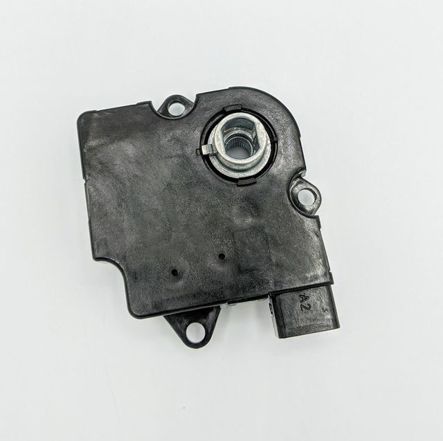

    So do I have to set the correct position on the dial and then install the servo motor
    Or just slap it in and it’ll take care of itself ?

    Wondering the same thing, I'm still waiting for delivery.

    The shaft has flats on it and it will only go on one way...

    It looked like just a square hole on the servo in the pic.
    I hope your rite Jimmy.

    That sucks , I just got mine but haven’t put it in yet .
    So the square in the servo motor should be at the right position ? I shouldn’t have to manually rotate anything ?

    Two sides are flat and two sides are rounded.

    Update :
    so I got my part in the mail and went to replace it today , taking down the glove box I was checking to make sure it was the correct part number and looking at it . So I realized it was unplugged :rofl: I unplugged it last time I was in there trying to fix my OTHER problem . I broke the green wire :anonymous: trying to disable the compressor kicking on when you switch it to defrost (which is a mod here ) . So if anyone knows how to get the connector out of the harness (is there a special way ?) that plugs into the servo motor I’m all ears ? :rasta:
    so now I have to try to return the servo I got
