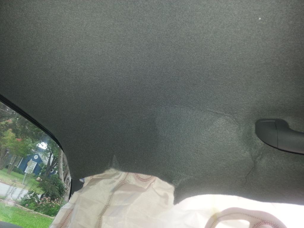

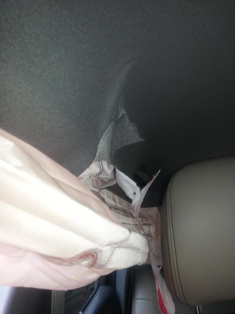

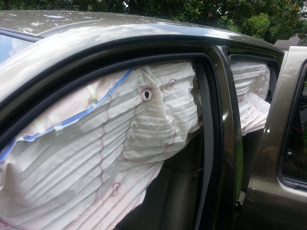

    Was working in the interior of the truck, had the radio on and didn't have the battery disconnected. Hit something (not sure what) and
    set off the curtain air bags - both sides tripped. Headliner is toast too.
    First- learn from my stupid mistake.
    Second- any idea how much this will cost to have them replaced?
    Got the insurance claim in already.

    Was adding some Mass Loaded Vinyl on the floorboard of the passenger side. Seat was in, hit something around the wire harness under the door sill when it popped.

    theres a sensor in the b pillar for a side impact and if you hit something around it hard enough it will set the bags off.
    the system will only go off when the key in the ign and in the on or acc position fyi

    Stay away from any thing yellow it's wiring for the air bags.

    Someone with no experience, does work on a vehicle and blows off the airbags and you want to have the factory fix your screwup. Rule #1 is disconnect the battery while working in the interior of the vehicle. Why????
    Because 999 times out of 1000 nothing will happen. It's the one time and this is the result.

    You don't need to be in a collision to set off bags you short voltage to an air bag circuit it's going to pop glad you didn't get hurt bags are dangerous
