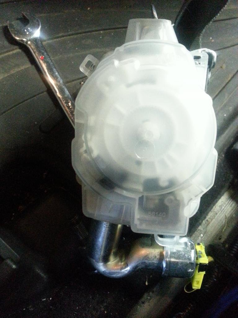

    And the drivers side seat belt is locked up too. Also FYI, Driver and Passenger seatbelt mechanisms are different.

    Not saying this is what it is but the seat belt pretensioner might have gone off also.

    That's been blown too.
    Needs replacement
    The sensor should be also.
    Need to check the wiring really well. Se if the wiring was pierced
    Check the other belts also.
    This really sucks.
    There could be thousands of dollars of damage here.
    Every component needs to be examined.

    I just took a better look at the picture and it looks like the belt is on the floor mat and the connector to the pretensioner is still attached. I see what looks to be a wire wrapped in there. If this is the case, the pretensioner harness is ripped out?????
    If so the interior harness is ruined and needs replacement. No replacement connectors are available
    IMO you need to stop playing with this.
    I've seen this lots of times. You can be causing more issues and not helping your cause.
    Take it or not.

    Like I was doing that on purpose? Really? This isn't a conspiracy bud, and not sure what you are implying there.
    I really don't know what I hit. I was fitting a large piece of MLV in the passenger side floorboard working from the outside over the door sill. I guess I pressed up against the wire harness under the front sill or something when it went off. As posted above, there are sensors under the sill, near the base of the B-pillar, had to be that.
    I've gutted the entire interior to install sound damping and revamp the audio, have had all these panels out multiple times and was just finishing the last thing I was going to do on it.
    Issue was the key was in the 'on 'position to kill the door chimes and had the radio on, should have had the battery disconnected.
    Think I feel good about it? The only reason I posted was so people would learn from my mistake.

    Yesterday, I called insurance and one of the questions was "is it drivable" which I had told them "Yes".
    I took a bunch of pics and uploaded them to the insurance company. I got the floor finished, re-installed all the trim, tucked the airbags up under what's left of the headliner and made a drink (or four).
    Came out this morning and noticed the driver's seat belt was locked down against the side of the B-pillar. W/O seat belt, its not drivable. So I took it off to see why it was locked up and saw that there is a charge in the mechanism that apparently goes off when the airbags trip. There aren't any wires wrapped around it, its just laying on the floor board. Took pics and uploaded them to the insurance company, told them the adjuster will need to come to the house.
    I then took off the passenger side trim to see if the seatbelts were interchangeable (they are not the same, may work but wouldn't chance it). All that trim will need to come off to replace the headliner anyway so I don't think I'm really messing anything up. When I get it fixed, I will probably remove all the interior trim anyway and let the dealership do the headliner and air bag replacement. There is deadening under all the interior panels and the trim panel fitment is tight. Don't want those guys telling me they can't get it back together so I will set it up for them.
    First thing I will need to do Monday is get a seatbelt for the drivers side.
