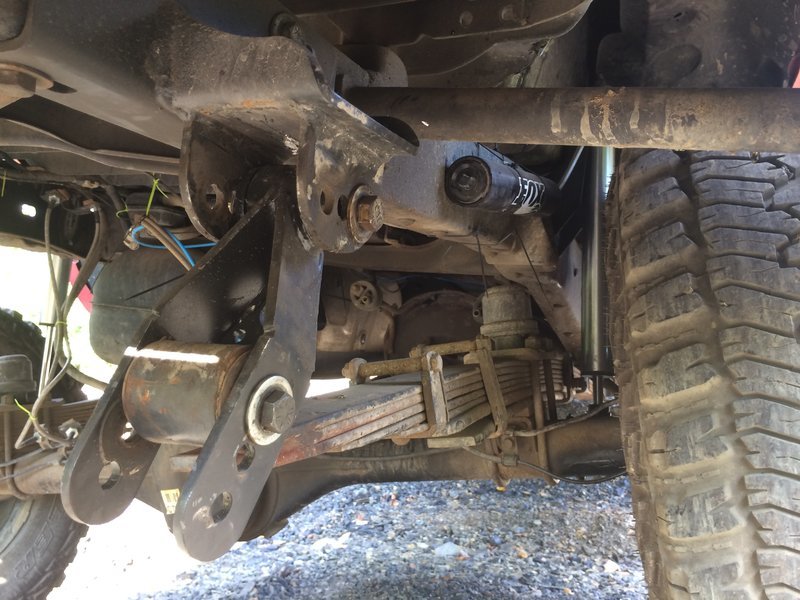

    Holy shit finally got around to putting the relocate kit on. It's awesome except my leafs are almost flat while sitting on the level. So when I start flexing they go in the negative. Not super bad but the bumps are like 1 1/2-2 inches away from making contact. So now my question is so how negative is too negative. And if I'm rarely there will it be that bad? My leafs are about 2 1/2 years old. image.jpgimage.jpg image.jpg
