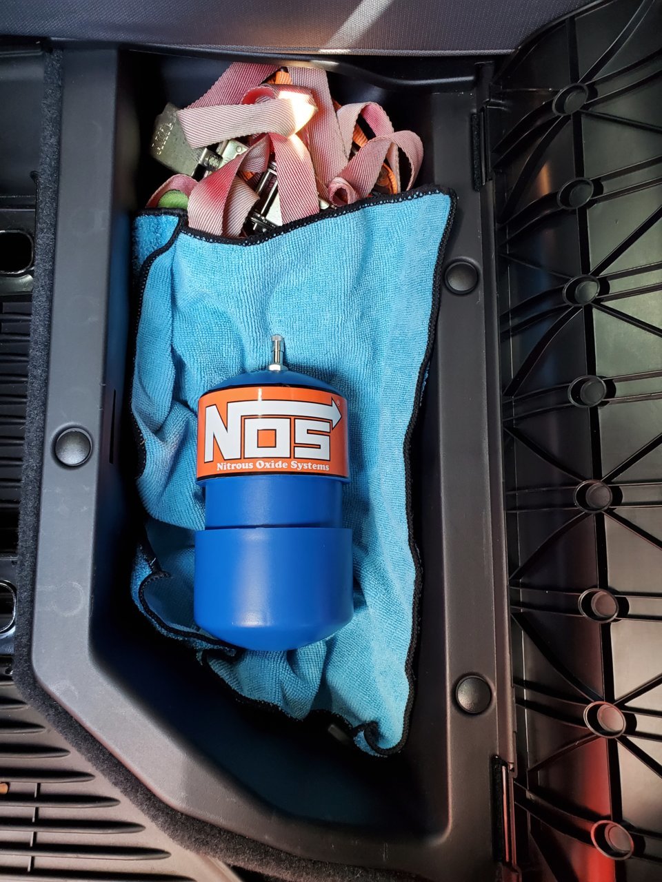

    You build a pressurized canister like this one...shove the sensors in there, pump it up to 32psi, throw it under the seat and forget about it!
    Costs about 10 bucks. Lots of videos on how to make them.
