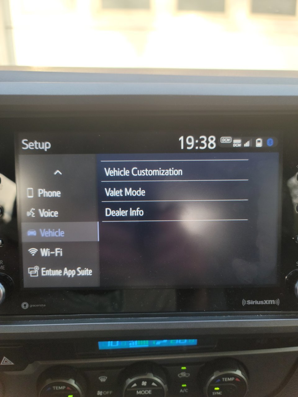

    Does anyone know of an aftermarket or different head unit that has the ability to change the same functions as the original head unit does? Please see enclosed pics of my stereo.

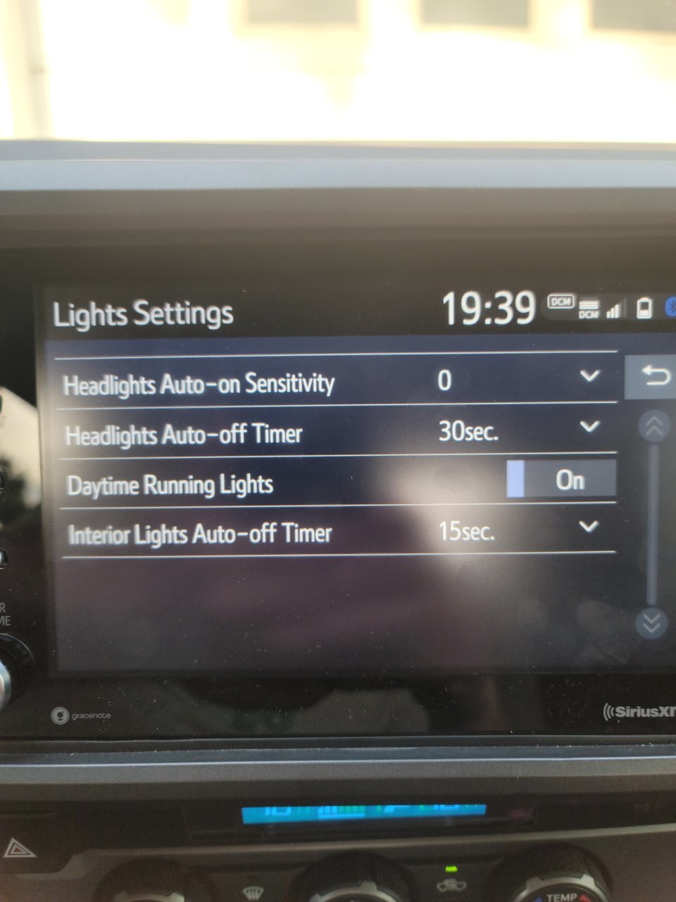

    sub screen

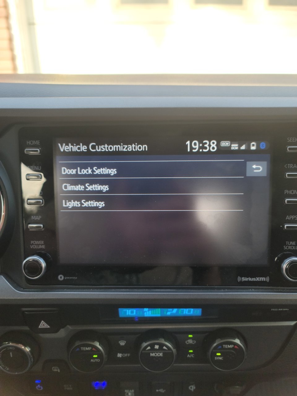

    another

    I think you lose out on the ability to change those settings if you go with an aftermarket unit. But you can set it at what you want and keep it that way and then change the head unit out.

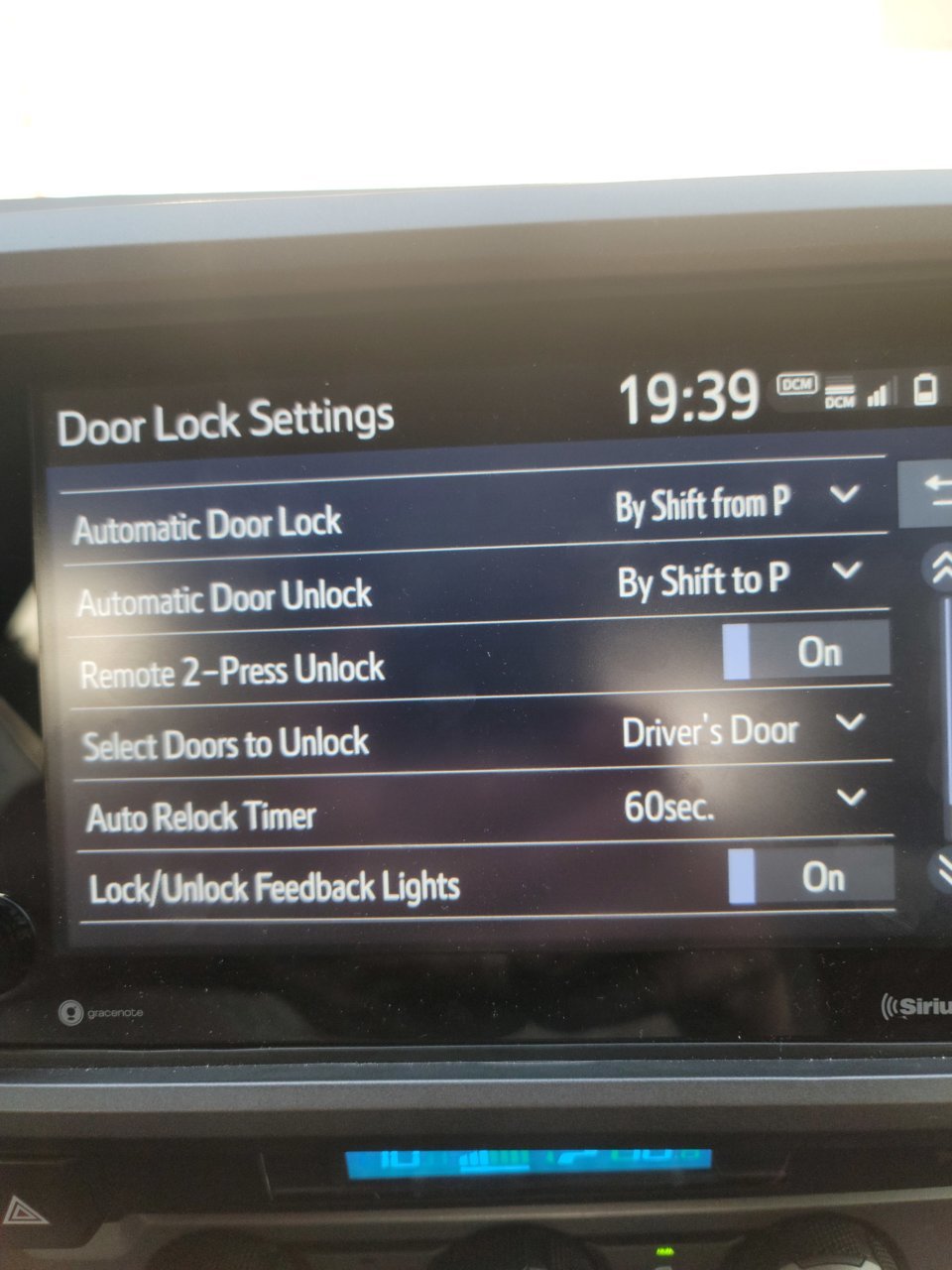

    and one more..

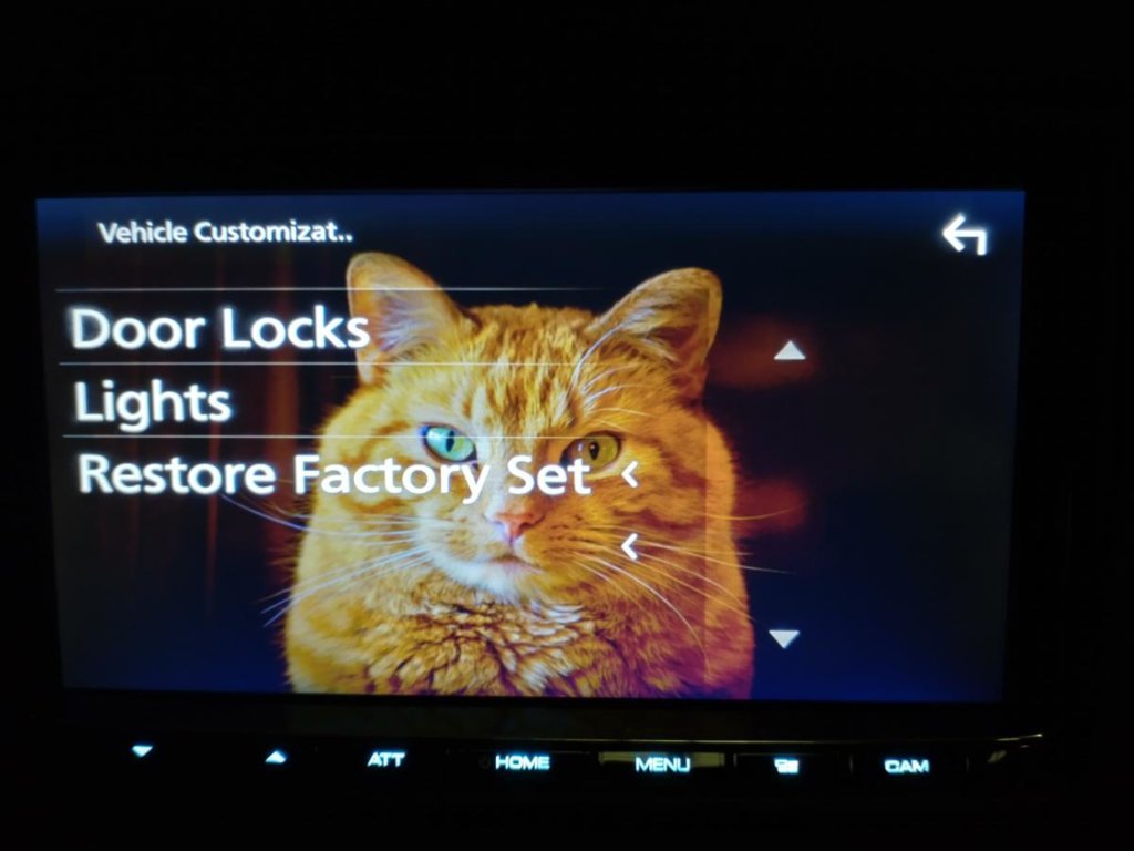

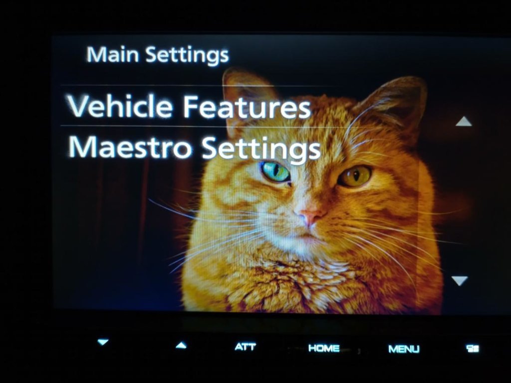

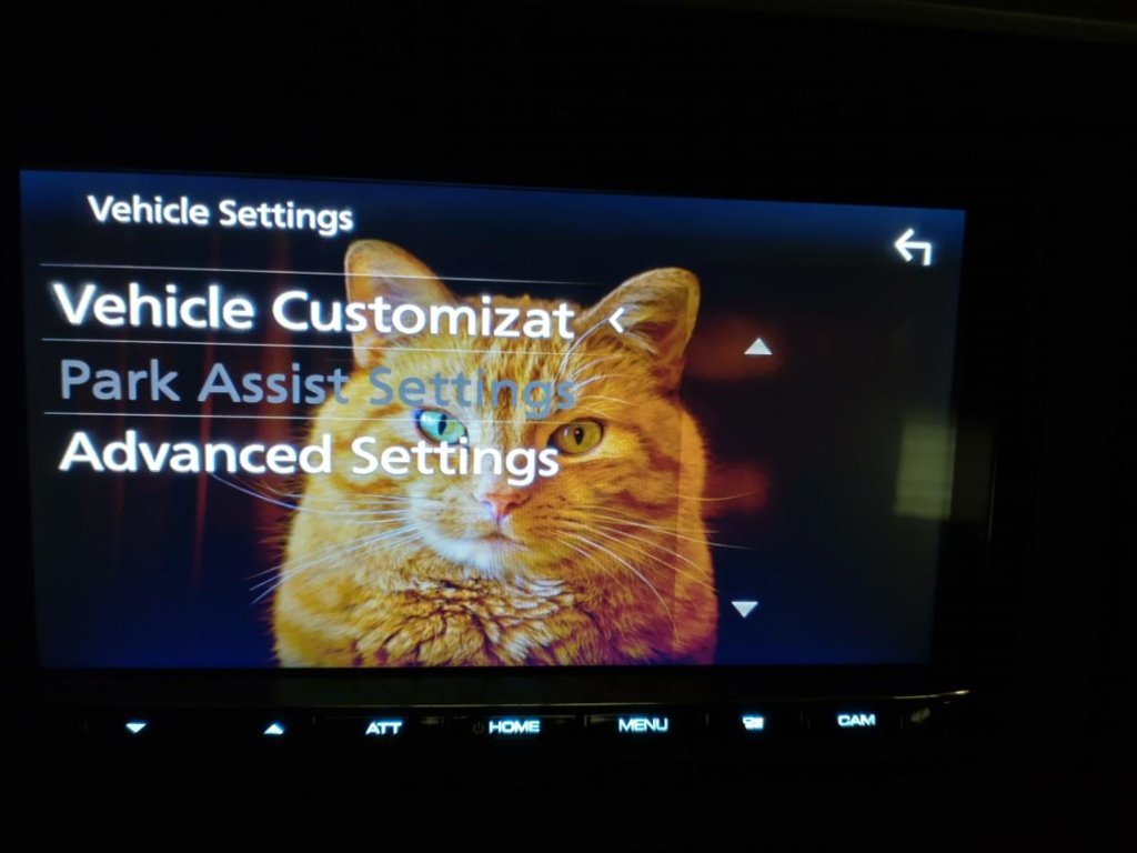

    I'm a little late replying but yes, you can get an aftermarket radio capable of changing vehicle settings like the OEM does. You will need an idatalink maestro to connect the radio with the trucks computer which you'll also need to keep your steering wheel controls.
    I have a Kenwood DMX907S but most any higher end aftermarket radio should be good.
    Pics:
    Edit:. That's my cat, Hobbes, as my wallpaper. You can use something else.

    That is pretty cool.
