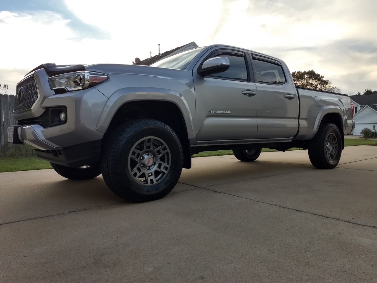

    I did bilsBils 5100s front and back, added some 265/70/17 SL Toyo open country at2 tires on some 4runner sema pro wheels IMG_20181009_175704107_HDR.jpg and it rides amazing, handles way better that my stock Sport suspension. I can take a curve a lot better, gained a nice 2.5 inch lift in the front and a inch block in the rear. Didn't break the bank, looks great, like it came from Toyota this way.

    Not 100% true, I have a nice lift, rides better and corners way better than stock. I thought the same thing until I had the 5100s installed with new tires and wheels.
