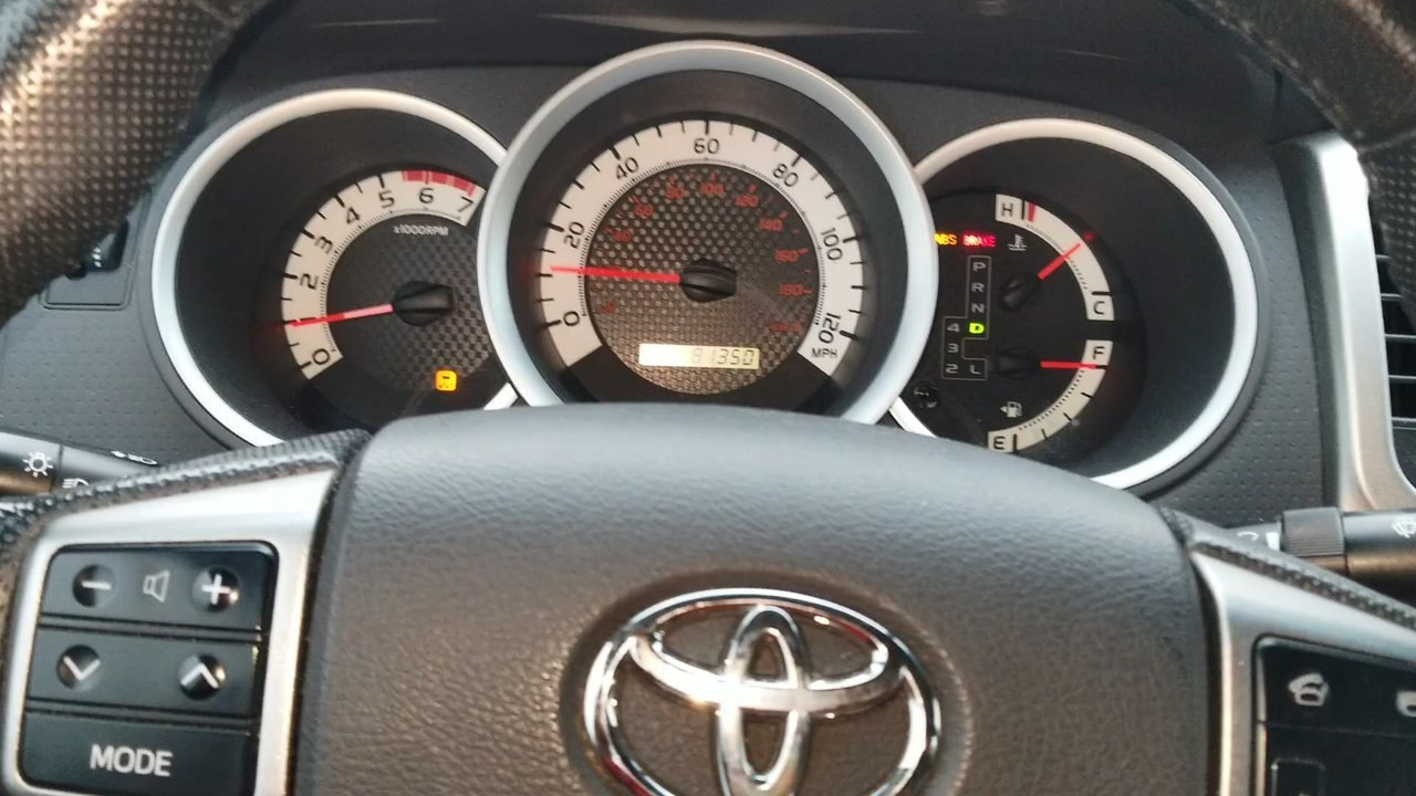

    Has anyone had there dash lights coming on and the rpm and speedometer tach's going crazy while driving? This has happened before then went away, now it's back. I couldn't find anything concrete on here about it.

    Check battery connections

    They looked fine but I will recheck.

    Make sure they are tight

    I think you nailed it man, positive side was loose even though the voltage meter was reading normal. Thanks desertrunner24!
