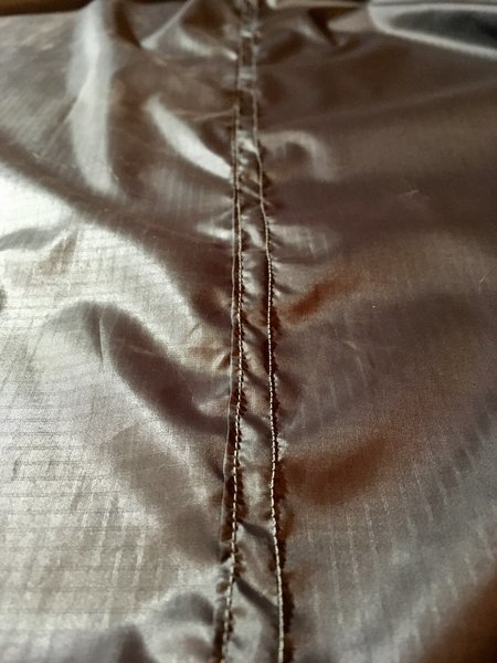

    The first seam is done! Spent a good chunk of today relaxing as I went shed hunting yesterday (unsuccessfully). Then started practicing flat felled seams on the extra fabric. Decided to up my seam allowance from .5 to .75 as it was difficult to roll the extra fabric. Almost wishing I just did 1" now. I found that using the iron on low heat works great for prepping the flat felled for sewing. Going to eat some pizza and then slowly start ironing out the rest.
    I will say this. Silpoly is wayyyyy easier to sew than silnylon. Hoping it works well for the tent, if it does I won't be getting silnylon unless I need it to stretch.

    Pretty dang happy with the first flat felled seam. They take a while but it wasn't nearly as painful as I thought. I could see how someone would enjoy doing this for a job.
    Hoping to get the other sides completed tomorrow and maybe start putting them together. We will see.

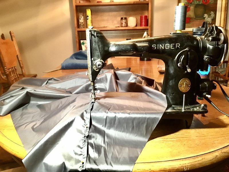

    Nope, not sure I can do that with my machine or get this fabric to behave for it.

    You're putting way more effort in than I did on my shelter lol. I just wing my flat felled using that method I showed earlier. But at least with that method it's 1 solid piece that needs to be sewn flat, not 2 separate diffferently sized pieces that need to be effectively hemmed.

    Yeah, it's been more work than I had thought but the quality of the flat felled seam is exactly where I want it.
    I already know this pyramid shelter will have flaws. Once this is complete I plan on ordering new material and restarting. This one will be getting sold. I am hoping the craftsmanship overpowers the design flaws.
    Not to say your flatfelled seam is bad, it's just easy to get a "perfect" seam every time this way.
    Pinned the other three sides this morning and stitching them together tonight. Hopefully the zipper is easy to work with.
