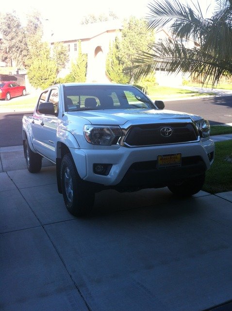

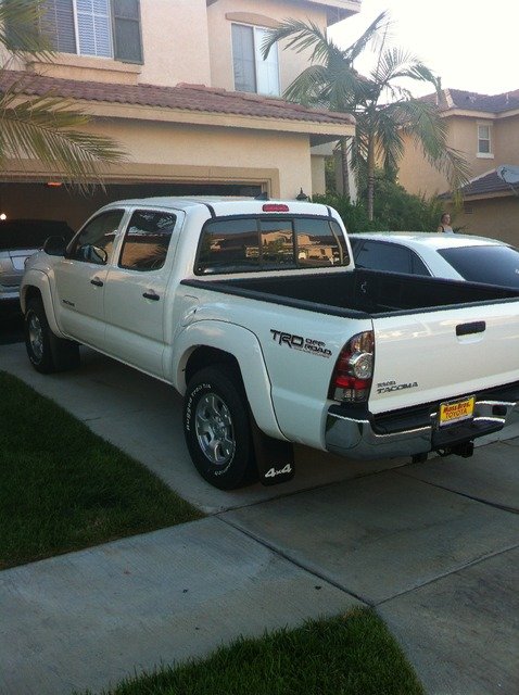

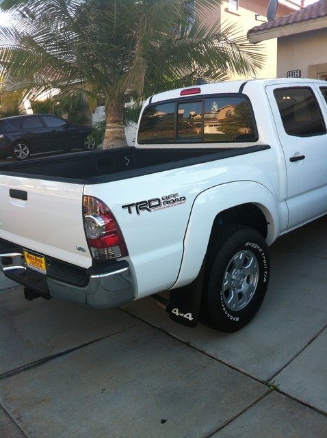

    New from the Showroom
    How it sits today

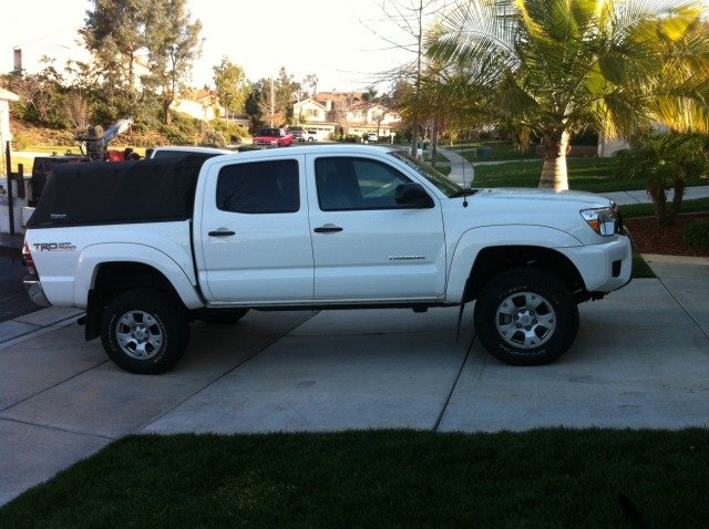

    Bed Cover:

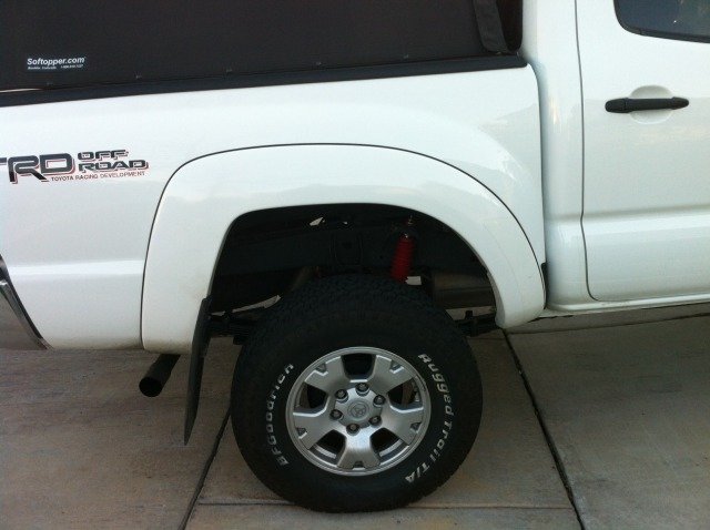

    The very first thing done was to add a Soft Top from SofTopper in Boulder, CO. This allowed me a reasonable option to put things in the bed of my truck and not worry about the elements while driving to affect them. Nothing worse than getting somewhere to find something blew out of your truck bed.
    https://www.softopper.com/
    Note: The rancho suspension system is on in this pic.

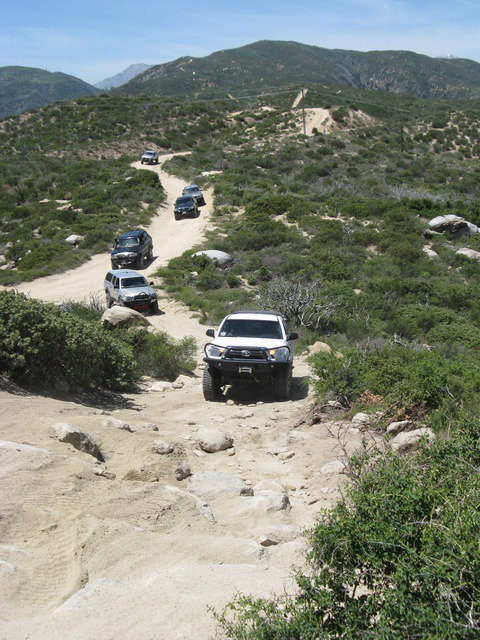

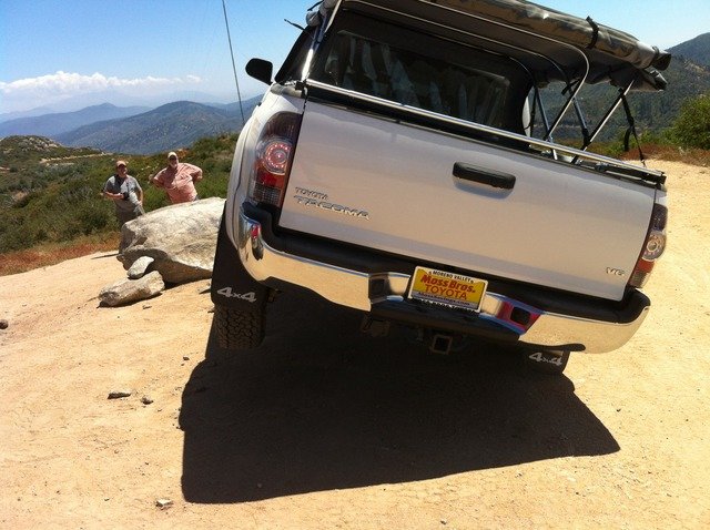

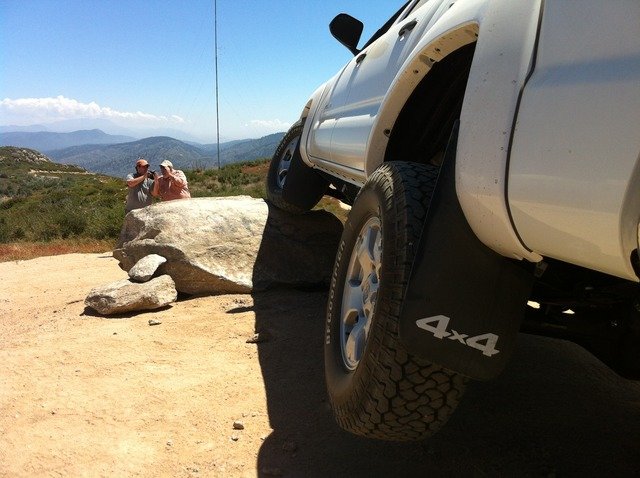

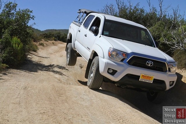

    Stock Wheeling Testing:
    First order of business was testing the ability of the truck right off the lot. This was done to determine its inherent strengths and weaknesses so I could make an informed decision as to what needs upgrading and what doesn’t. Of course needs versus wants would come into play down the road. I was very surprised at this trucks ability off the lot, even with the tires it came with.
    Flex testing:
    It lacked flex lol.
    But it sure didn’t lack traction!
    Clearance was okay, never an issue but approach angle did require some go arounds unless I was to damage the front bumper.

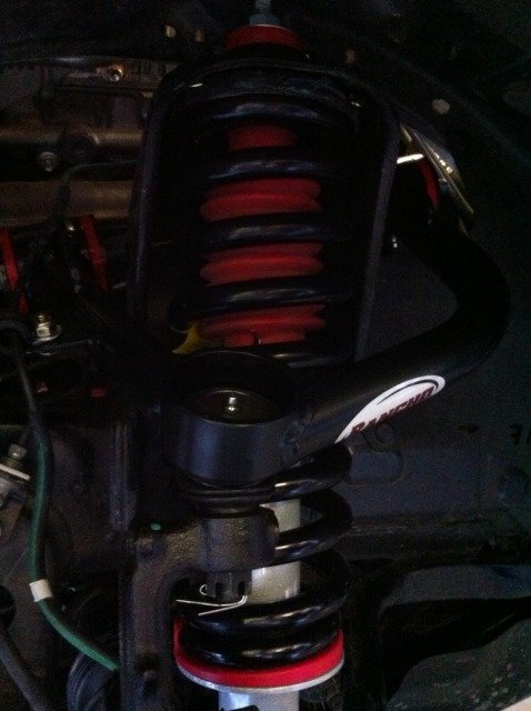

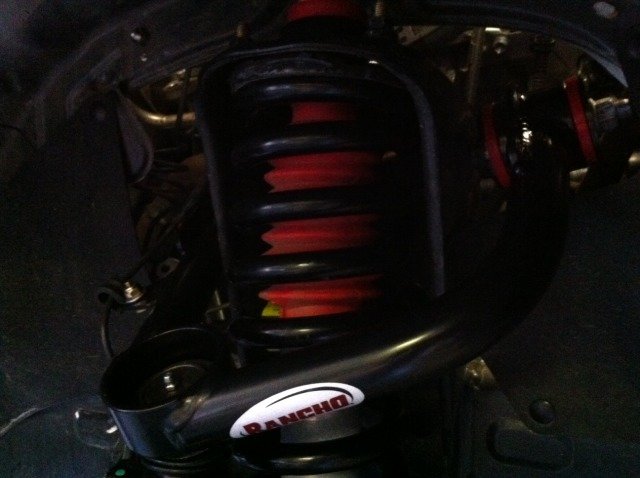

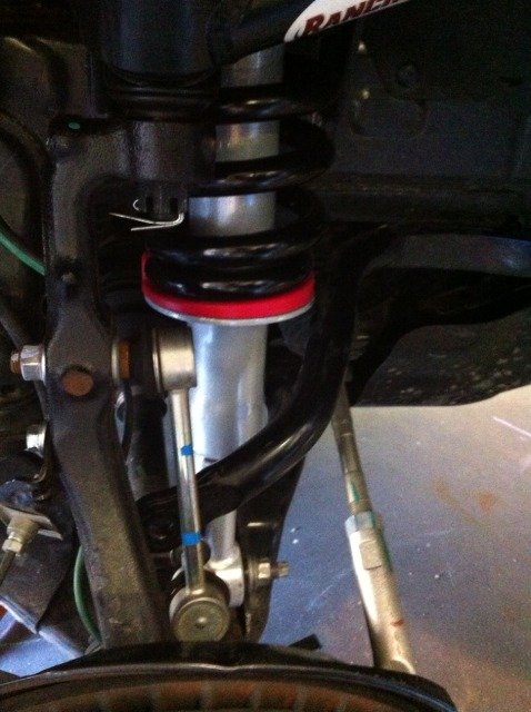

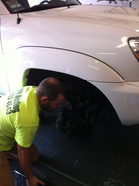

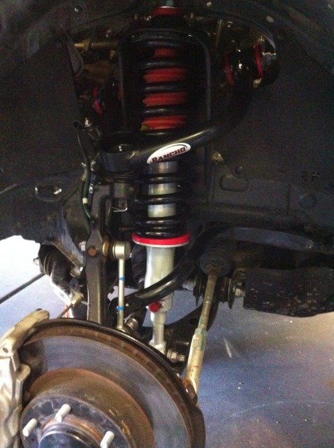

    Rancho Suspension Install:
    The initial rancho kit, came with adjustable RS9000 shocks all around, coils (pre-installed), Upper Control Arms, diff shim kit, and blocks for the leaf springs. We opted to forego the diff shim kit as it wasn’t needed and we also left off the blocks and went with ARB Dakar rear leaf springs.
    We did the install in my garage as part of the evaluation process was to evaluate the instructions that came with the kit and determine if anything could be changed or written better for the end users undertandability.
    First order of business was for us to remove the front suspension.
    Front end system on, at full droop.
    After install was complete:
    The system came out to right about 2.5”-2.75” on the initial install. It would go through a lot of changes before the system was brought to market, as we needed to adjust spring rate etc.

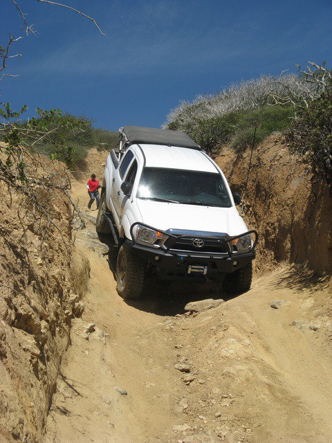

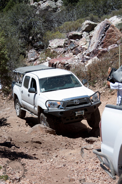

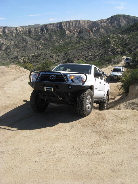

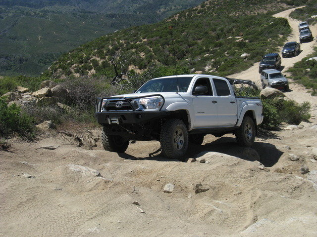

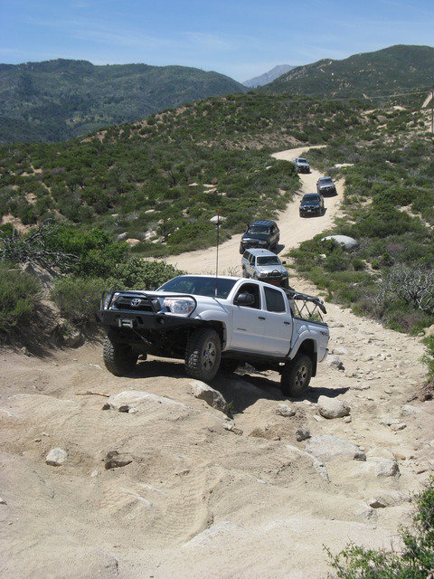

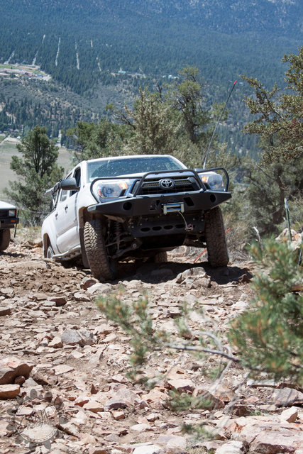

    Adding Armor and removing the Sway Bar:

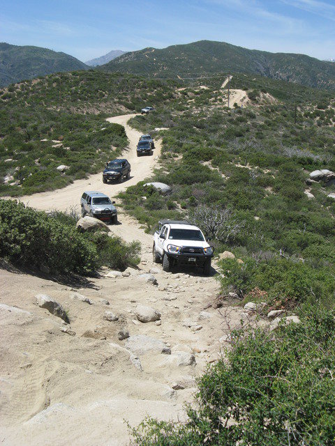

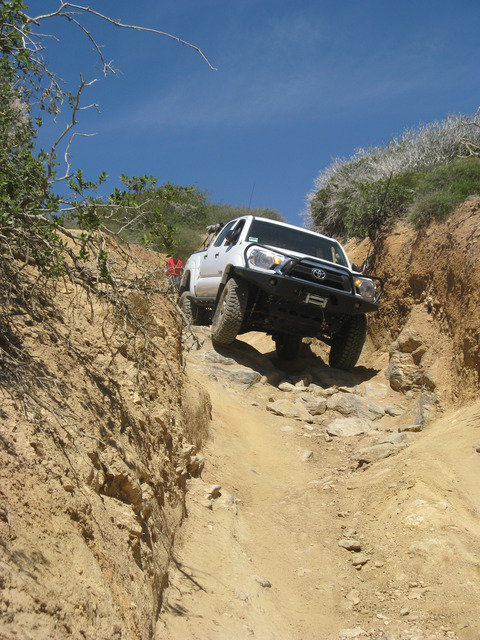

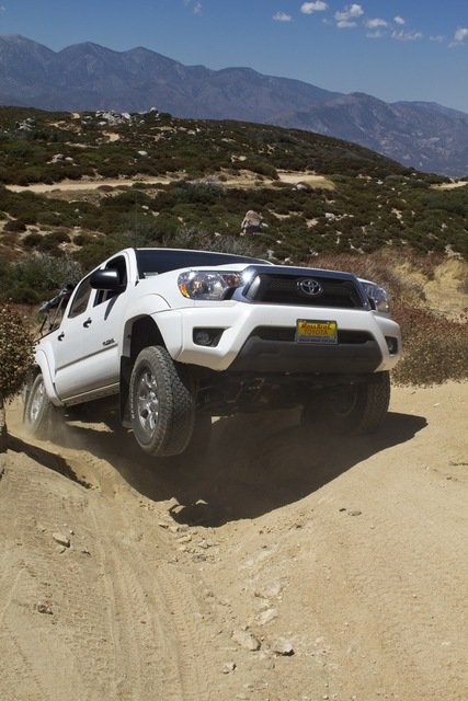

    Once the spring rate and shocks were correct, it was time to test the suspension with armor and a winch. In order to improve the approach angle also while accomplishing protection for the truck I contacted All-Pro Offroad and purchased an Apex Steel front Bumper, sliders, IFS, Transmission and T-Case armor. I had a new Warn VR8000 waiting for the bumper and a set of Maxxis Bighorn MT’s in 255/85/16 which are 33.3” tall. Thanks to a friend of mine the front bumper and winch was installed that night. Under a time crunch to make a run up in Big Bear the next day the guys over at YotaMaster’s in Corona, CA helped get the rest of the armor on in the morning and that same day we were headed to Big Bear with the gang from TTORA.
    It’s important to note that Gold Mountain was previously ran with all stock body and bumpers and all the upgraded suspension previous to this trip.
    In camp as she sat that day prior to running any trails
    big%20bear-50_3872x2581_3832_zpskefy6yqe_0d5cc82564093e7ccd2f8bfb5331c61e7ad7a620.jpg
    Gold Mountain
    big%20bear-118_2581x3872_3852_zpsrj5d8ht_c3e9a3fcc3afee7750ac5ebc513befa9341c92df.jpg
    big%20bear-119_2581x3872_3854_zpsjbnzgqa_881856ca0872a9f57b14a4ac3df0fe17f326b668.jpg
    big%20bear-178_2581x3872_3858_zpso216eym_834812d9f69aa067e6db9fd85de66e9b10d77675.jpg
    big%20bear-177_2581x3872_3857_zps864drge_370714a9e3d7575647362bfc485cda8dc0e963e9.jpg

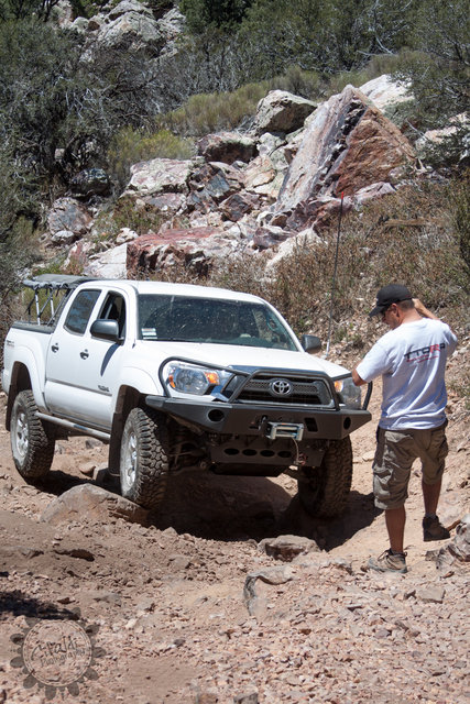

    Everything performed as expected. However we (Rancho and I) did decide to go with a heavier spring rate up front due to the weight of the bumper and winch.

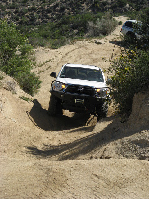

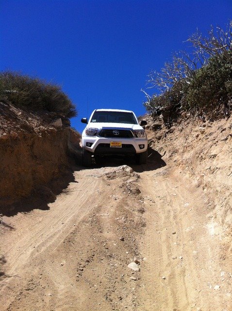

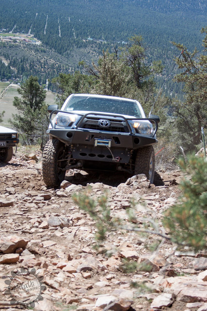

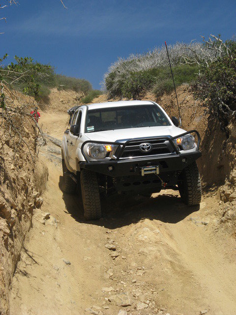

    After the spring rate adjustment we headed over to the original testing area and ran Cleghorn again.
    Initial testing at the powerpole:
    So far so good, couldn’t be happier with the changes we made to the suspension. We did do a couple things also to lengthen the rear flex that is not in the system.
    This was the only trail at Cleghorn I was unable to run the previous trip due to approach angle. As you can see with the All Pro Apex bumper and larger tires this was not an issue.
    Nope no approach angle issues!
    I was still running the stock rear bumper at this point but had no issues so it was a low priority.

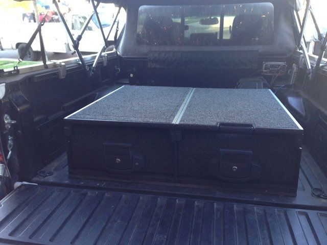

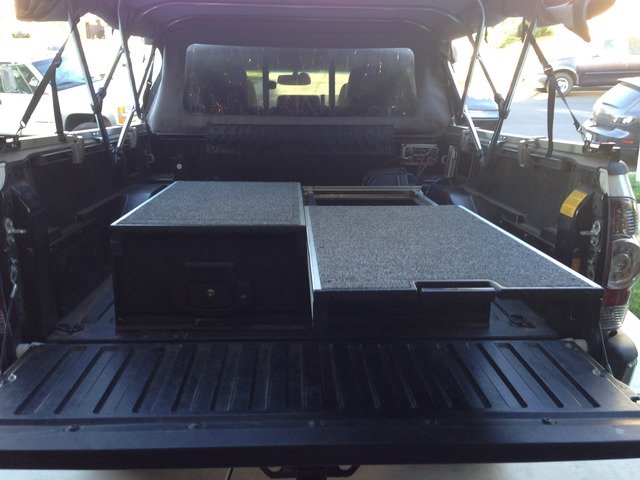

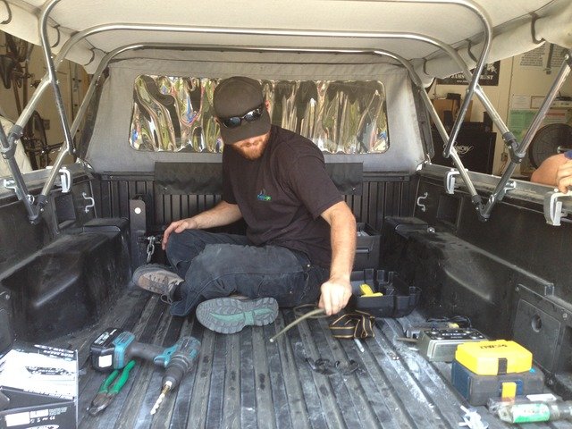

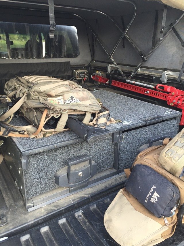

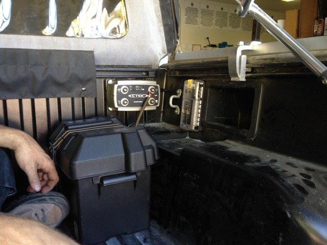

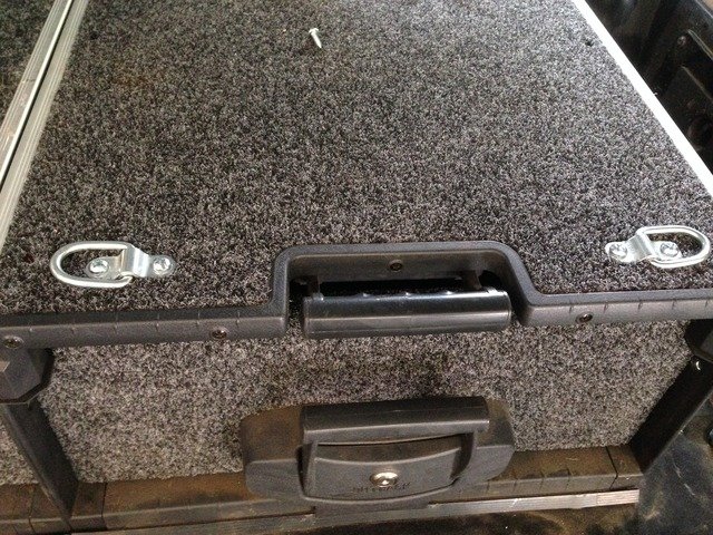

    Now that the suspension and trail armor was up to my standards to be reliable and able to hit pretty much anything I would need it was time to address the usability of the truck.
    We added a set of ARB rear drawers, one with a sliding top for a fridge system, both able to be locked. We also added a house battery in the bed of the truck and used a CTEK D250S Dual for the dual battery controller. The CTEK allowed me the ability to grow into solar power or even charge my truck off of shore power if needed. http://smartercharger.com/battery-chargers/#CTEK D250S DUAL
    009A0040-F342-4325-8987-8D806627C728_zps_af5801b0c0b3628d4df91a9ff8f601488053168d.jpg
    BB5B38AF-4269-4B02-9F39-5D7D42042DFE_zps_8478f141023db418cd9a7ce148995bd596636007.jpg
    3FB98AC6-77C1-4557-BF4E-A502098AFFFB_zps_9c78ca73ae2a2233faeae1899acdf0779d3d8206.jpg
    My buddy Jasen once again doing the heavy lifting on the work on my truck
    7068744B-62E4-47C9-BE4E-EE7D6072B303_zps_6c7100497f30b858ecd9ae6b1d0c8305b2b8395d.jpg
    Installed ARB Drawers
    A269DC2F-37C9-494B-A5B3-BD8D1ECAA662_zps_01d448653afc38e104e5f8fdbf79f145d17c7add.jpg
    7DEA8E01-9821-4780-9AC3-9629752CB6AE_zps_68696417c64fdd2fd1602e5a14f7ad7fa23846b3.jpg

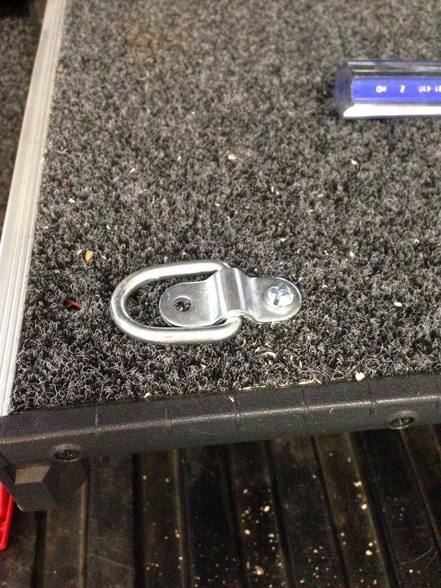

    Added some tie down points for the fridge
    5A0B1CFA-0CE5-4CE6-BEA5-9AA74E660485_zps_3cb9a525f4e9cffc9941a593301bbca9837c03b8.jpg
    CBF7E5C9-56FA-44B2-9196-BC20AD15691A_zps_494098702386789d3e17f12c8ce86ff3712fd01b.jpg
    8C9289F8-D515-4643-91B3-3C079626C896_zps_dc32d53bbc38c5cbe39030787001bf418950da6b.jpg

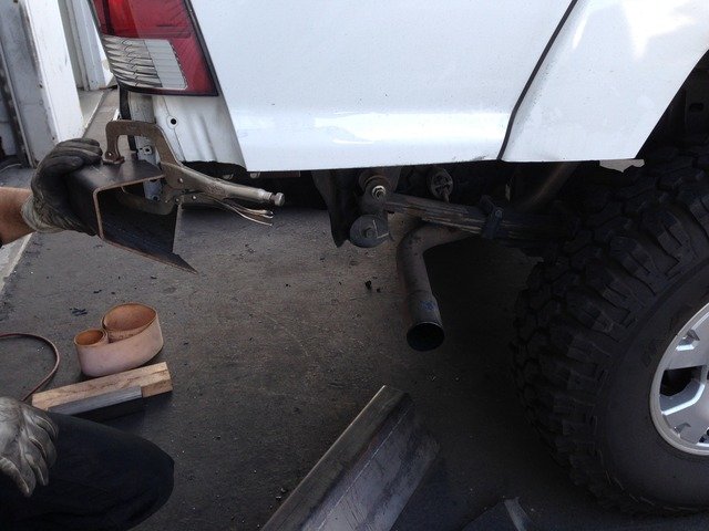

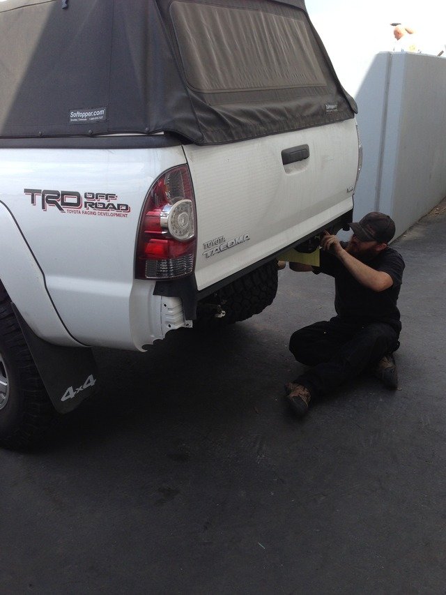

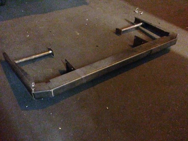

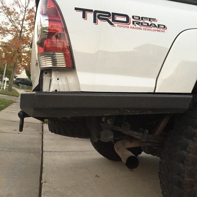

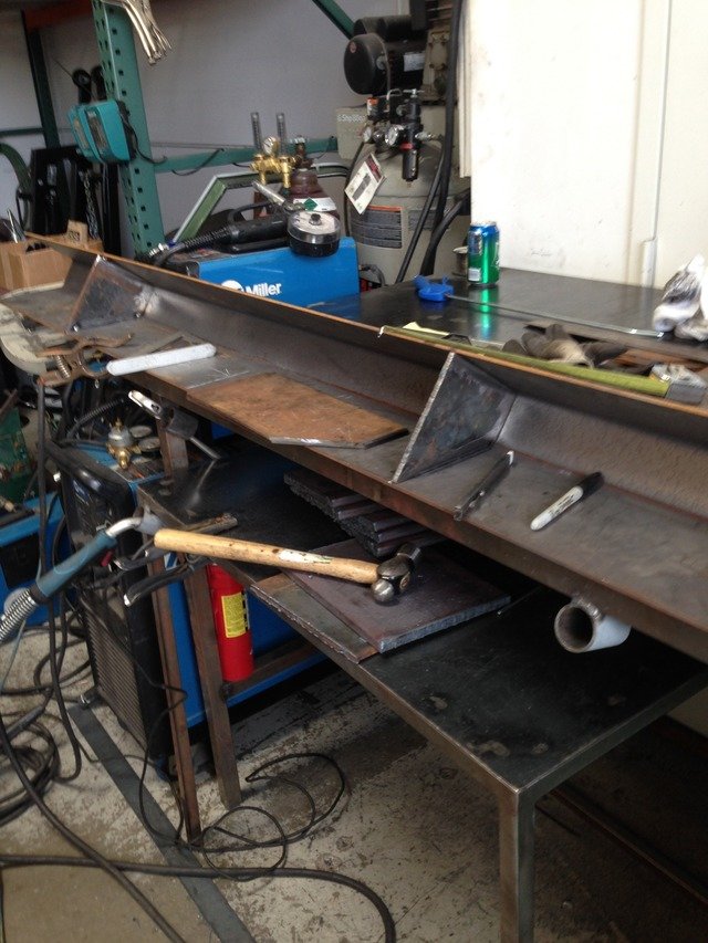

    Departure angle addressed:
    I wanted more clearance in the back of my truck for wheeling and trail work so it was time to design a rear bumper and employ my buddy Jasen and his welding and fabrication ability once again.
    Fabrication time
    1A4E4E4A-6CE2-47D6-BE4F-0B3D580CDFD3_zps_a668d309dccb22fce3199d9cfc9efbeaabf55d92.jpg
    9EE393A2-7D59-4D48-992C-43F13F01ECAB_zps_8ad1f3af543e85a87875670c1a48a0662b6f42e1.jpg
    8D2D5DE5-0DA8-40B6-AB43-34CE9C3C9527_zps_a04d0709e0a82167794e6c1b91c85d95535c4073.jpg
    C7B24E34-B216-40C9-8856-DA3D08C4EC9F_zps_0c66850bd25a34a73fe92265e502c7c15bb67696.jpg
    E936E20A-744E-4D7E-A3A8-A1BEA221509F_zps_c2fe7b8671eaf194dd4ca8bd3bdb4f01d528e647.jpg
    546AEBFC-DF08-48E1-890F-29D20BD73222_zps_4c43d2dc77b8d77727dfc6d6c8e9a8a3fda86136.jpg
    37EEE2E6-F2E1-4ED9-90C4-B35402BD1F14_zps_b750b40cf3a75ab7dfef295911b97800f856f7af.jpg
    0A2D8610-8F19-440C-A5EE-70FCE81CFC7C_zps_c8b37e7538024ddd767ae4873b3096ab5de21e3e.jpg
    2CE31372-C217-4E81-9497-06E685BB2F08_zps_3fa9292e68a52a2453e8e8c1ca4416a2d7f02543.jpg
    8CB0FDD4-3979-4FA6-91C9-6C18E592D215_zps_364916fd87a1f0ff0ca7ea89b9258ed84e30c33e.jpg
    BTW this is posted in the equipment sales for sale currently as I just replaced it with a bumper with a swing out to suit our camping needs.

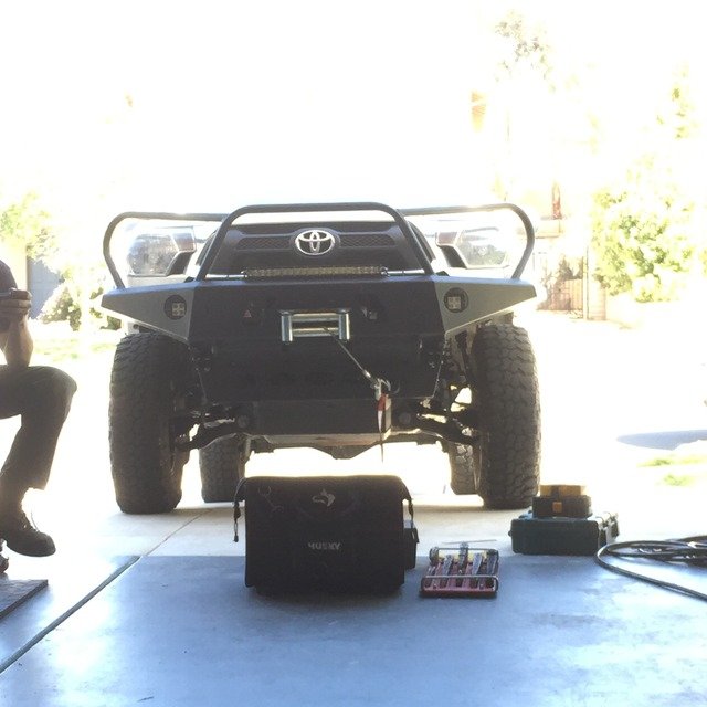

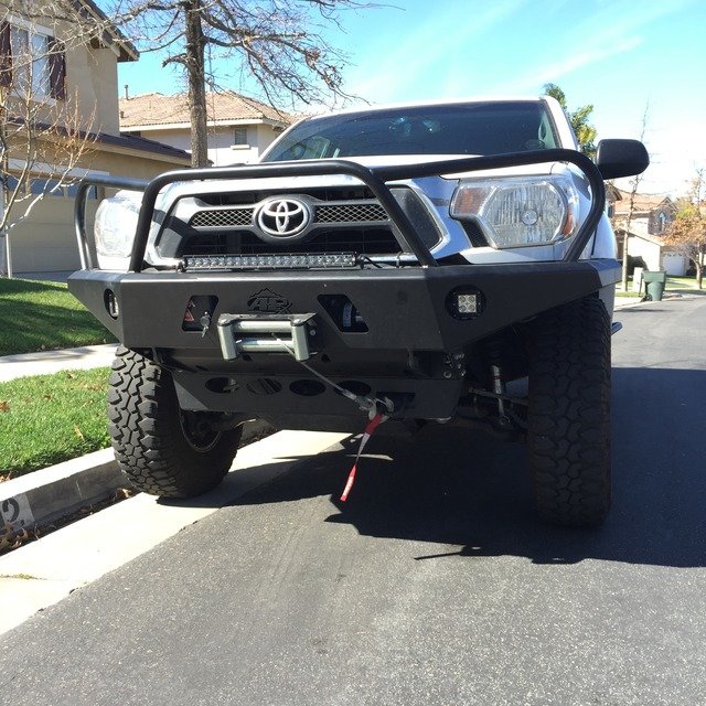

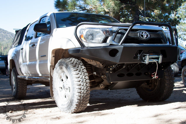

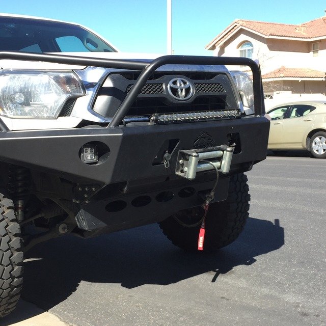

    Upgrading the Front Bumper:

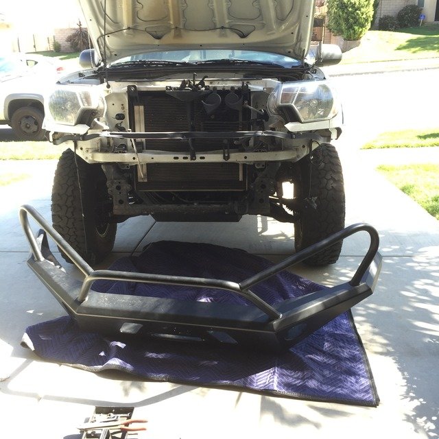

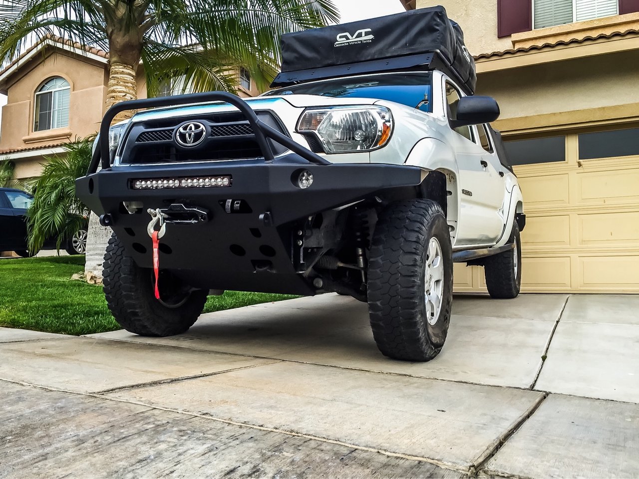

    I was offered the opportunity to upgrade my All Pro Apex Steel front bumper with an identical bumper but with the aluminum version. The weight savings was immediately apparent. The human lift scale told us it weighed less with the winch installed than the steel bumper alone. Granted that is not a scientific test but it worked for me lol.
    53C8559B-DA34-4D30-8B26-74C35822C678_zps_e32f249f76ecb91f3de9cdd299752a470f43f3d7.jpg
    F7ECA9DE-3E7D-4D86-ADB4-7618BC468F27_zps_94e363d640fca5d8f2bc340408a03990dc84c4b8.jpg
    C5CF9E49-C6C9-4C16-8A82-A84F9775ADDB_zps_1f73564378690b585d6fdccac0a9558f544ed959.jpg
    692C9175-557E-40EE-B3FF-1119040D8FB7_zps_4b3c41691c4ea47081cd518288cddec760d6b399.jpg

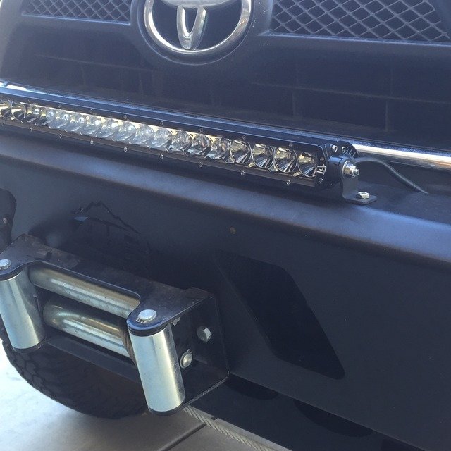

    Lighting:
    It was time to address the lighting so I purchased a 20” Flood/Spot combo SR series for the front bumper.

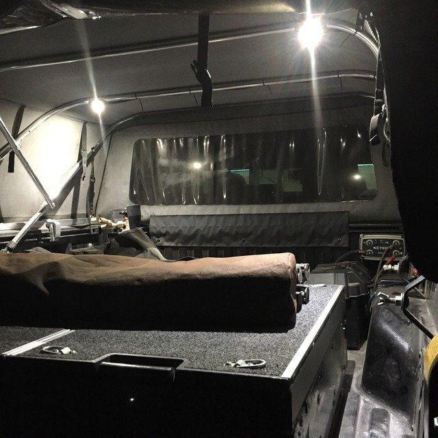

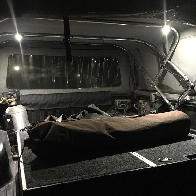

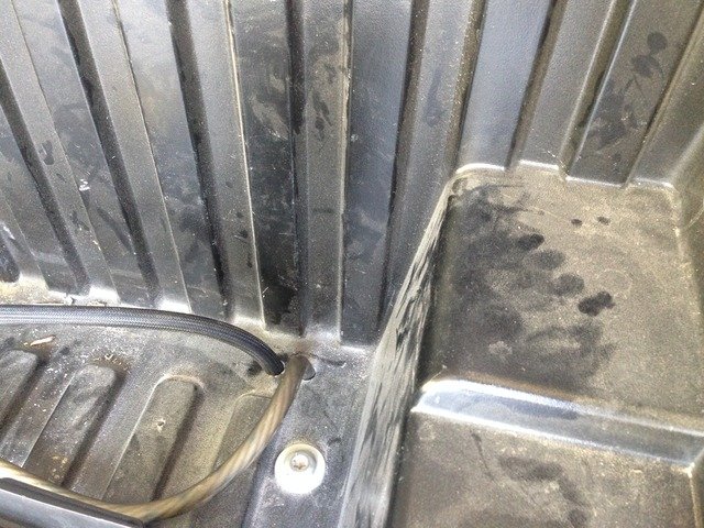

    I was also tired of crawling around in the bed in the dark when camping so I added bed lighting using the Rigid A Series low power lights. A switch that is easily accessible in the bed was also installed to turn them on and off. It was wired off of the house battery.
    62C0D794-3A82-41C5-9AD4-916EAC970B01_zps_55b027ee29551751a2a944617c4757d7f1a172db.jpg
    1248740B-7DC5-468C-B1BD-4E9D8A8F09D4_zps_3e8f54972f20795ca39fde28ffbc54353bfed530.jpg
    C02FE9C4-2AF5-4DE5-861B-10DB66082534_zps_4b69d4bdaab5ec7de3ff9e8a5aad3197c7d6498b.jpg

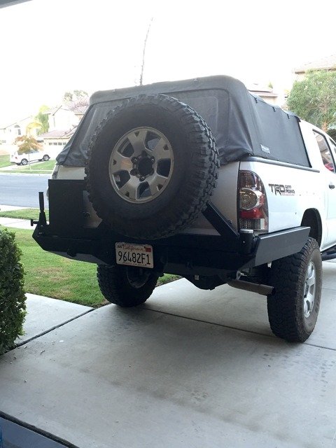

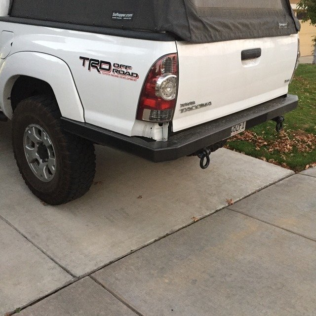

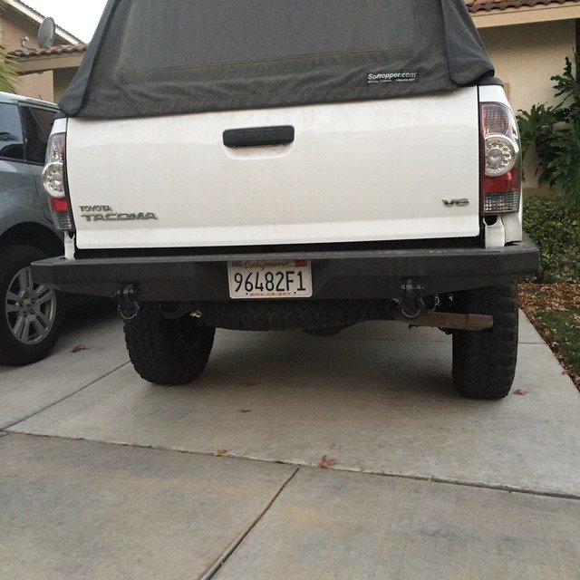

    Rear Bumper Re Addressed to Suit Camping Needs:

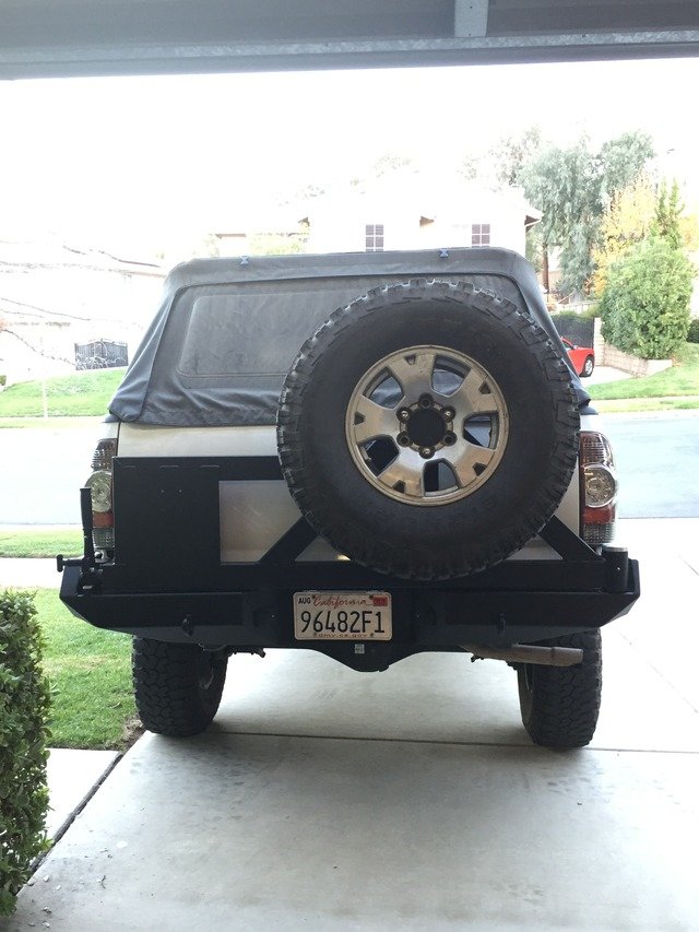

    After several trips with the bumper we built we determined that there were some needs in the camping department that our wheeling bumper didn’t suit. So we gave our friends down at Pelfreybilt a call and ordered one of their high Clearance bumpers with swing out, camera relocation kit and fold down table.
    These are not the best pics so they will be updated soon with better
    0ADD0C49-0AFA-4359-ACF2-72643B374BCC_zps_d1c01cb99bed2b81f16fb232a872b2b99f755182.jpg
    983E9912-C840-4515-9DDD-39C820B5F3DB_zps_5833968f8b4d10f2b26dd4c8cad8f0886022727a.jpg

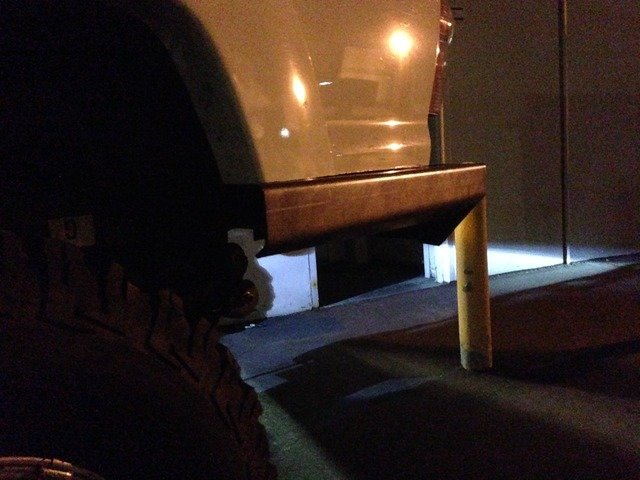

    Got the fenders trimmed and back on today after installing the Pelfreybilt high clearance bumper and swing out.
    Also purchased a CBI double Jerry can holder that will go on the swing out shortly. A prinsu designs roof rack and a CVT Mt Shasta RTT are also to be installed shortly by my friends over at GooseGear. More pics to follow.

    Added Rivnuts to the swing out so we could install the CBI double Jerry can holder.
    Got the Jerry can holder installed using Grade 8 bolts.
    Installed the back up camera using the relocation kit from Pelfreybilt
    Another pic of the back up camera relocation.

    Went by GooseGear today and Matt and Brian helped me install the new Prinsu Designs roof rack. Actually I think Matt did most the work in that department.
    Then it was time to get the new CVT Mt Shasta up there. Brian did most of the wok there!
    Still not sure why he wanted to get up there but he did.

    Awesome! Have you had the softopper in the rain yet? If so, how does it do w/ keeping the moisture out of the bed?

    It's been on the truck for a couple years. I have had no issues with water getting in at all.

    good looking truck. great choice on HCB. curious on the camera mount, did you relocate using only the OEM length camera cable?

    Right on, I've been on the fence for awhile about that.
    You liking the 255's? Seems those may be the route I go as well

    Yes no trimming no rubbing I couldn't be happier. I'll be replacing these with the same size when the time comes.
