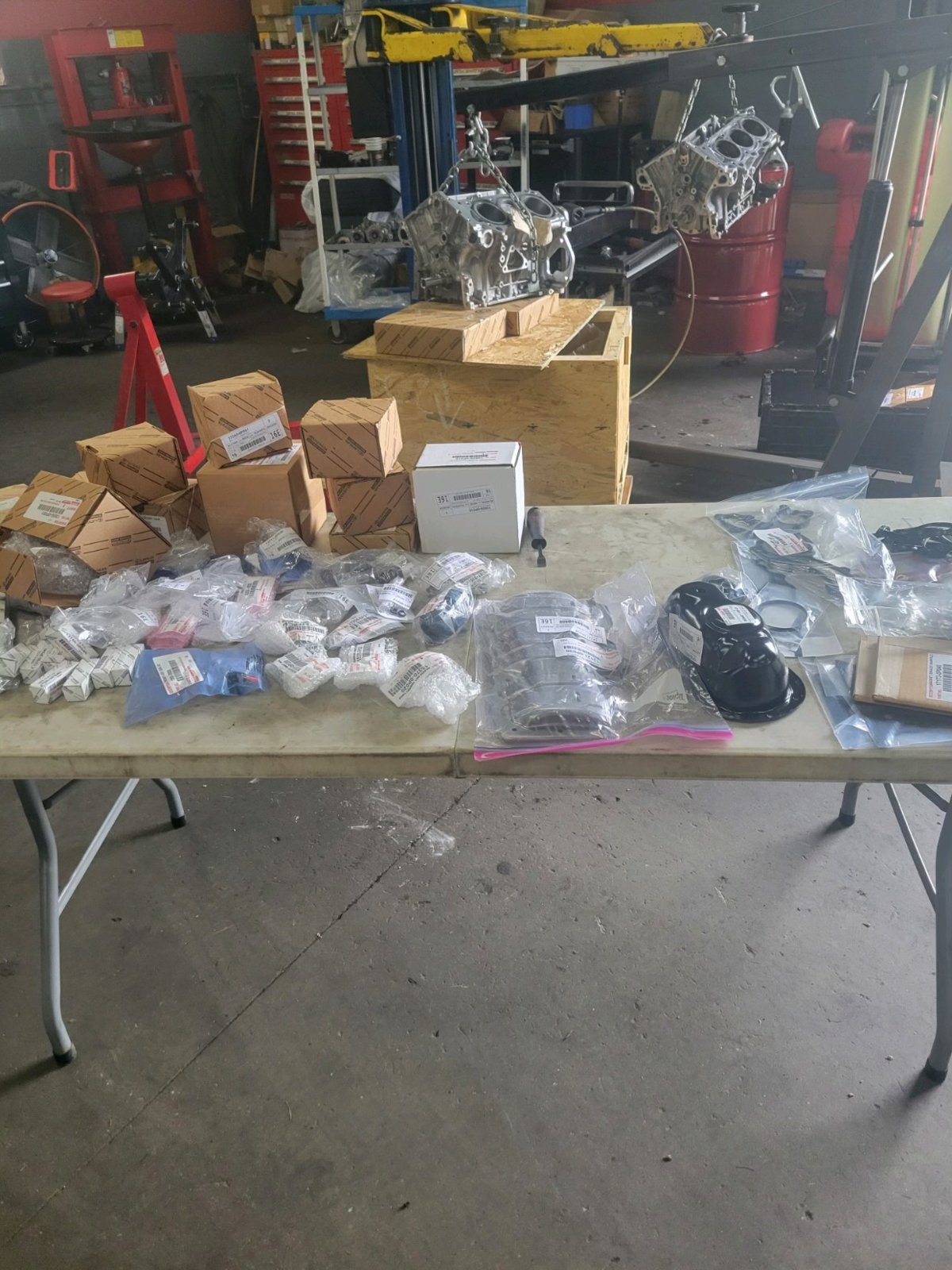

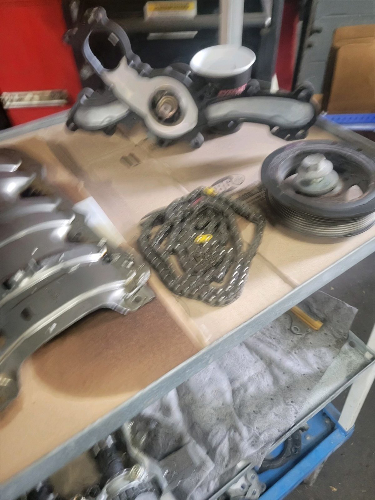

    The short block arrived. There's a new oil pump and a couple valves on order. Not sure how far they've gotten into the teardown.

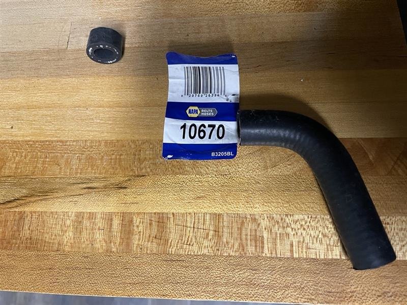

    I've asked for the following for peace of mind:
    - A confirmed root cause for the engine failure.
    - Picture(s) verifying concern caused by the aftermarket AC drain extension hose.
    - List of OEM replacement parts required to repair the damage.
    - Teardown and rebuild pictures.
    I’d appreciate pictures such as:
    - Damage evident after the teardown.
    - Any debris found in the oil pan, oil filter, or top end.
    - Unboxing of the new OEM short block.
    - Inspection of reused top and bottom end components.

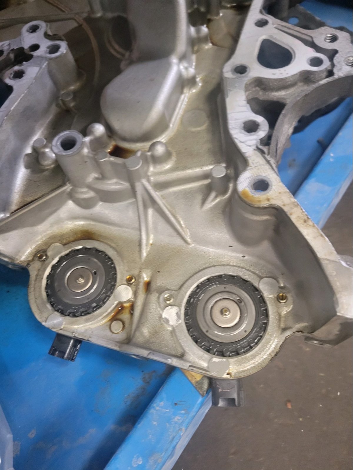

  11. May 8, 2024 at 9:28 PM
    #31
    Shift
    Shift [OP] Active Member
    Mar 8, 2015
    #150447
    40
    CT
    2021 TRD Sport 040 Access Cab

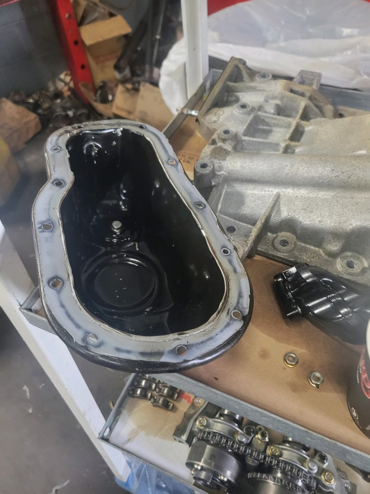

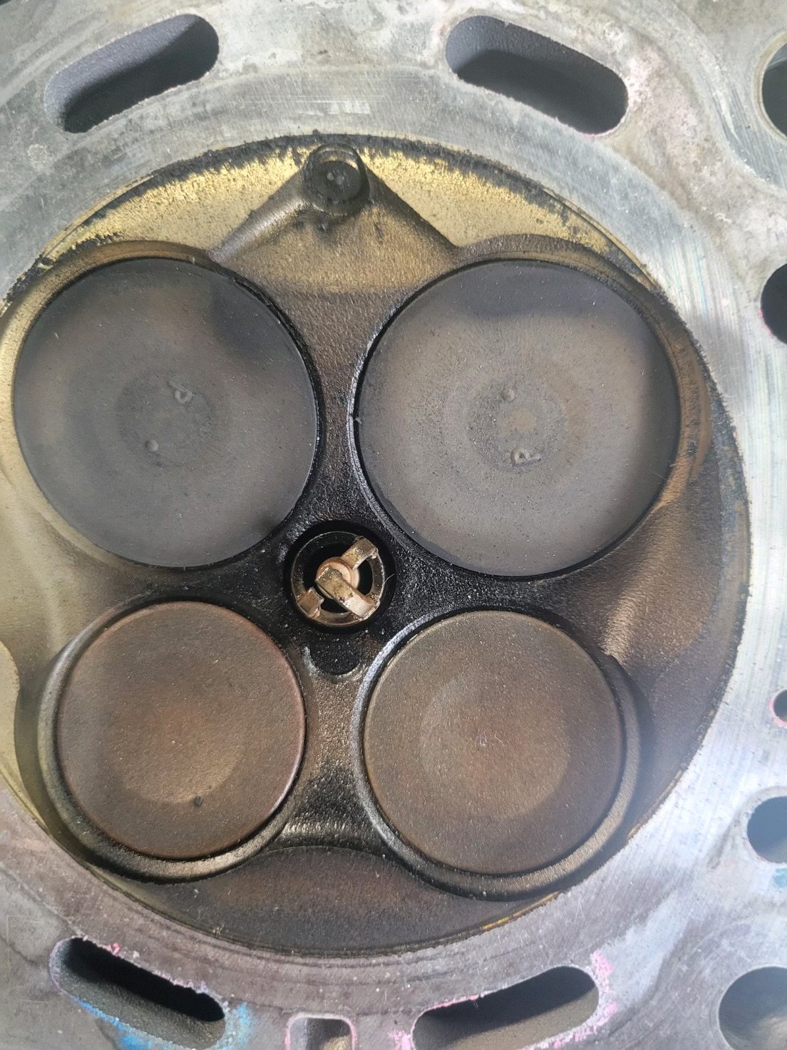

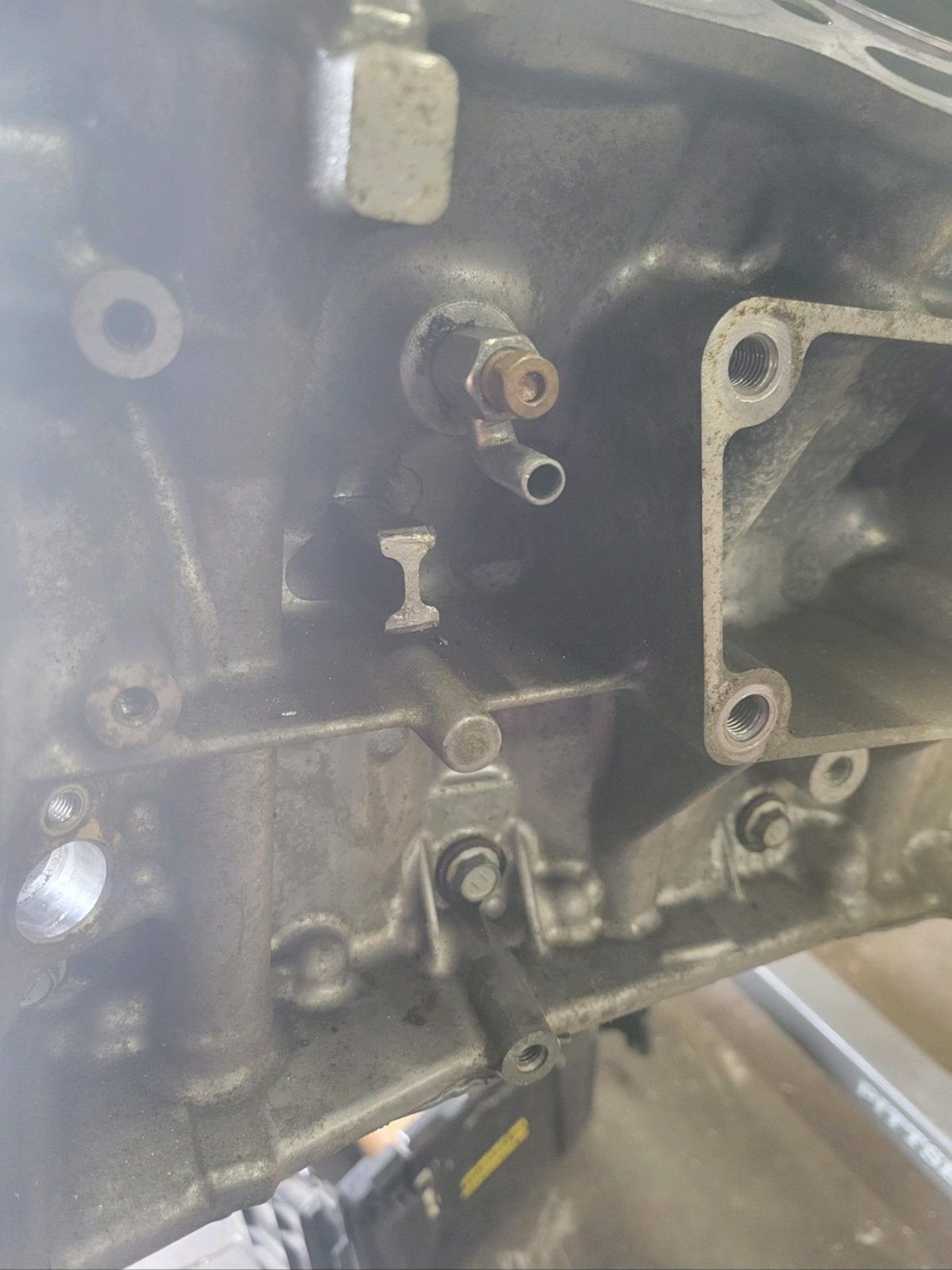

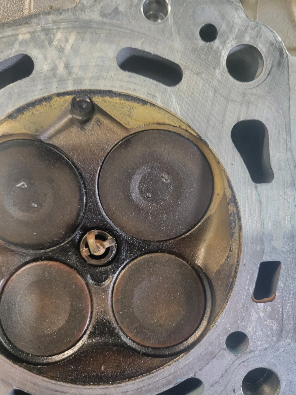

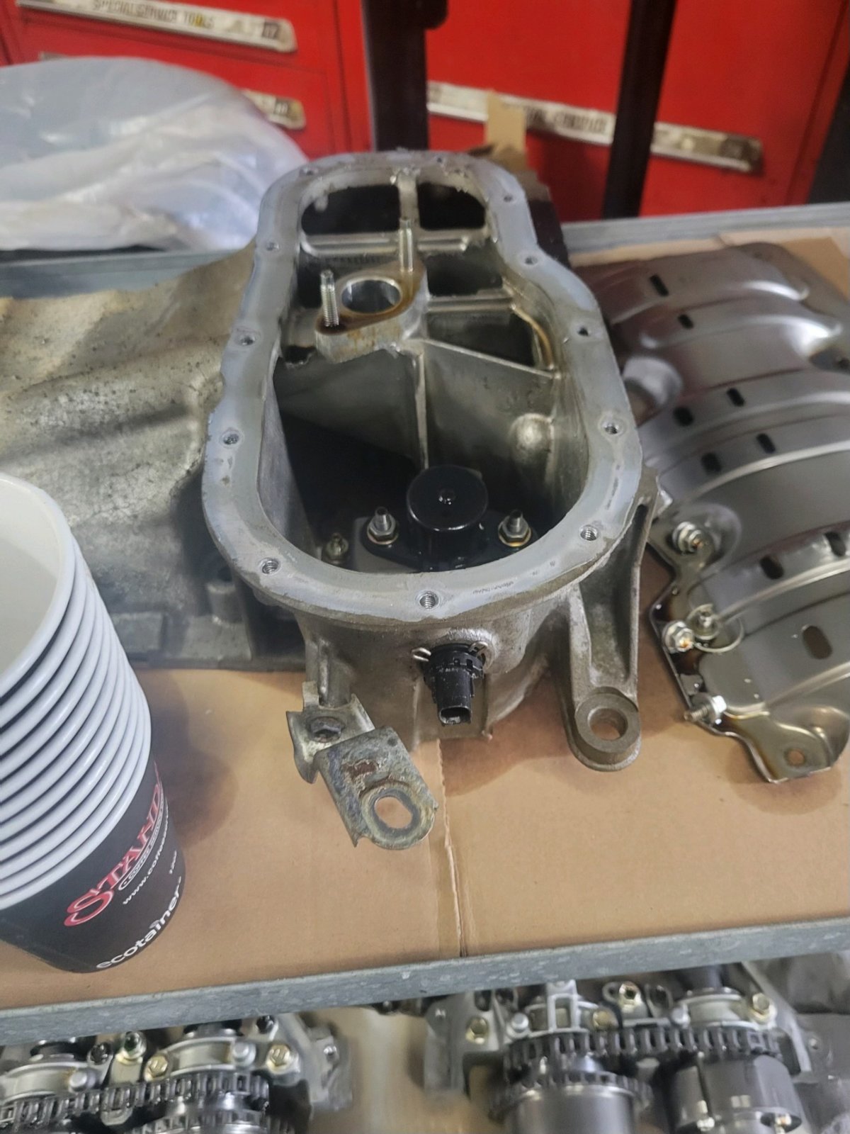

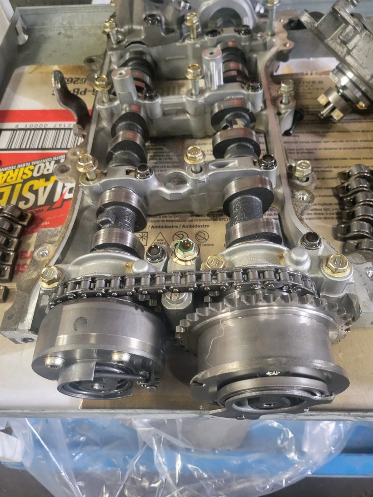

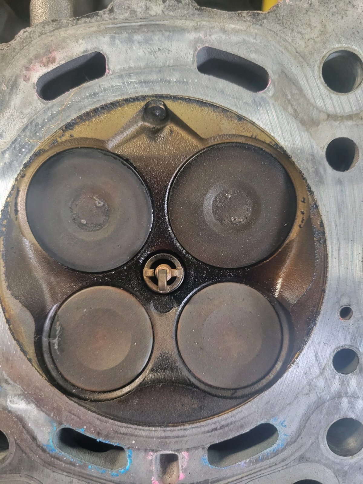

    Starting to feel at ease now that I'm seeing the amount of OEM goodies that have been ordered. The damage looks to be well to contained. Still no parts list in hand, but I expect that critical valve train components will be replaced. I assume that the heads and cams will be reused once inspected.
    Greentree service has been good about keeping me in the loop. The valve pictures attached should be from the passenger side head.
    Not the best picture, but it looks like something (hopefully just a pry bar) wreaked havoc in the oil pan.

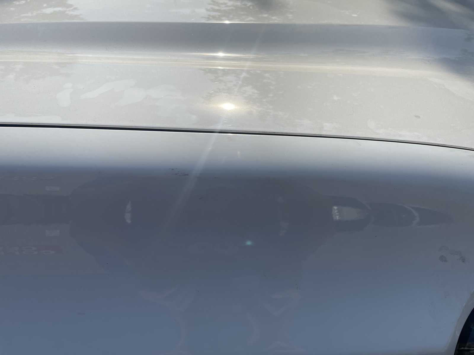

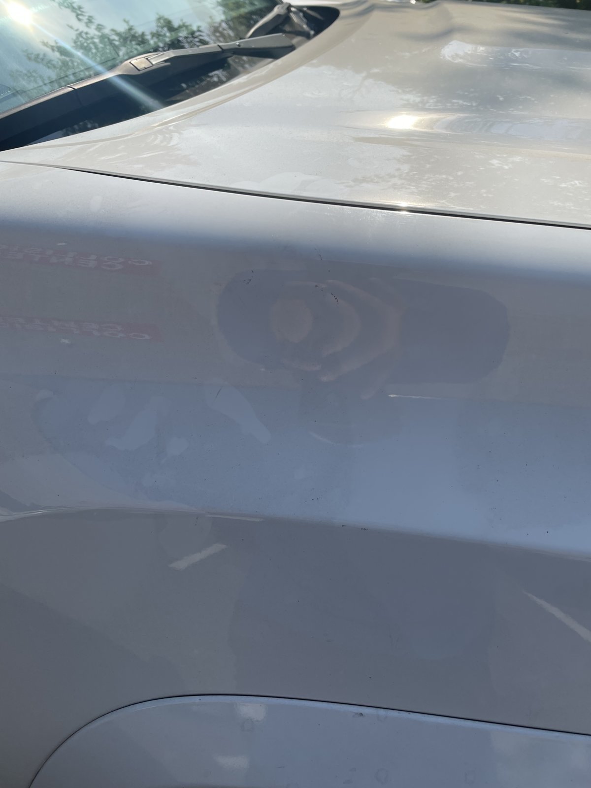

    I still don't have my truck back...

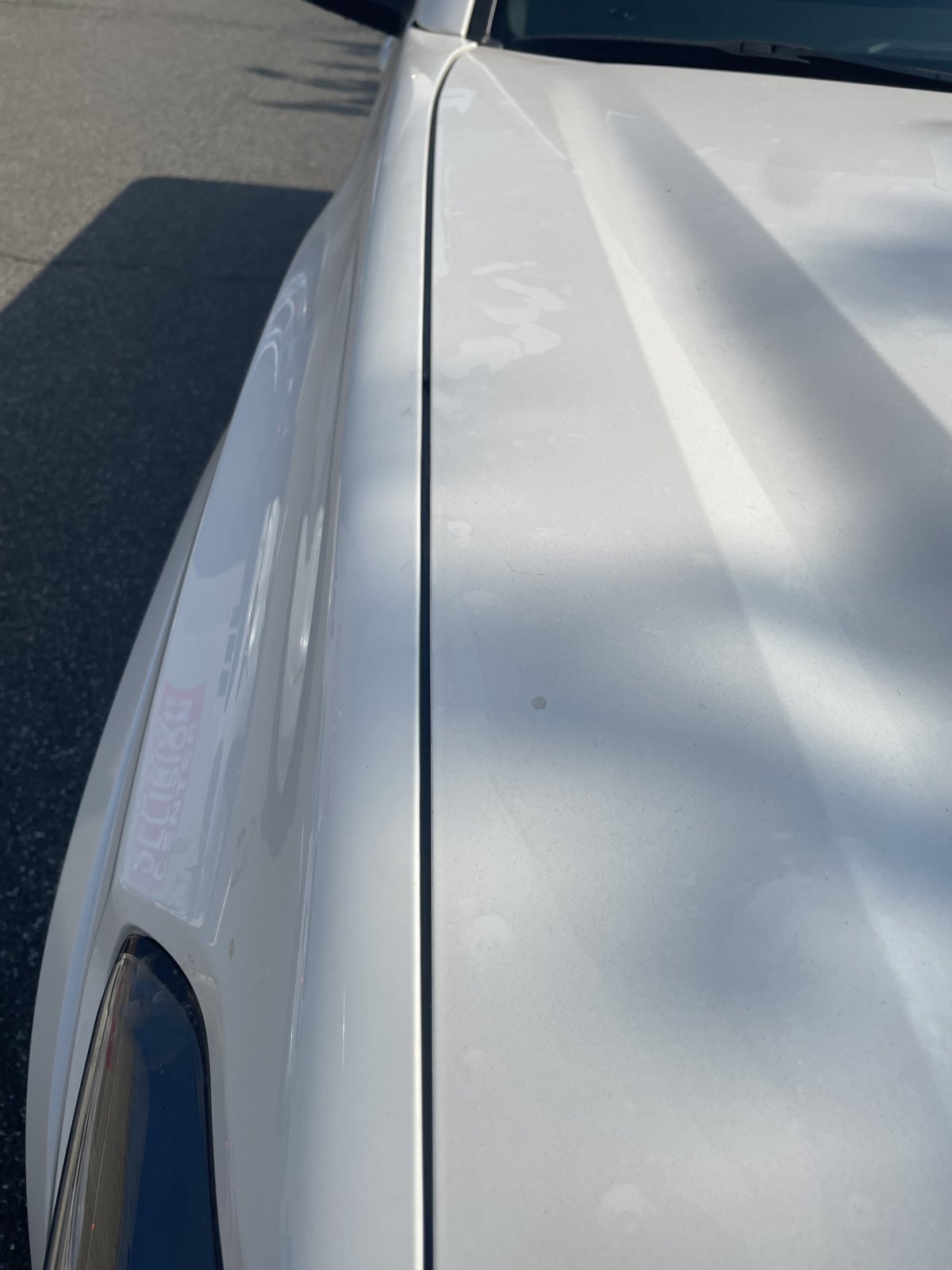

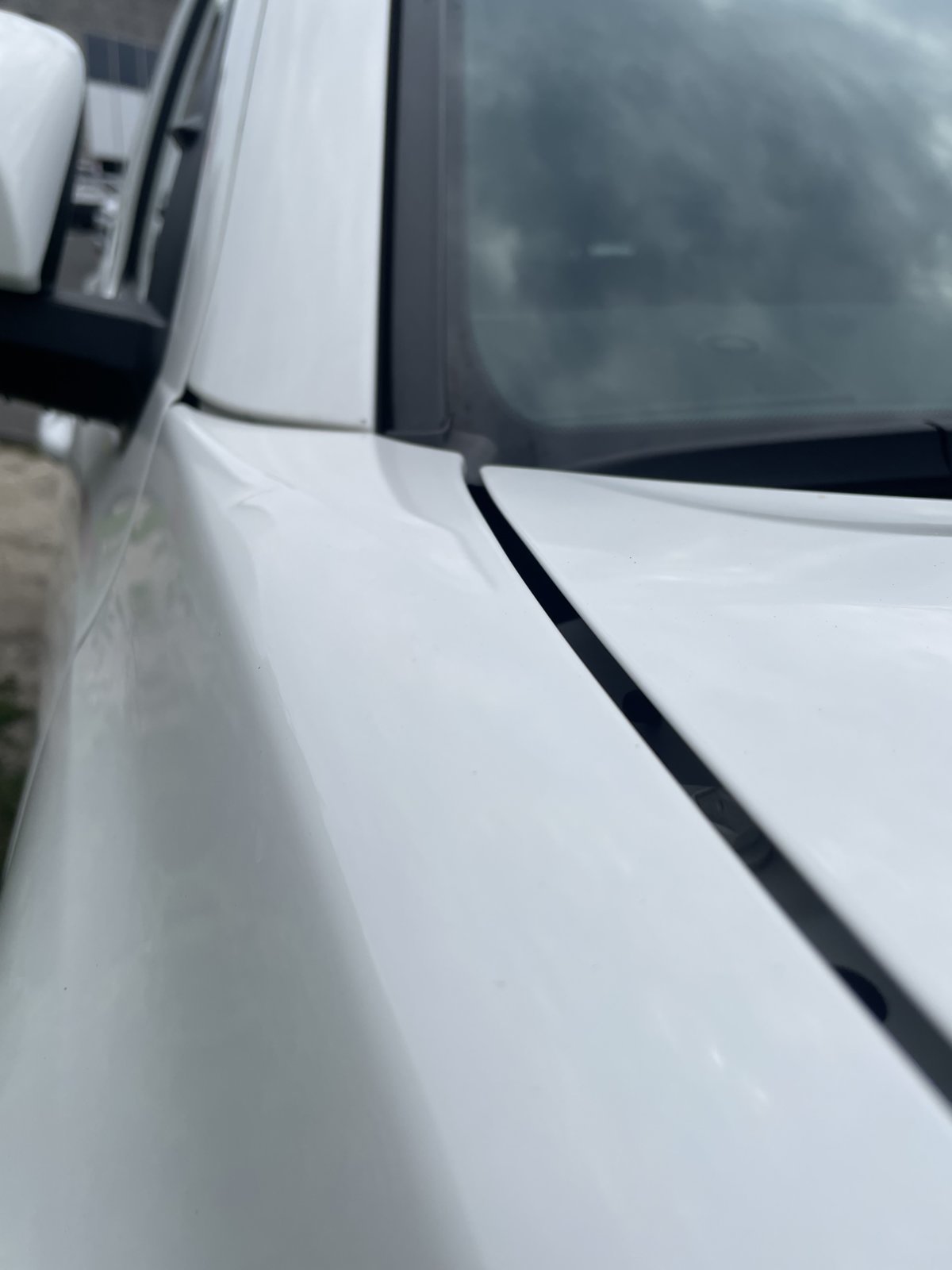

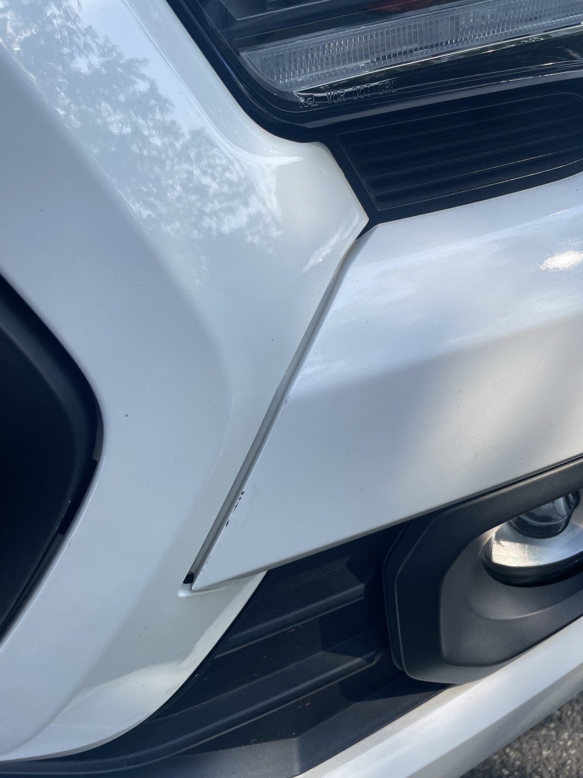

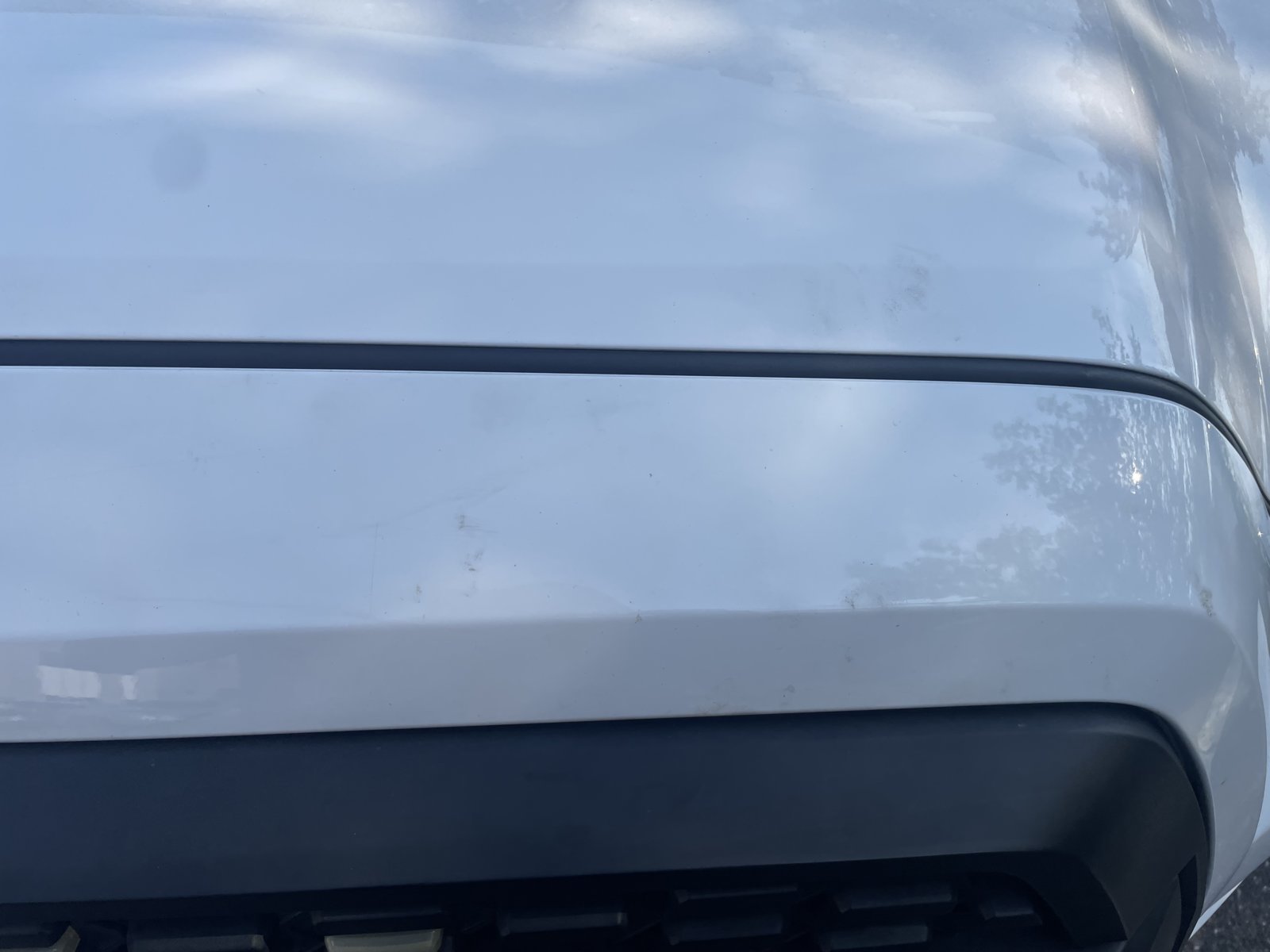

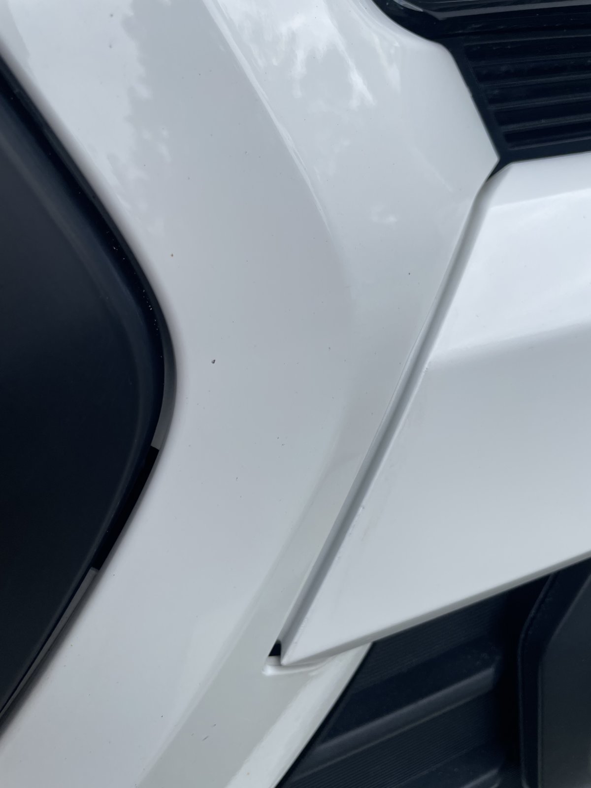

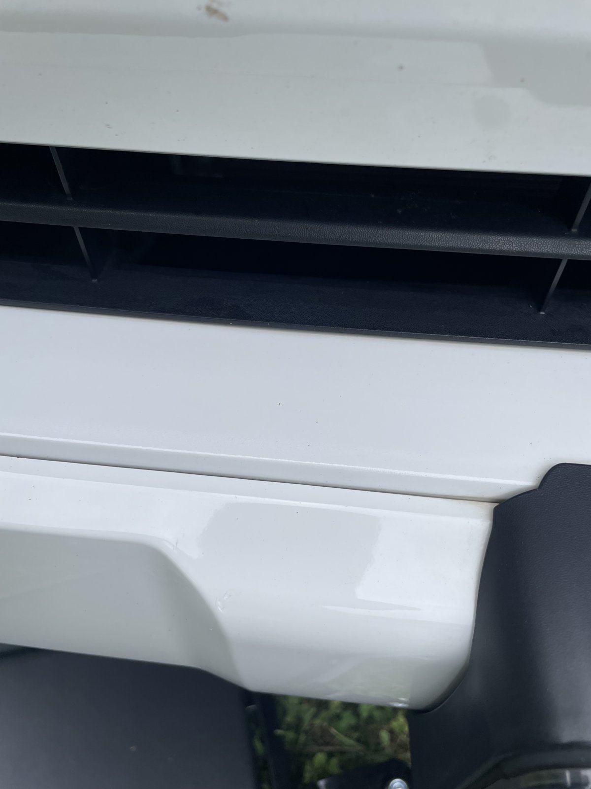

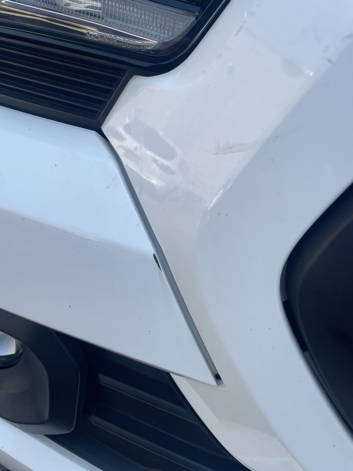

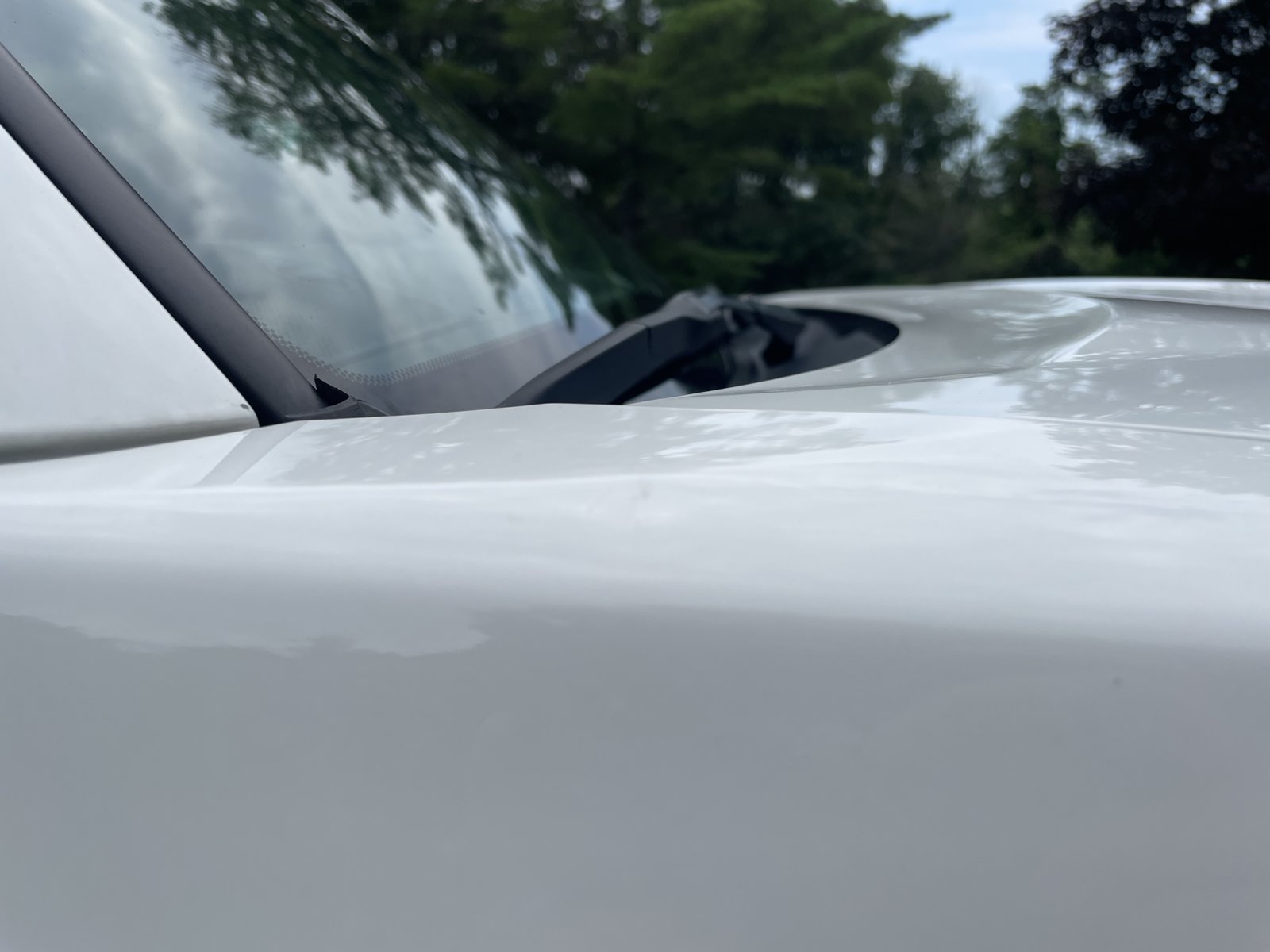

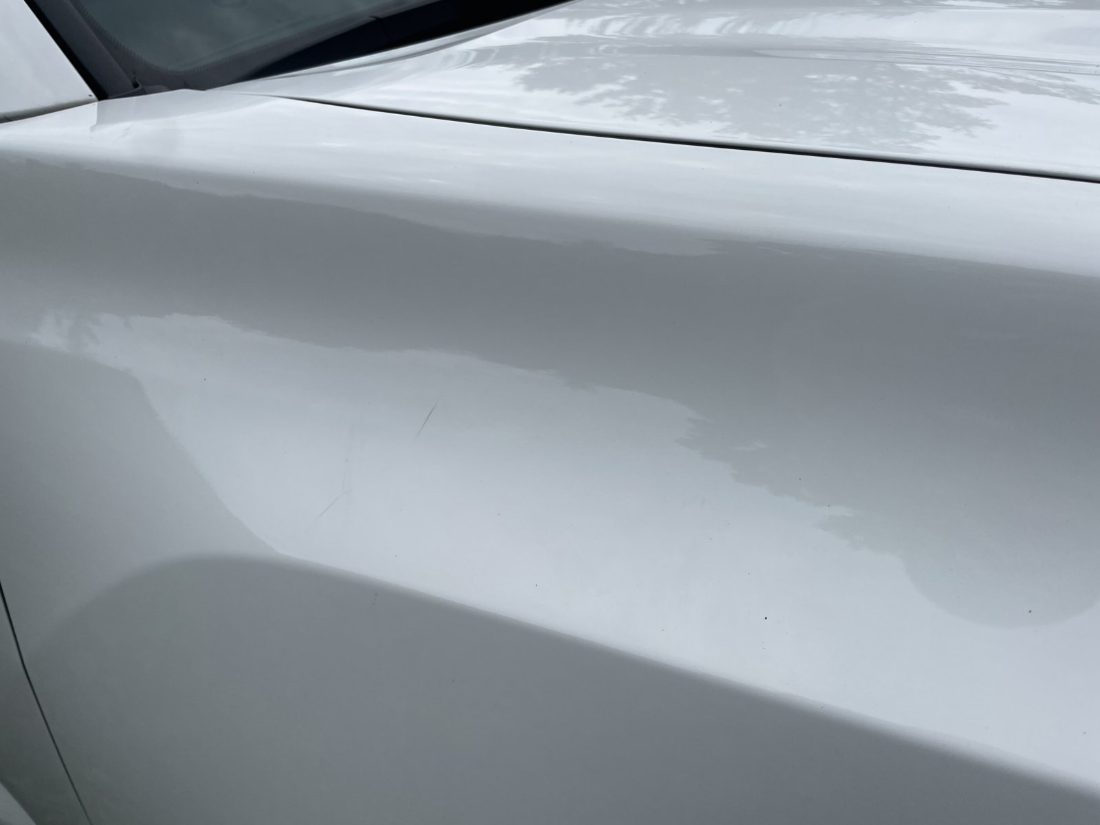

    June 19th:
    There was a vacuum pump on back order. I got a call on June 19th stating that the truck was "ready". I left work immediately.

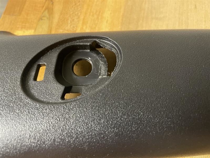

    I arrived to find my truck's exterior filthy. I kept the loaner key and took my truck for a quick drive to a sunny parking to inspect it. Paint damage found all over the frontend.
    Handed my key back and the service adviser called the shop. Come to find out.. truck wasn't ready and was unsafe to drive. She ripped them a new one which was mildly satisfying to listen to. We took pictures of the damage and I left in the loaner.
    I sent an email to escalate the situation and state my expectation.
    - Clear coat on grille and fenders needs paint correction.
    - Bumper needs to be sprayed (touchup paint is unacceptable)
    - Truck must be washed the morning of pickup.
    July 1st: Extended my lease to January.

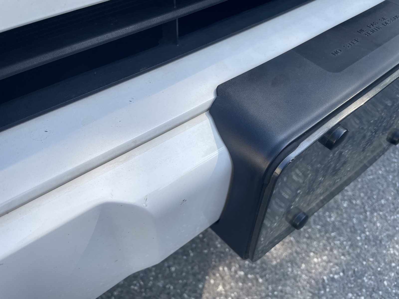

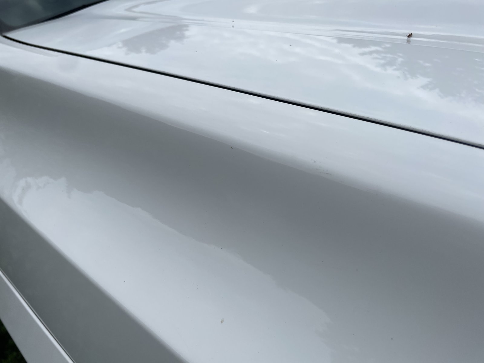

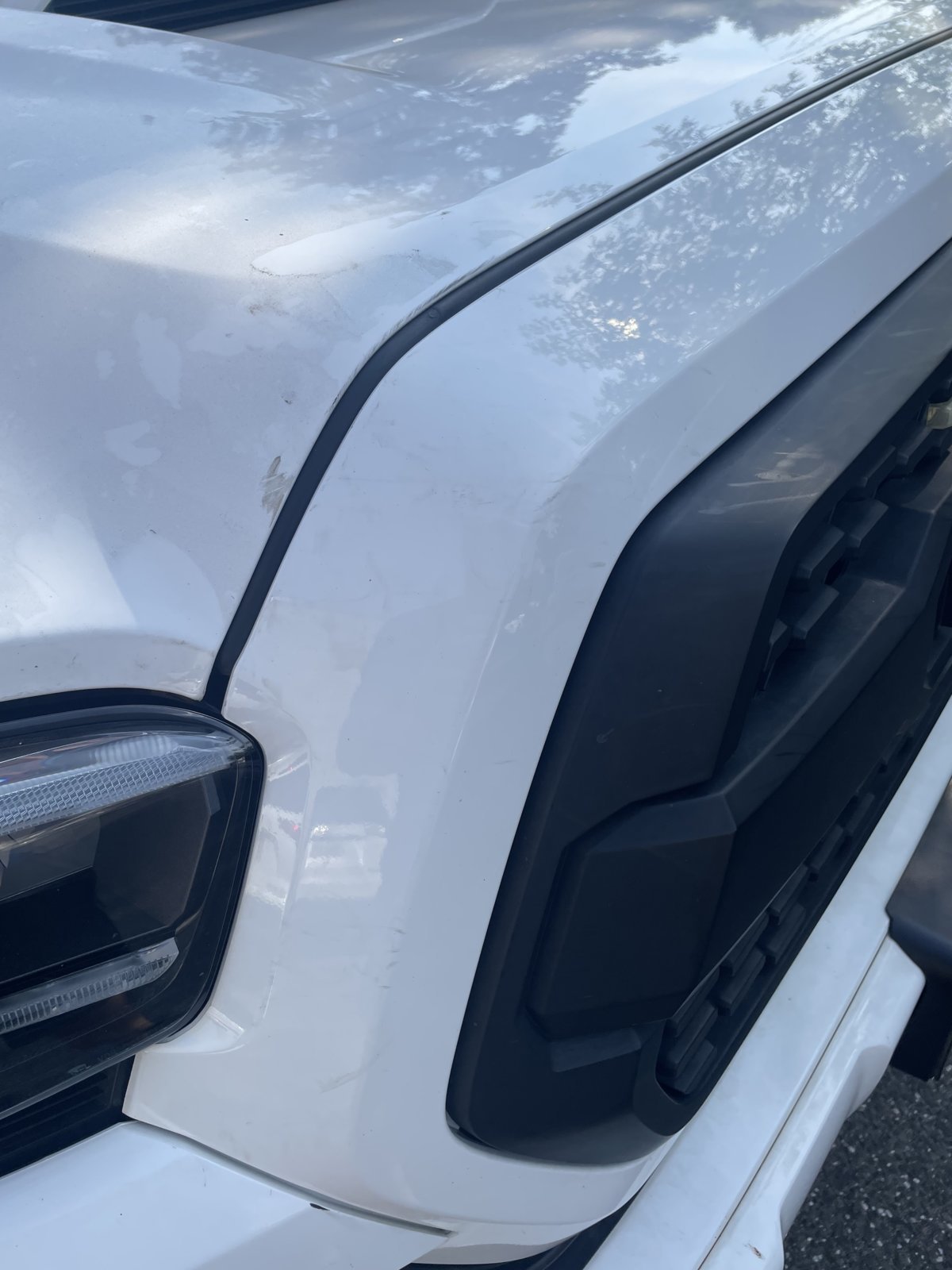

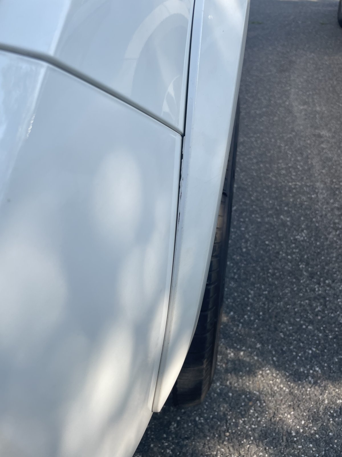

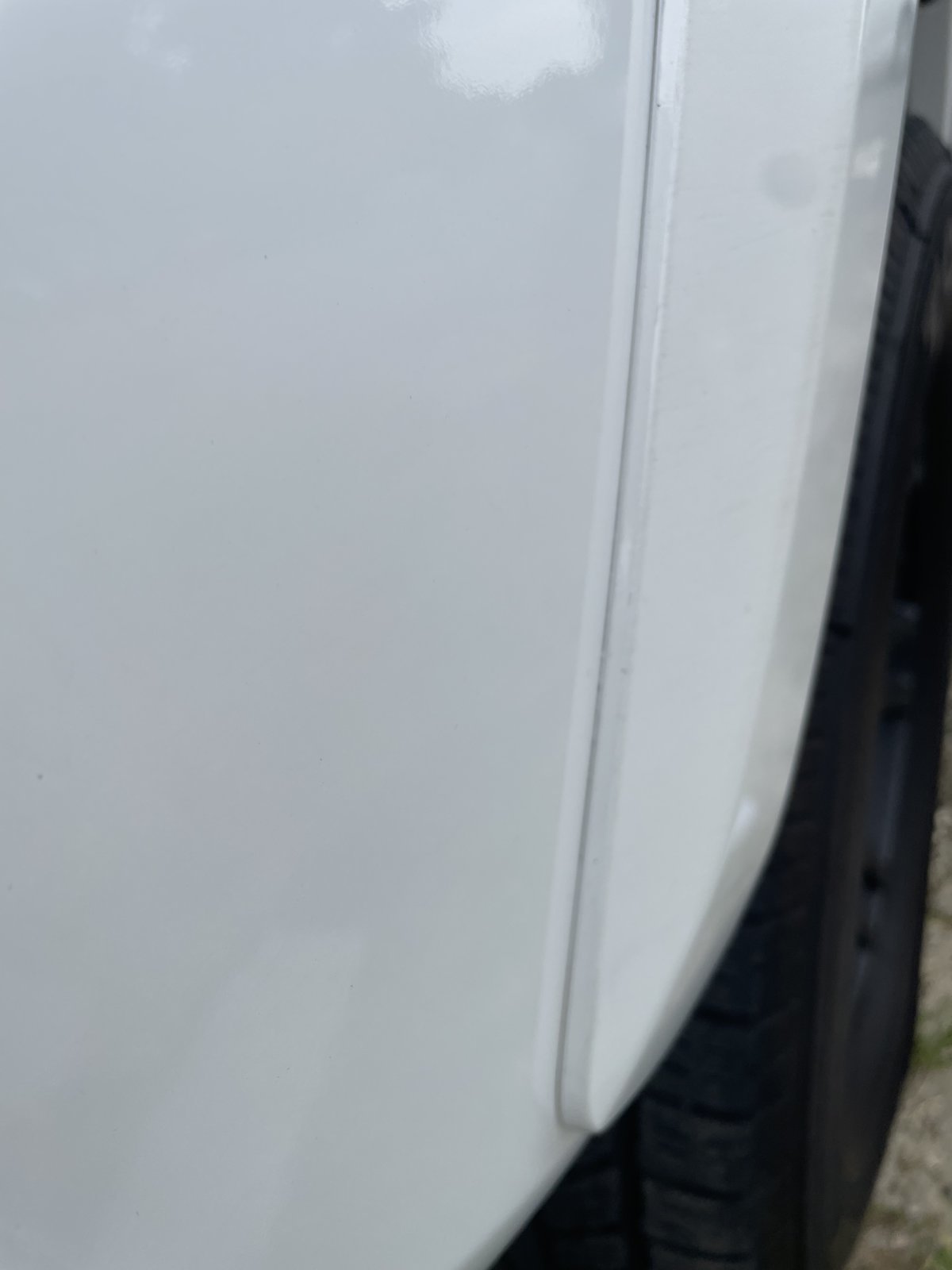

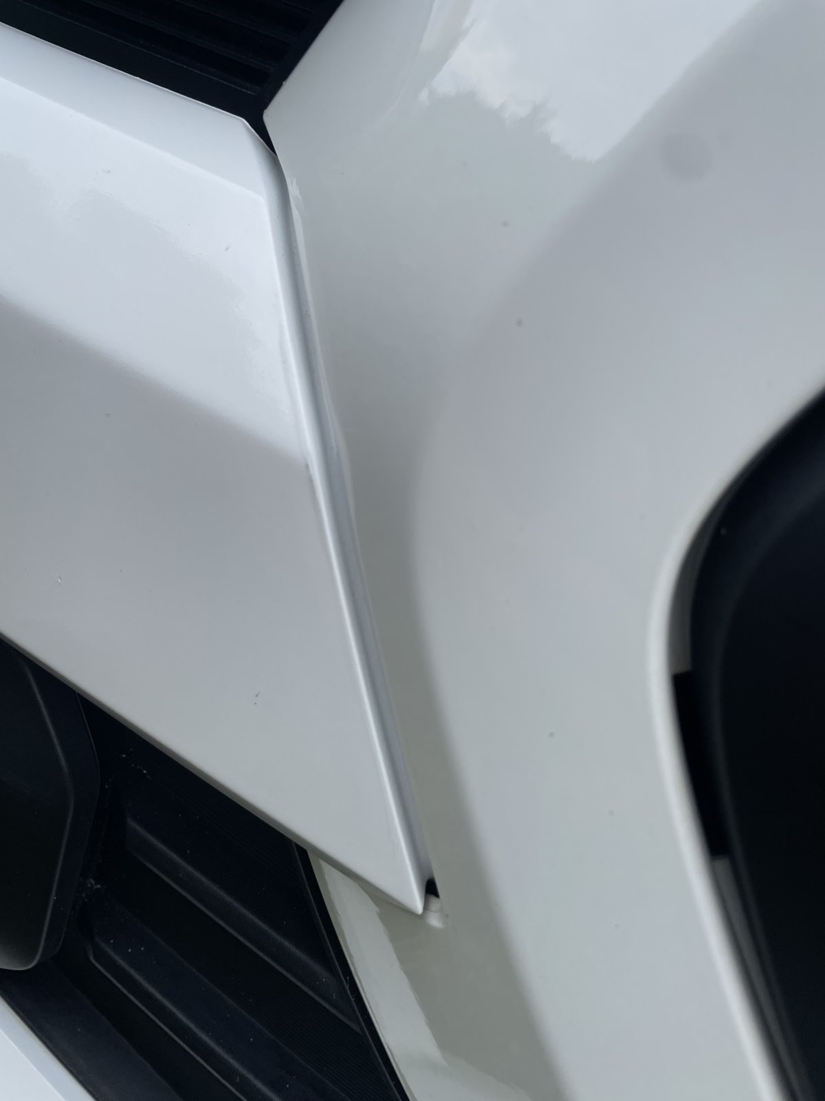

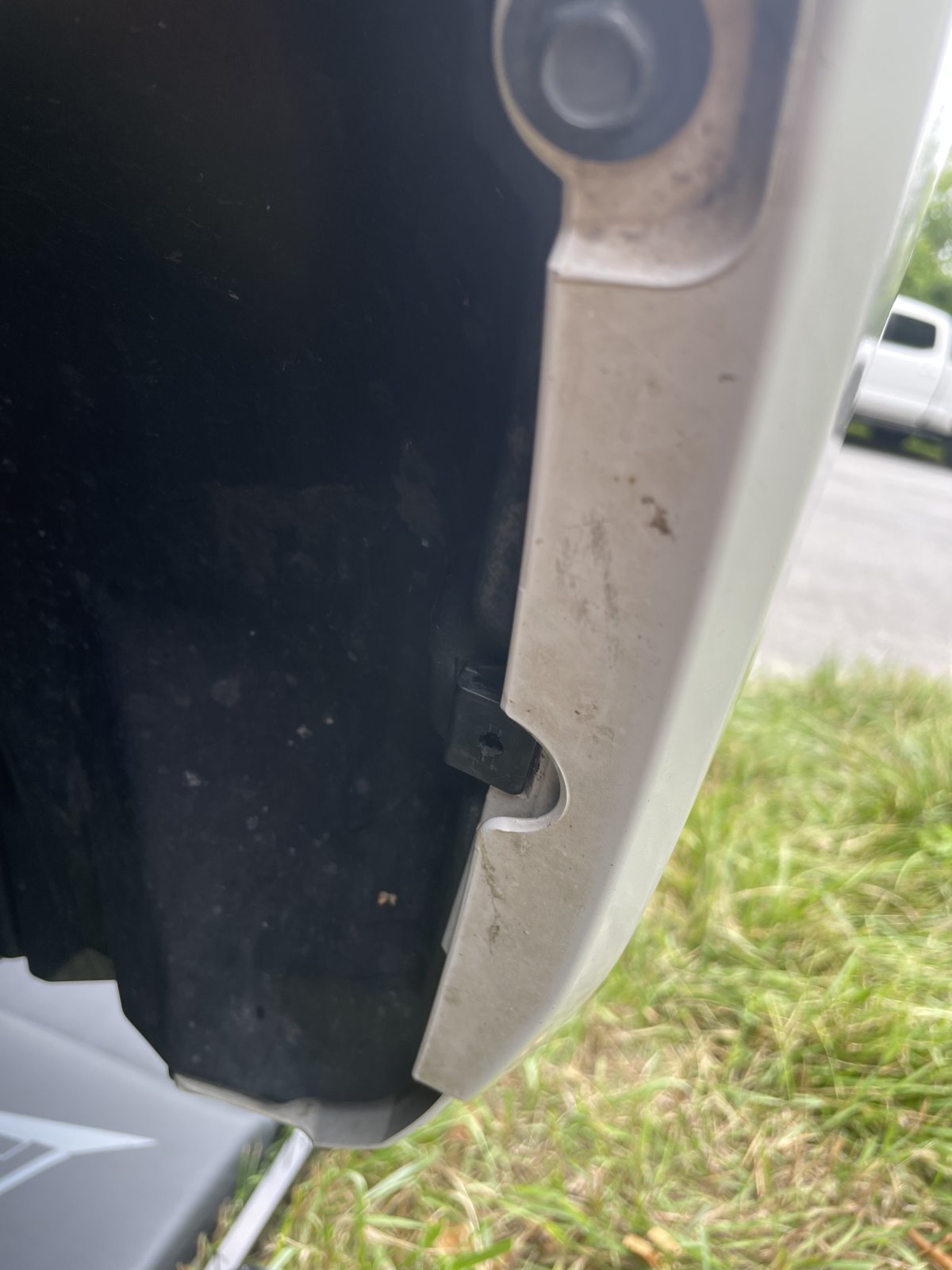

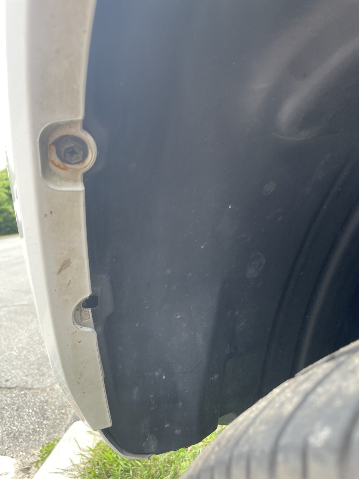

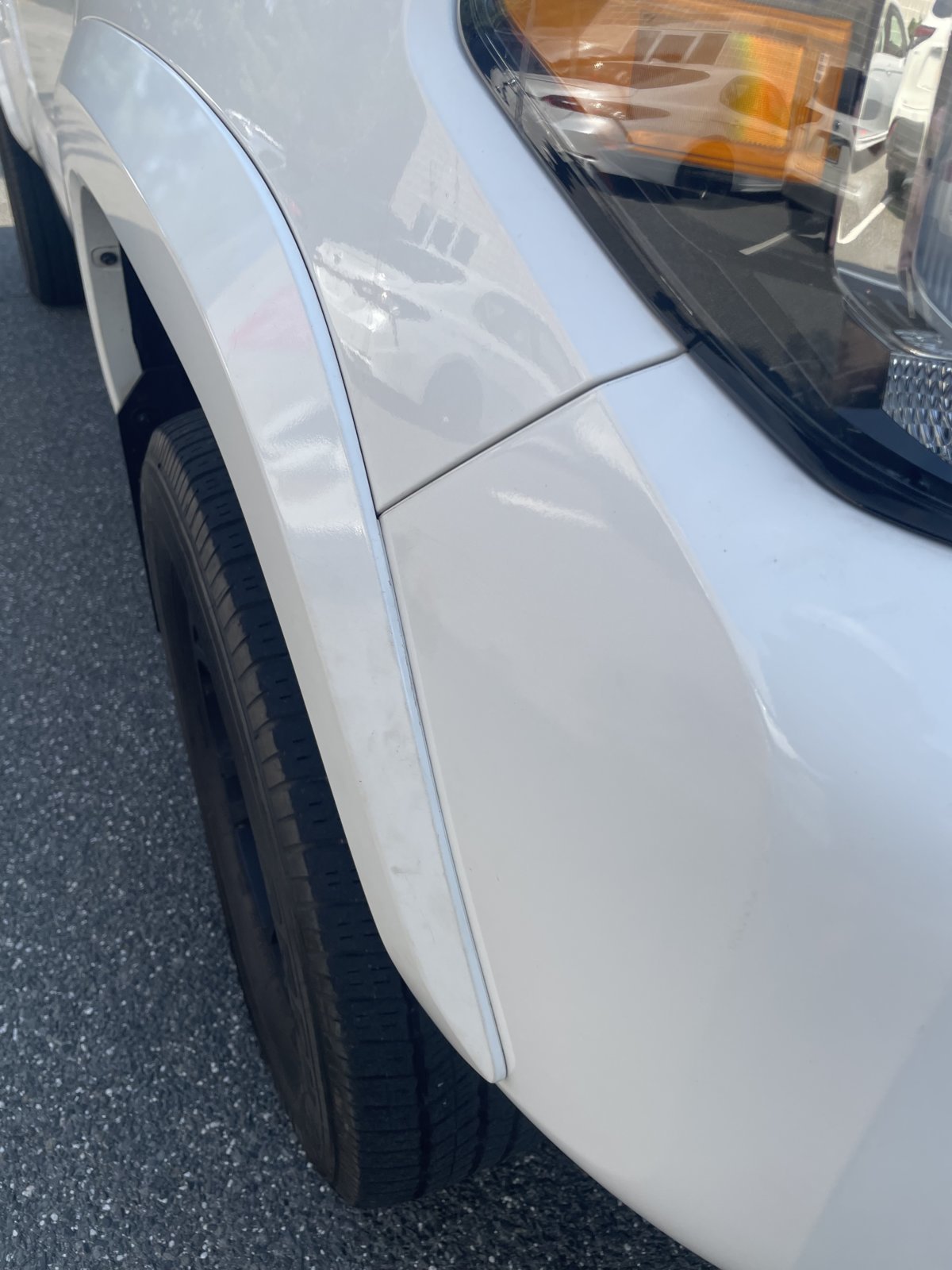

    July 15th:
    Got a call on the 12th to come pick it up. I scheduled pickup for Monday morning. The truck was clean and parked out front when I arrived. Sure enough... disappointment.
    - Touchup paint all over the bumper.
    - Clear coat damage was not corrected.
    - Found a dent on the PS front fender (by the a-pillar).
    - Missing and damaged mounting hardware in both front wheel wells.
    I notified service and went for a walk to cooldown. The service adviser and a body shop rep (manager was on vacation) came out to take pictures. They were great to work with. I'm sending an email the body shop manager to escalate the situation and state my expectation.
    I go to Greentree because I like the office staff, but it's become very clear that the inmates run the asylum at this location.
    Dumping links for reference. I want the bumper inspected. I will not accept damaged/missing OEM body fasteners.

  13. Jul 16, 2024 at 10:15 PM
    #33
    Shift
    Mar 8, 2015
    #150447
    40
    CT
    Pictures from June 19th.
  14. Jul 16, 2024 at 10:19 PM
    #34
    Shift
    Mar 8, 2015
    #150447
    40
    CT
    Pictures from July 15th.
    hemlockz likes this.

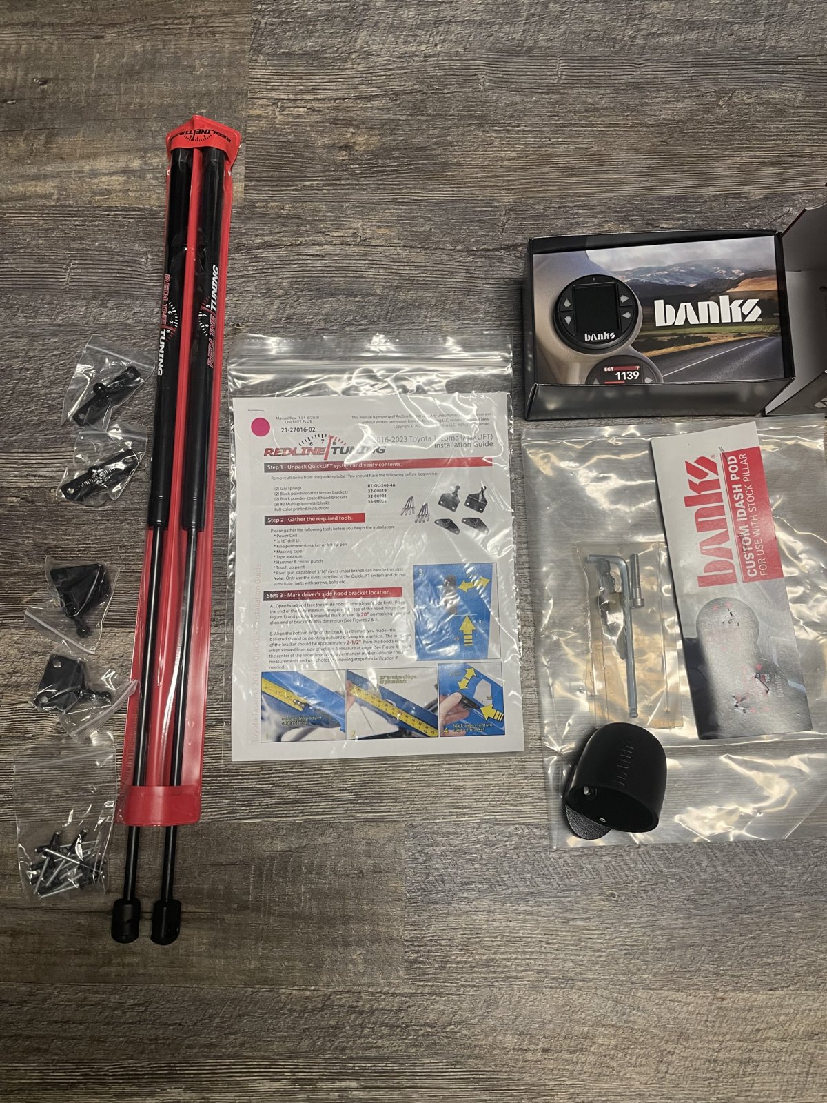

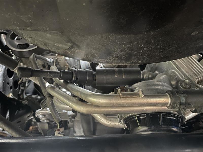

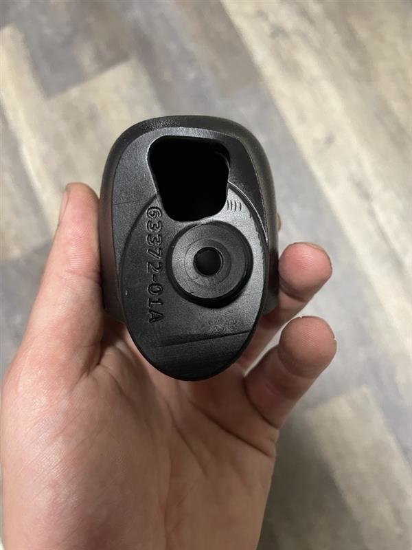

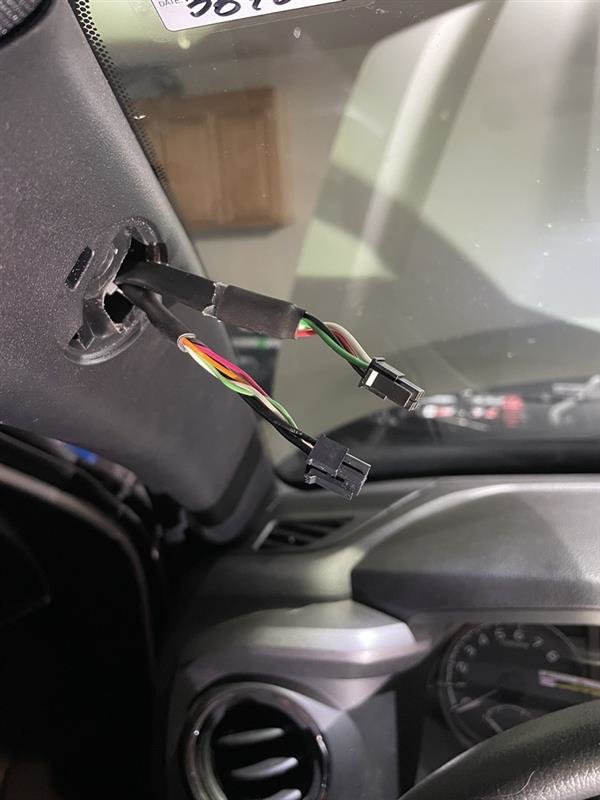

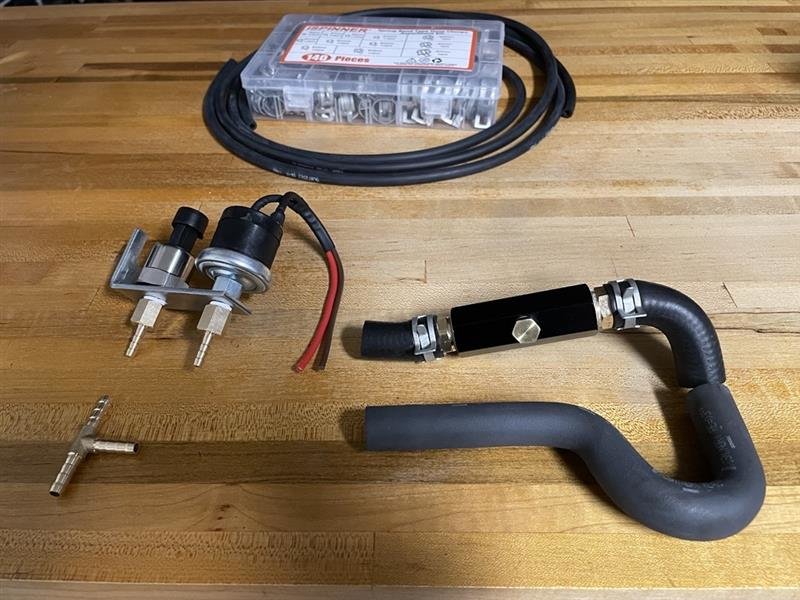

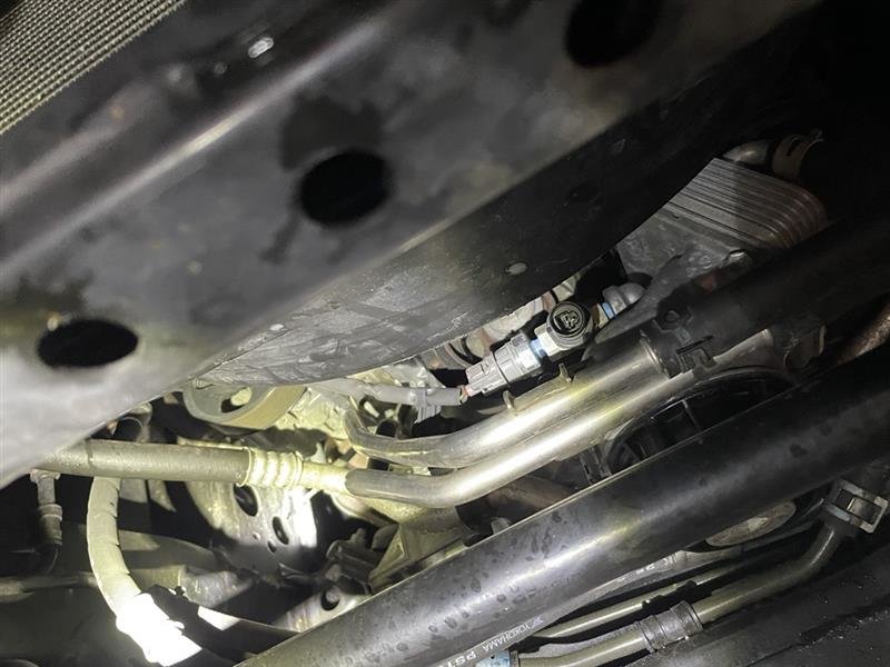

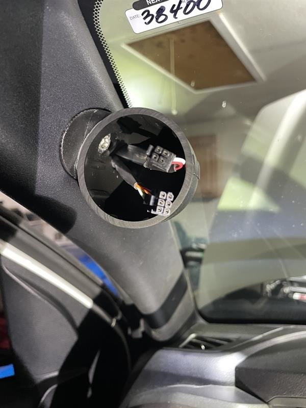

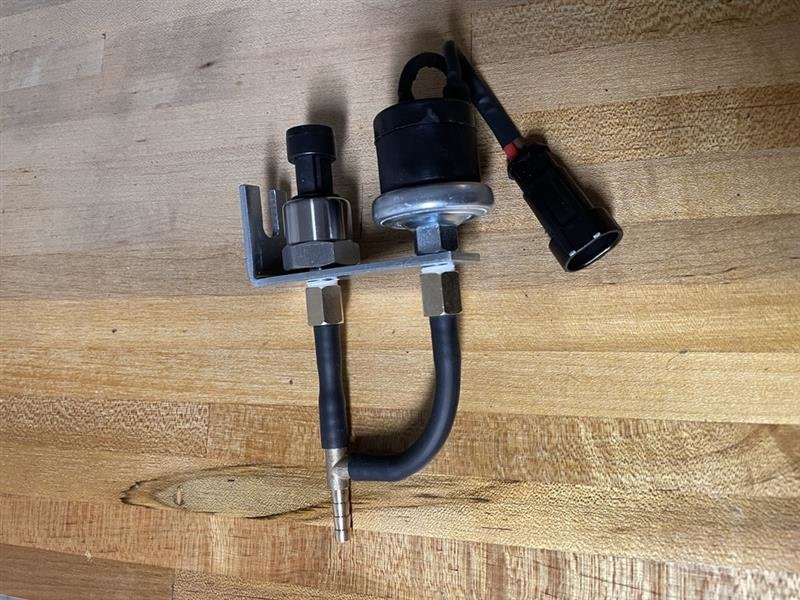

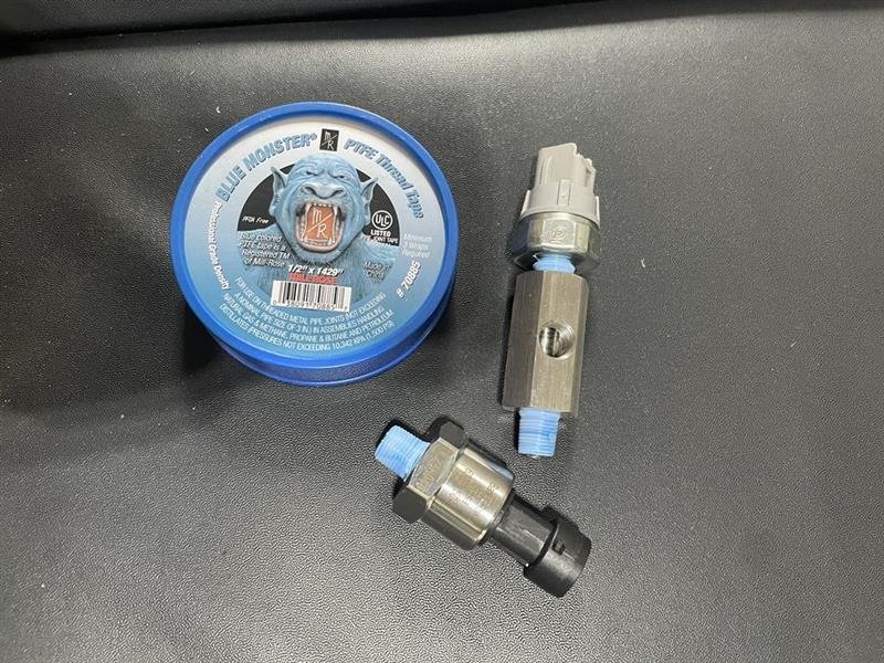

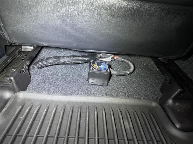

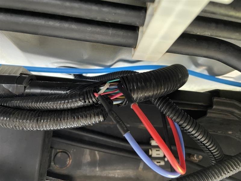

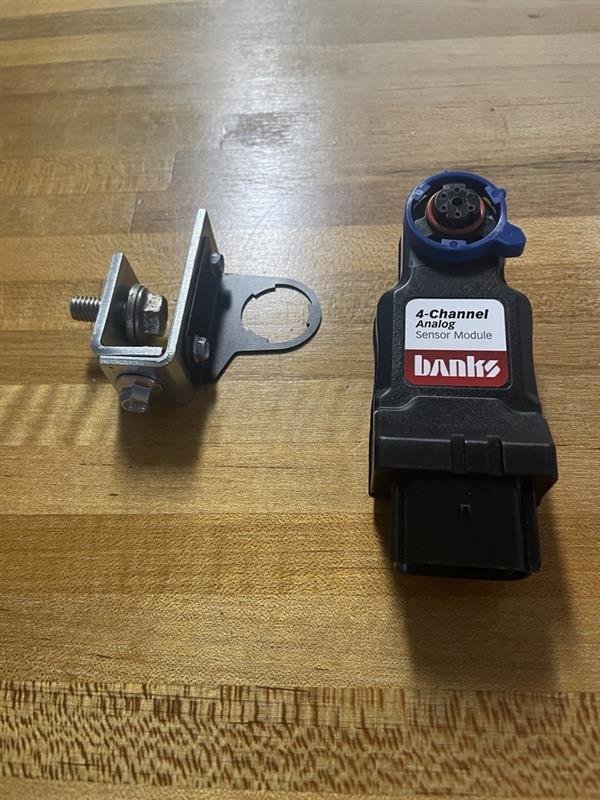

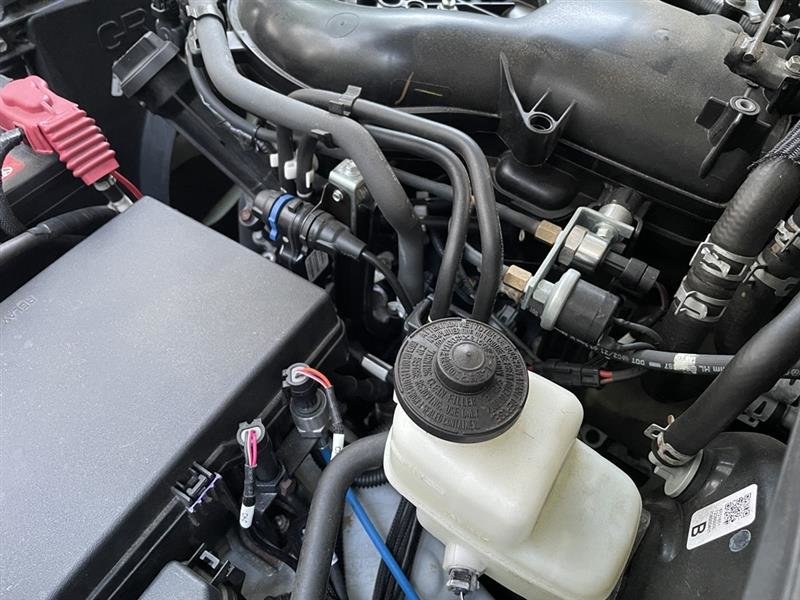

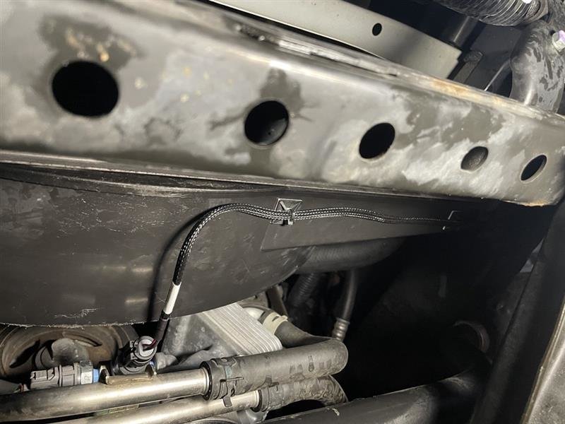

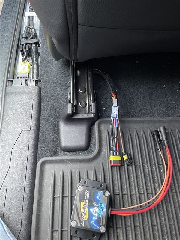

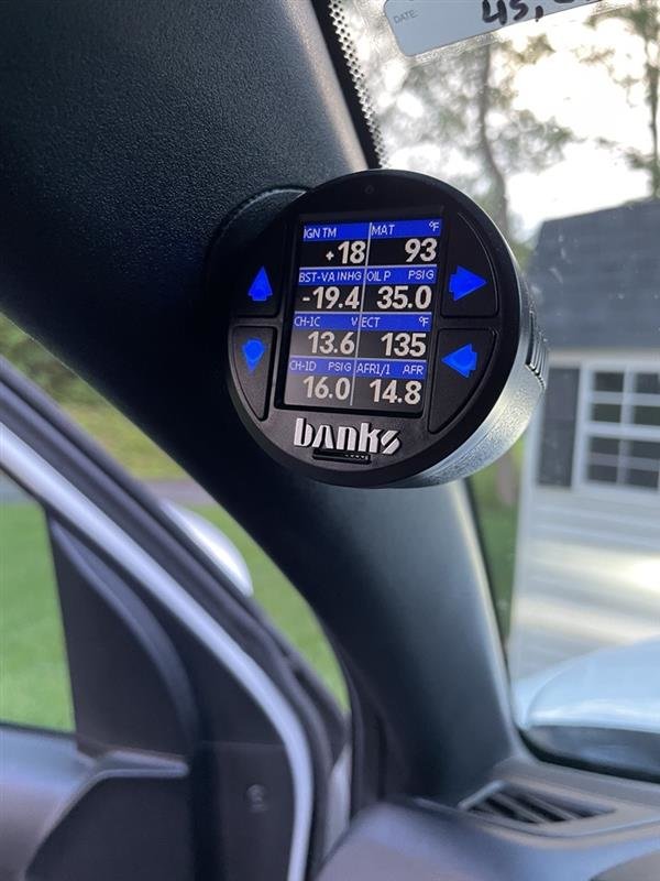

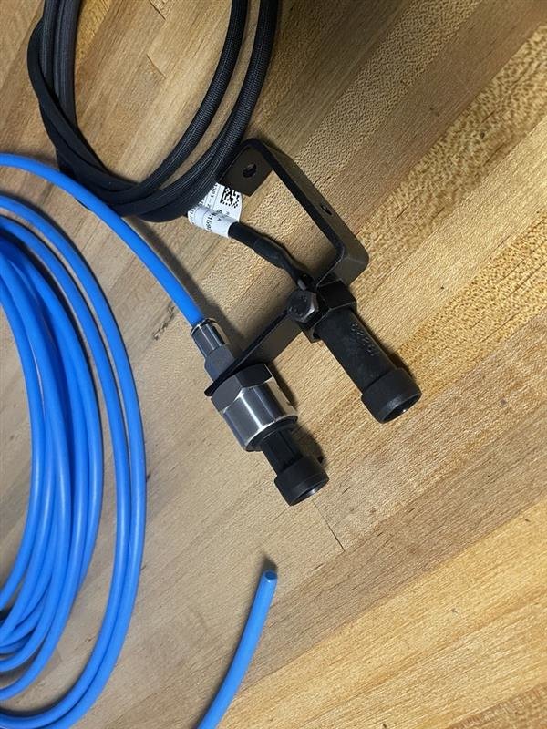

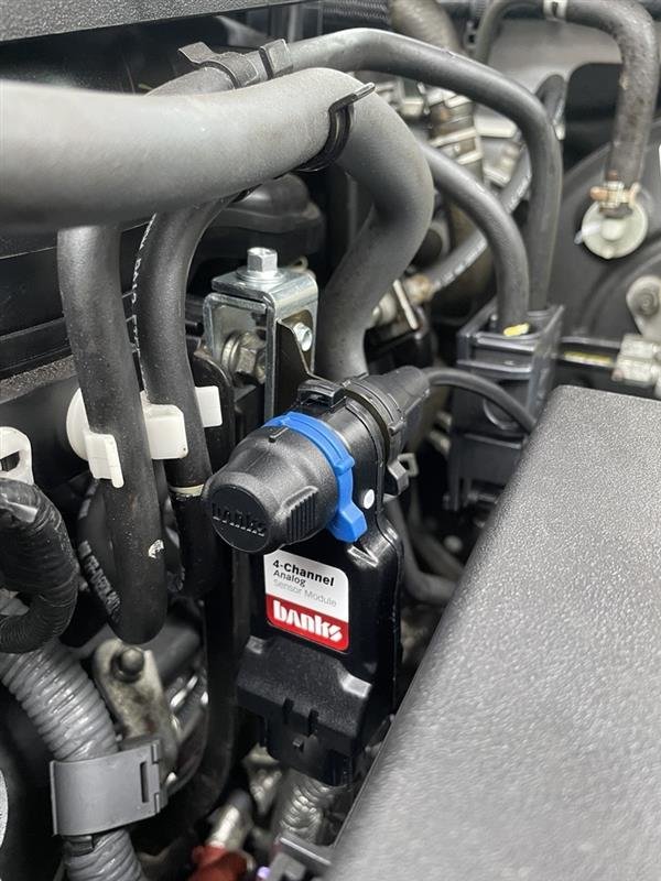

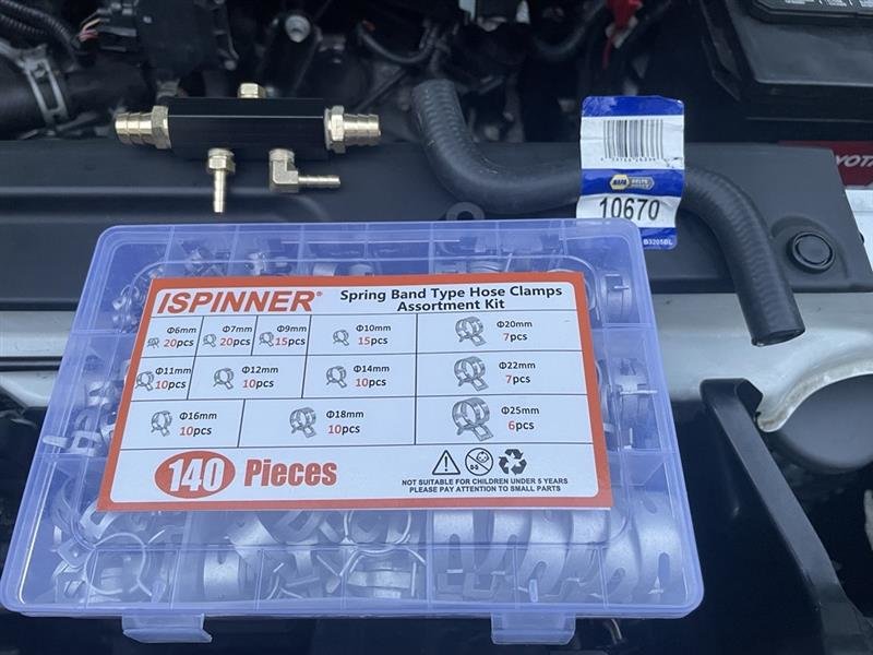

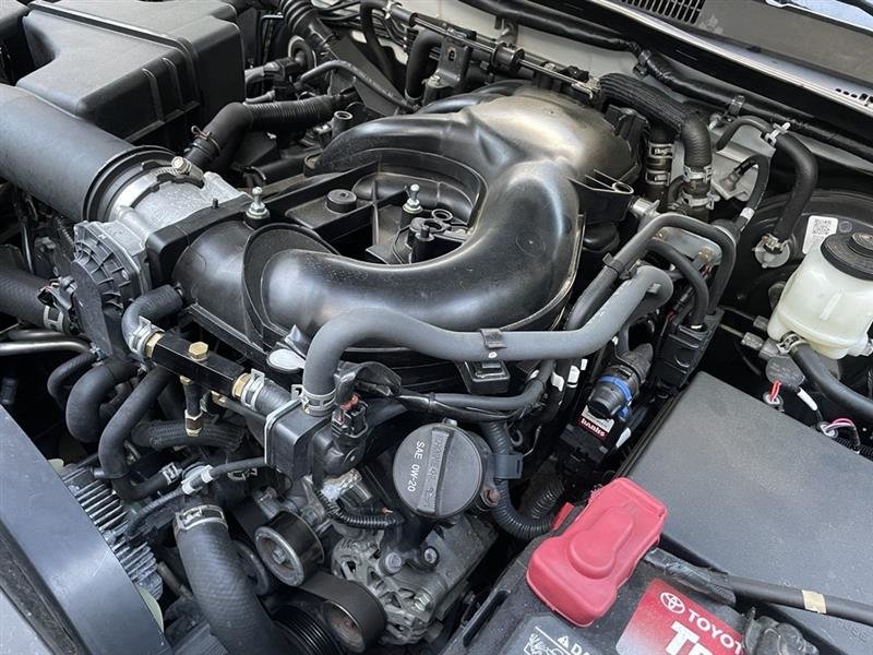

    1 year and 12k miles on the new motor. No issues. The dealer has been ordering every missing/broken OEM screw, clip, shield, etc. that I find without question. They agreed to perform oil changes after the first 1k miles and every 5k for the remainder of the 45k service contract. I'll be scheduling the final service at the end of the month.
    I installed the Banks iDash with an oil pressure and MAP sensor shortly after receiving the truck back. The fuel pump voltage booster and hobbs pressure switch from the Procharger kit are installed and monitored. The Banks analog module is 4 channel, so I also added a pressure gauge to monitor the leaf spring airbags. I'll post pics at some point.
    Next up.. Relocating the battery to the bed. I always confirm the electronics before adding boost.
    I don't like Procharger's battery relocation solution for tacos with passenger side ABS modules. They provided pos and neg 4 AWG cables (6 ft) that bolt directly to the factory BAT cables. I'll then have to delete the factory washer fluid reservoir and the airbox CAI diverter.. No thank you.
