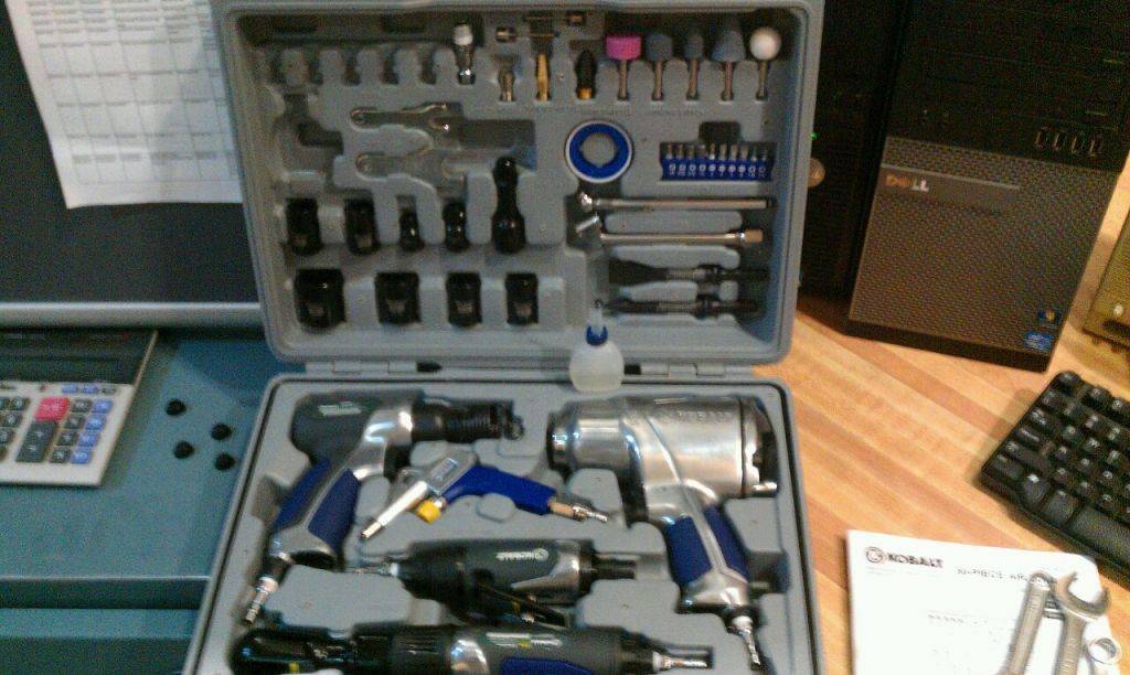

    I think the pencil tip is what is in the lower right hand corner, and yeah, I'll have some hearing protection handy for sure.

    i used BFH and a 3/8 center punch... :( that wasn't fun

    I used the angle grinder & drill method.
    Shitty job no matter what tools you use. :(

    I have done 2 now. And I have to say, grinding the rivets flat, drilling into them about a 1/4" with a 1/2" bit, then beating them with the BFH is the best way to get the ones out that are vertical. As for the ones that are also holding the rear crossmember, I found those easiest to grind flat and drill all the way through....:rolleyes: like Craig said, they are a bitch regardless of what method you use....

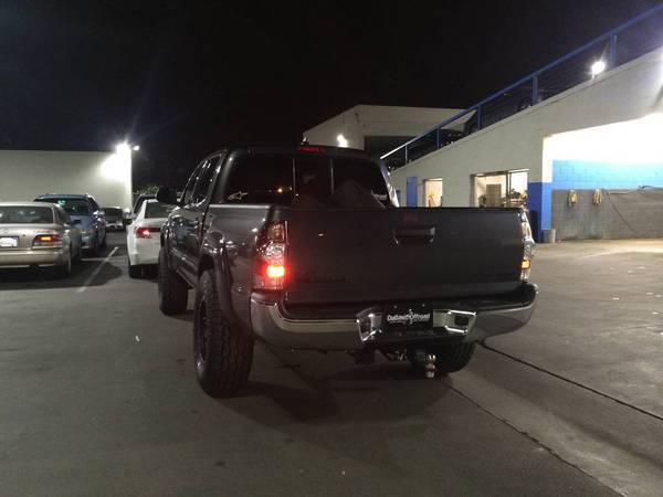

    I checked your build and it looks like your model is different than the one I have. you only have one hole for shackle adjustment right?

    Yes expos are typically going to be in the farthest hole set.
