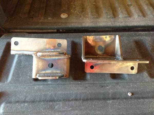

    So how much uptravel is lost by doing the shackle flip?

    Fog light mod, interior LED's, illuminated switch, B110 5100's in the rear, Satoshi Grill, Hella 500's, 4X Innovations sliders, rear diff breather mod, painted rocker panels, bhlm, yellow wire mod, CB, Wheeler's 2"aal, Allpro diff skid, ubolt flip, LR UCA's, 885X's w/ 13mm spacer on 5100's, Spydertrax spacers, Relentless IFS/ mid/ T case skids, 255/85/16 KM2s, block heater, DTRL mod, T2 eyelids, Wheelers Superbumps, Extended SS brake lines, ATO shackle flip kit,1" 4Crawler BL, Elite fr plate bumper, Flyzeye LEDs, Drilled and slotted rotors, 20" LED bar
    Yeah... Beef indeed, but had to return one of mine ...:-(

    Just one? Cause?
    Mfg defect. The holes were simply drilled in the wrong location on the one. Adam caught it before I even opened the box. Its on the way back to his shop for a quick fix though.:cool:

    Would the shock relocation really effect the shackle flip?

    Yes, factory stock location, youll have a shock that bottoms out before the bumps do which is bad for your shock

    not exactly but with my expo springs at full droop im almost at full extension with my 10in icon shocks but 12in shocks are alittle to long without the relocating the shock up further allow to run a longer shock with greater up/down travel....so i have a decent setup now but will revamp shocks,shackles and mounts all at once for a big improvement at one time done right and ato is top quality parts :)
