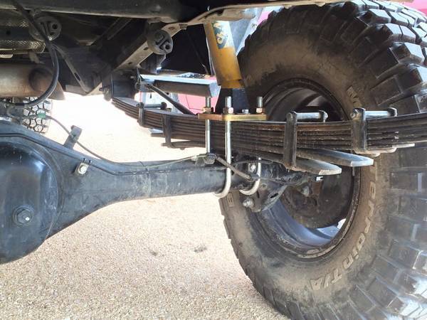

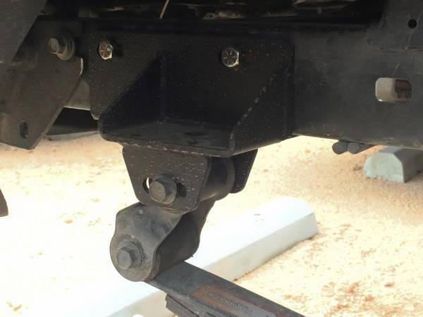

    Busted CV boots and lots of squeaks.
    yeah. The mounts on the bottom for the spring attachment are angled in a little.
    you can kind of see it on the left one here.

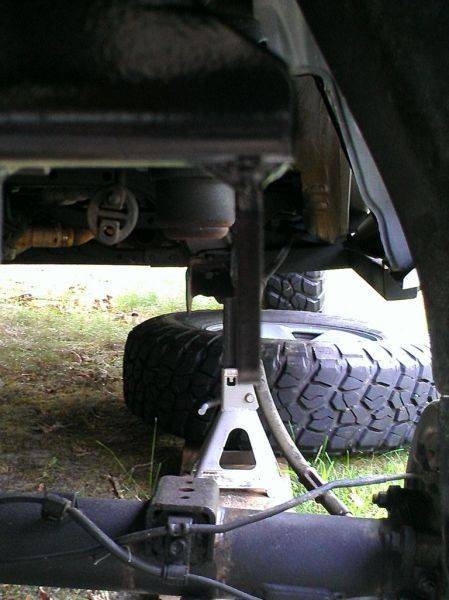

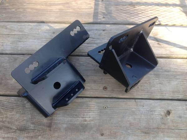

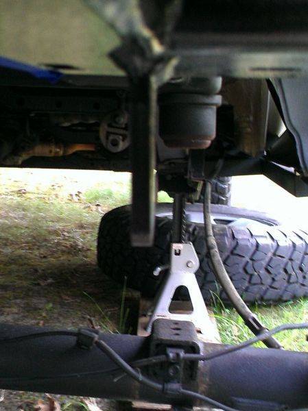

    I just mocked mine up tonight. They look strait on.
    Left pass side lined right up with the front hanger
    Right pass side lined right up with the front hanger
    Waiting for paint to dry now before I install them, but before I do Ill run two string-lines and measure to see if I need to adjust the angle at all. They eye up great so I think this side is spot on. Worst case I shim 2 bolts out to get it perfect.
    I did the same but with a cut off wheel.
    Cut off both sides.
    ground bottom rivets flush.
    Ran a 1/4" drill bit right up the center of the riven about 1/4" deep so my punch wouldn't jump around.
    Inserted punch into hole and held with vise grips.
    Pounded the bottoms out with a sledge.
    Drilled out holes to fit new bolts.
    Once the bottoms were loose I pounded the shackle hanger away from the frame and the top came loose immediately.
    Ground those down flush, drilled, punched through, drilled to fit new bolts.
    About 30 minutes total for the pass side tonight.
    Only tools used besides a C clamp, 11/16" drill bit, and tube of tooling wax for the bits:
    The bottom rivets wanted to take the rear spare tire supports with them so I had to c clamp them down before hitting them out.
    :notsure:
    Rivets could of been hotter and pressed in more on your production run :confused:
