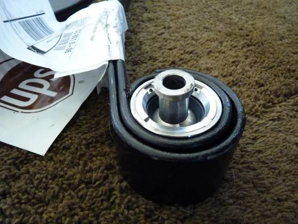

    i didnt know creeper was a brand. I am just saying something that will keep the joint from binding. How ever you want to do that is ok by me. what about something from the spring side like an orbit eye type thing?

    Yes creeper is a brand, the joint is called a uniball. They just don't fit in the shackles/shackle flip. You might be able to go in the springs like that, IDK. I've never measured for that. It is not recommended to do uniballs in both the shackle and the spring as that allows the whole shackle/spring to flex side to side. That would cause instability in the truck. In reality they do not do a whole lot for flex anyway, the shackle flip itself is a much bigger gain.
