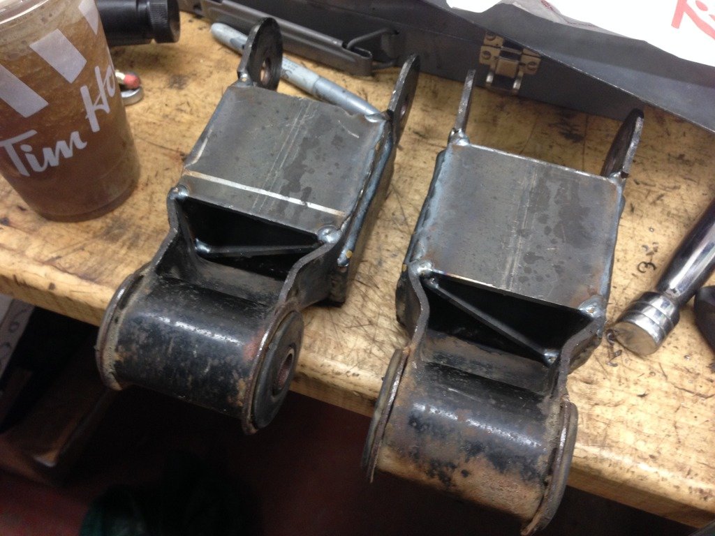

    Quick question for you guys. Ok so I got my shackle flip installed and want to extend the factory shackles 3.25" so total eye to eye will be 6.5" I'm doing this by cutting the existing ones, extending the tabs then welding them/boxing them in to prevent side flex.
    Should I be thinking about adding a panhard bar at this point or will I be ok with this length shackle? Springs are OME Dakar with and the front is a BDS 6" lift. The ass end is sagging a bit lower than the front hence the need for longer shackles. I will not be running spacers in the rear and will avoid it at all cost.

    Stock shackles are too flimsy to extend them that far. I think you'd be better off making or have someone make you new ones with thicker steel to support your truck

    But is the 3" longer part ok. The flimsy part I'm not worried about as they're getting doubled over

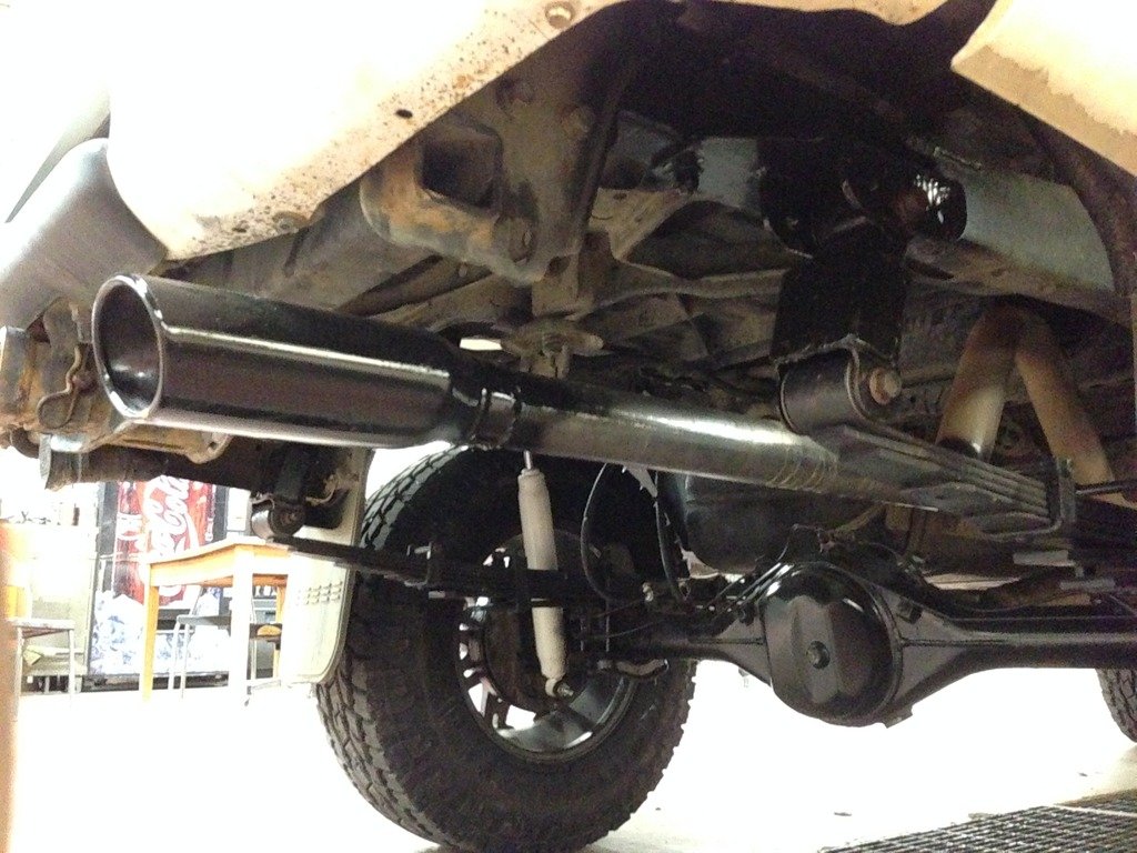

    Done! I dont think she's going anywhere :D

    Nice work

    Thanks! It took a bit of figuring out as to what height to extend them to. I didn't feel comfortable with anything more than 3" or 6.5" total.
    I did not want the ride to be all wonky. Been on the road for two days since the lift and it rides great so far.
